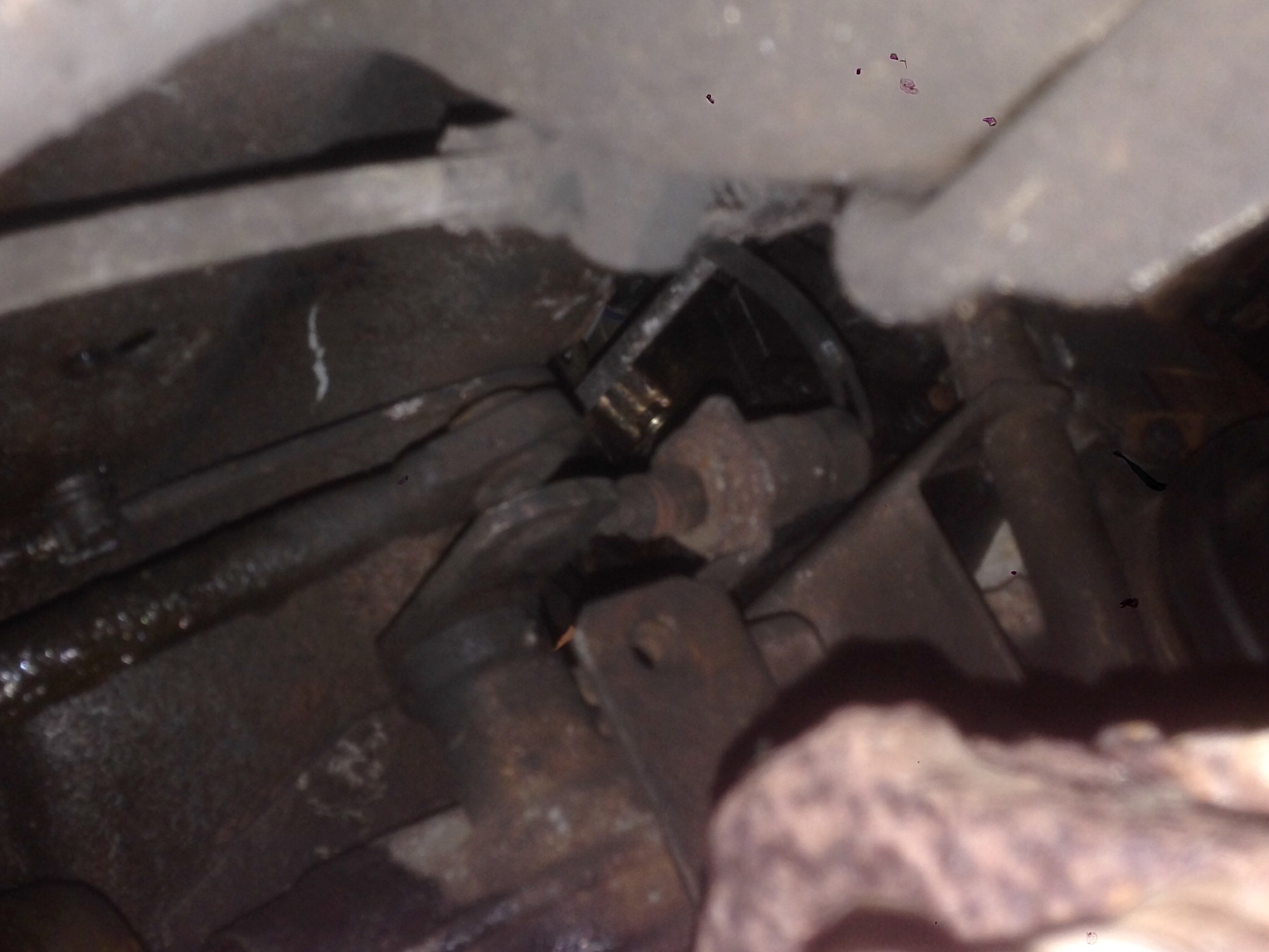

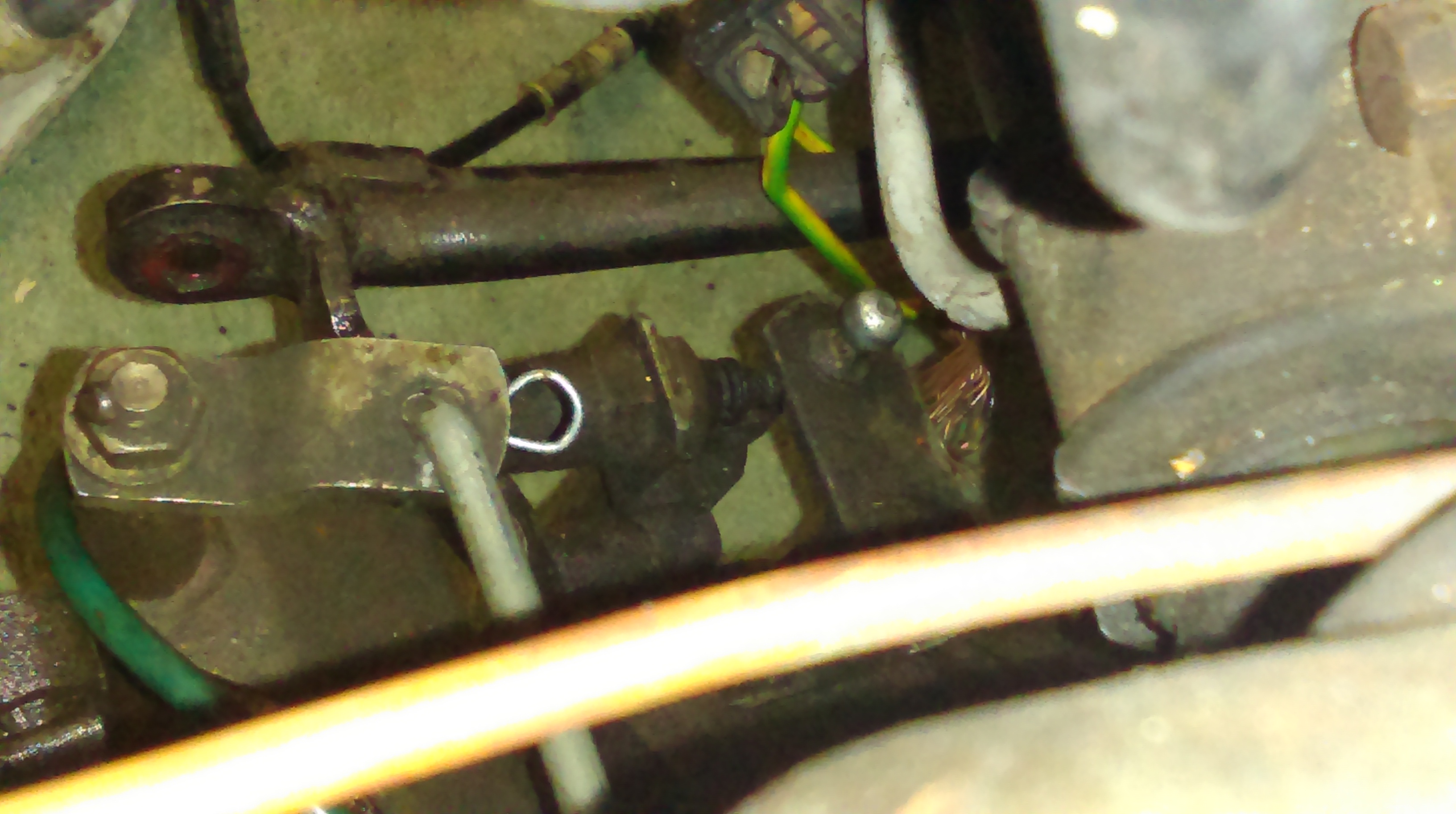

Hi
I have looked everywhere for this switch looked from the top been underneath and can fine no plunger switch or wiring.
Does anyone have a photo of the location please.is it possible it's been removed maybe and a bolt put in its place ?????

Hi there
Without appearing to be an idiot where is the photo taken from the top looking down with the spare wheel removed or from underneath ?
Thank you so much for your help by the way.
Regards

Hi
Many thank for everyone's help on this
Here's a photo from underneath if that helps. Look for the bit with the wire coming out.
