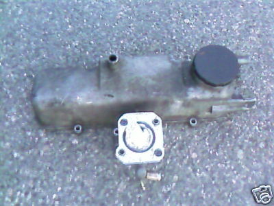

Hi Chris, The 899 rocker cover has got an ali. spacer bolted onto it then there is a 3mm steel plate on top of that then the throttle body. You could get the spacer and plate bored out to 32mm to match the TB.

I looked at the 899 engine which I have and the spacer and metal plate are 30.3mm dia.

Rocker cover with ali. spacer

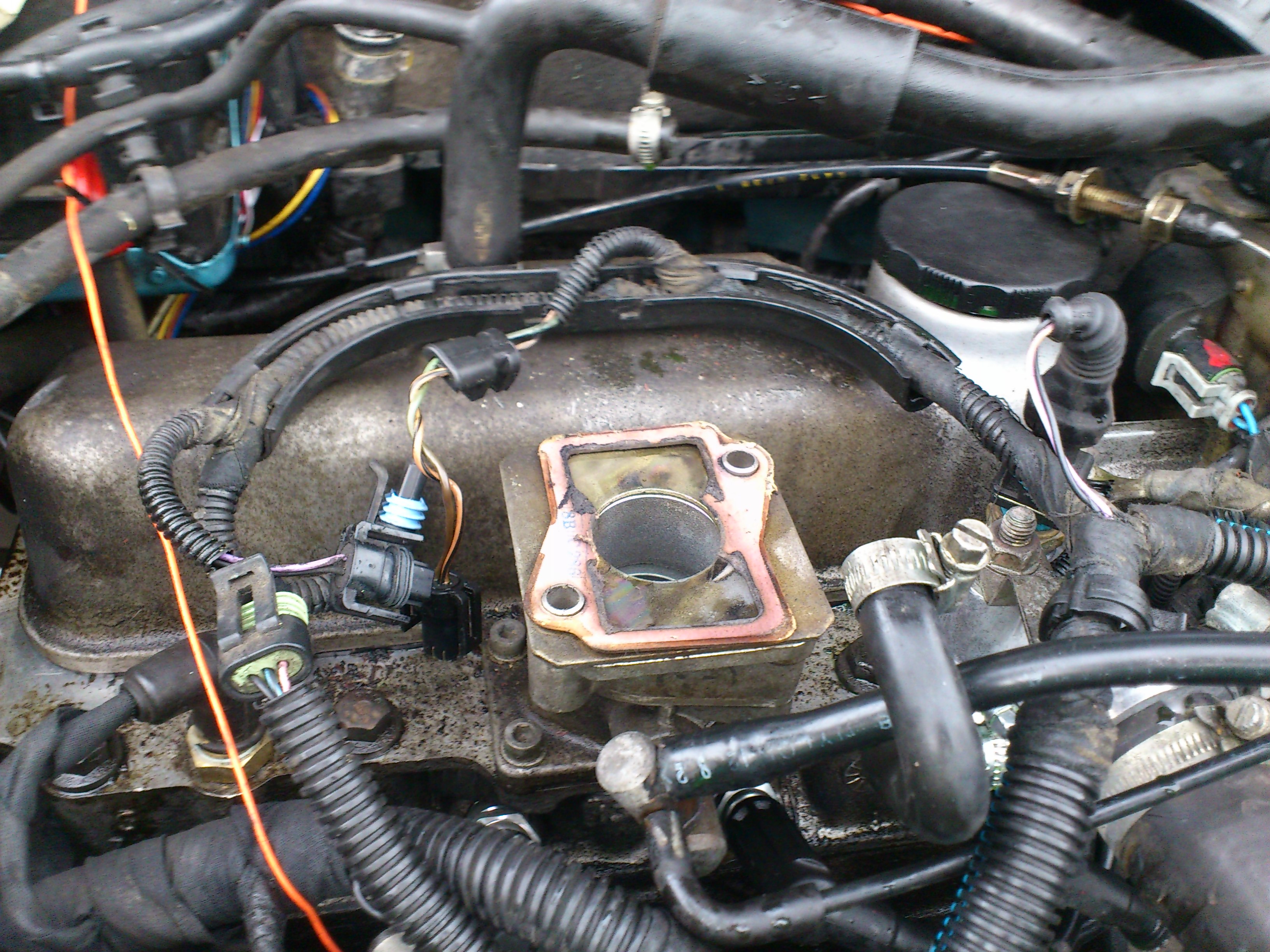

To continue on other work i have done since i last posted. I took the metal plate that sits between the spacer and body and filed it down so it was the same size as the original spacer, which is 30.3mm as sparky 5 has pointed out (pm sent btw :) )
Took it out for another spin and the power gain are very noticable now, i find accelaration a lot quicker, the torque band has moved a little but i havnt lost any yet. Power at the top end is has improved a little, but between 3 and 5k the has certainly been a boost!

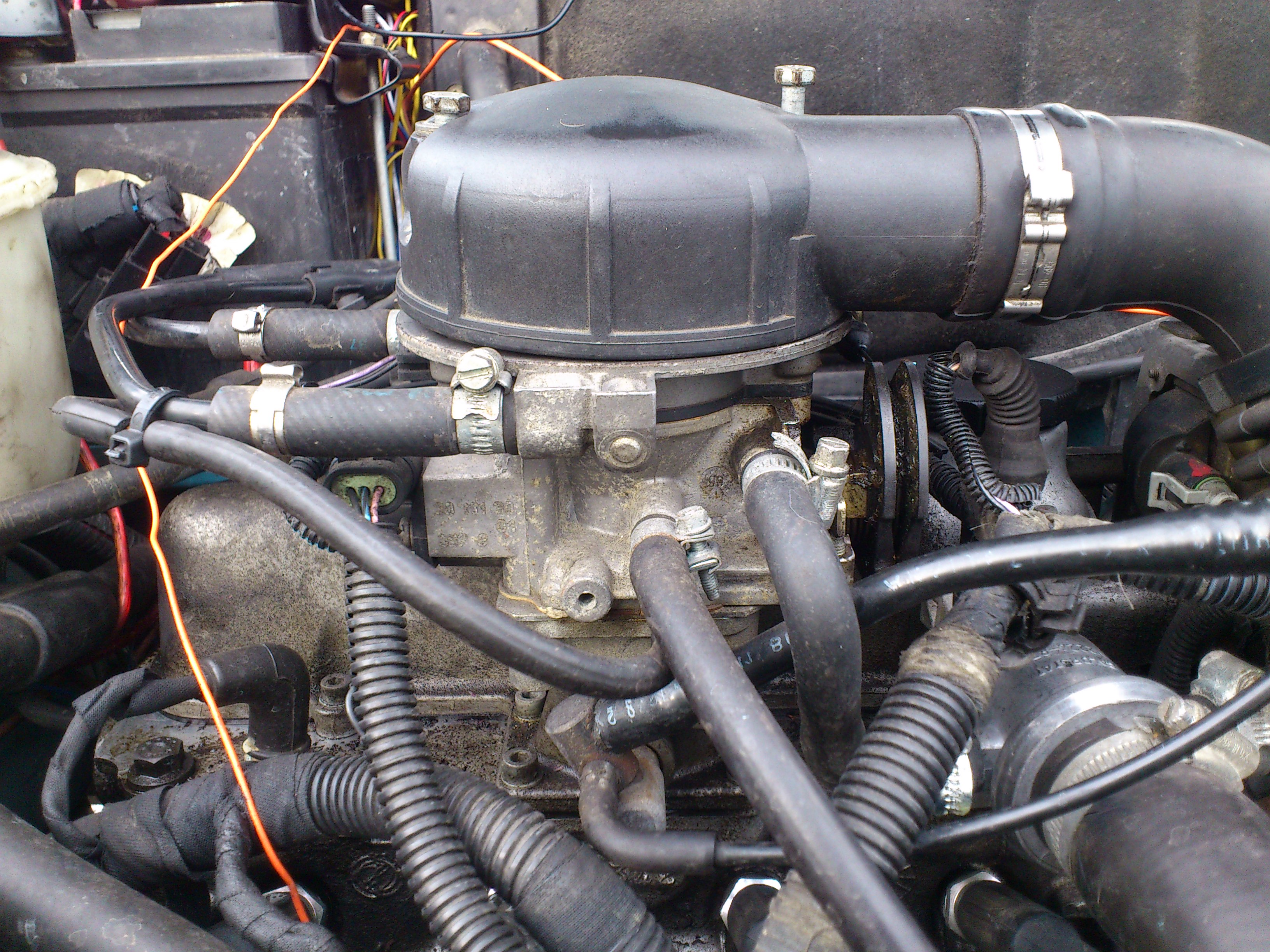

Here are some photos i took:
Before everything was taken apart
New 32mm on the left and 30mm of the right, you can see quite a difference!

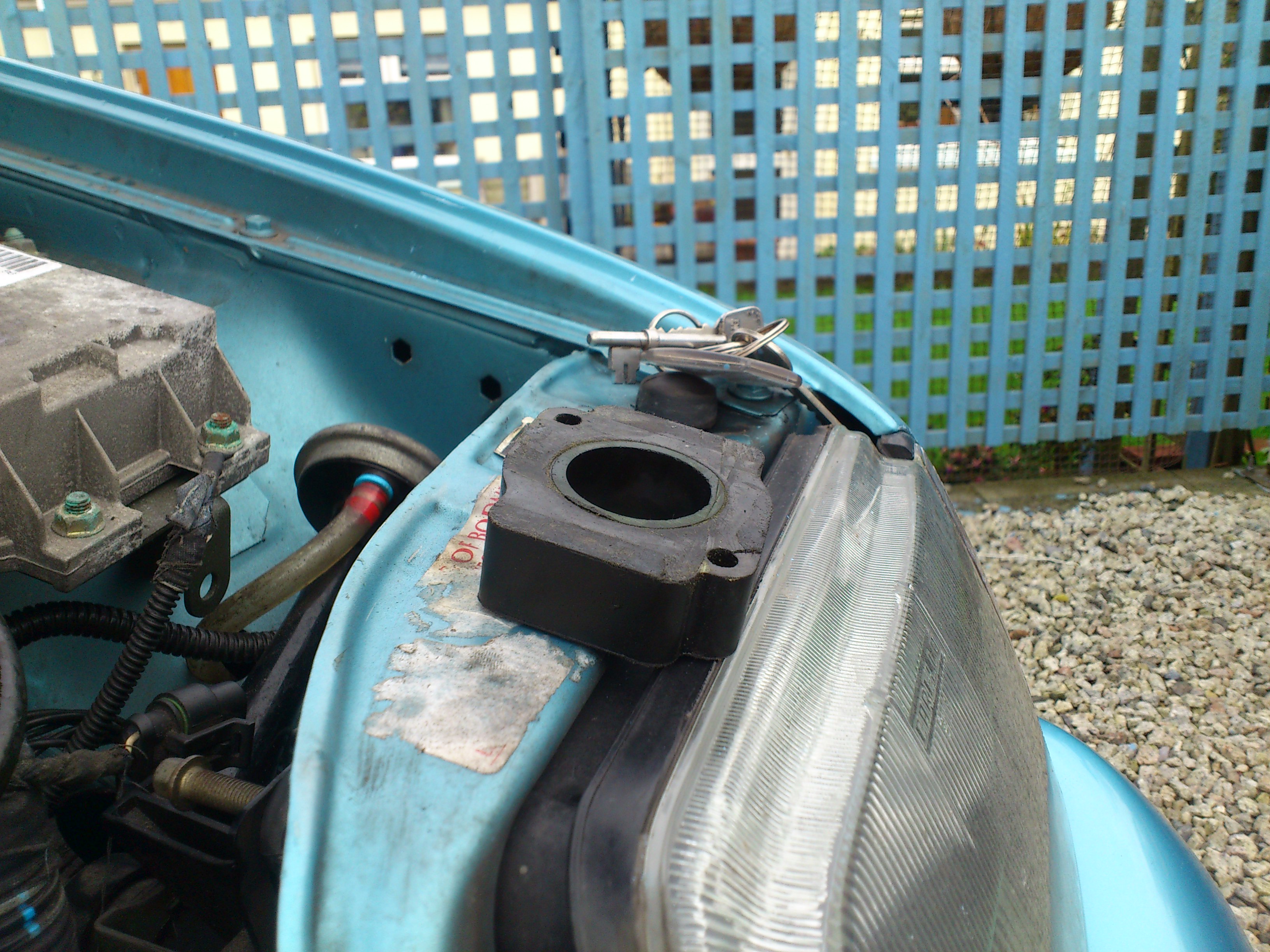

This is the metal plate i mentiond that sits on top of the spacer, i have filed down the inside to match the spacer size now
The original spacer that came with the 32mm tb
Very soon i hope to get the spacer and plate properly bored out to achieve the tb maximum potential!
