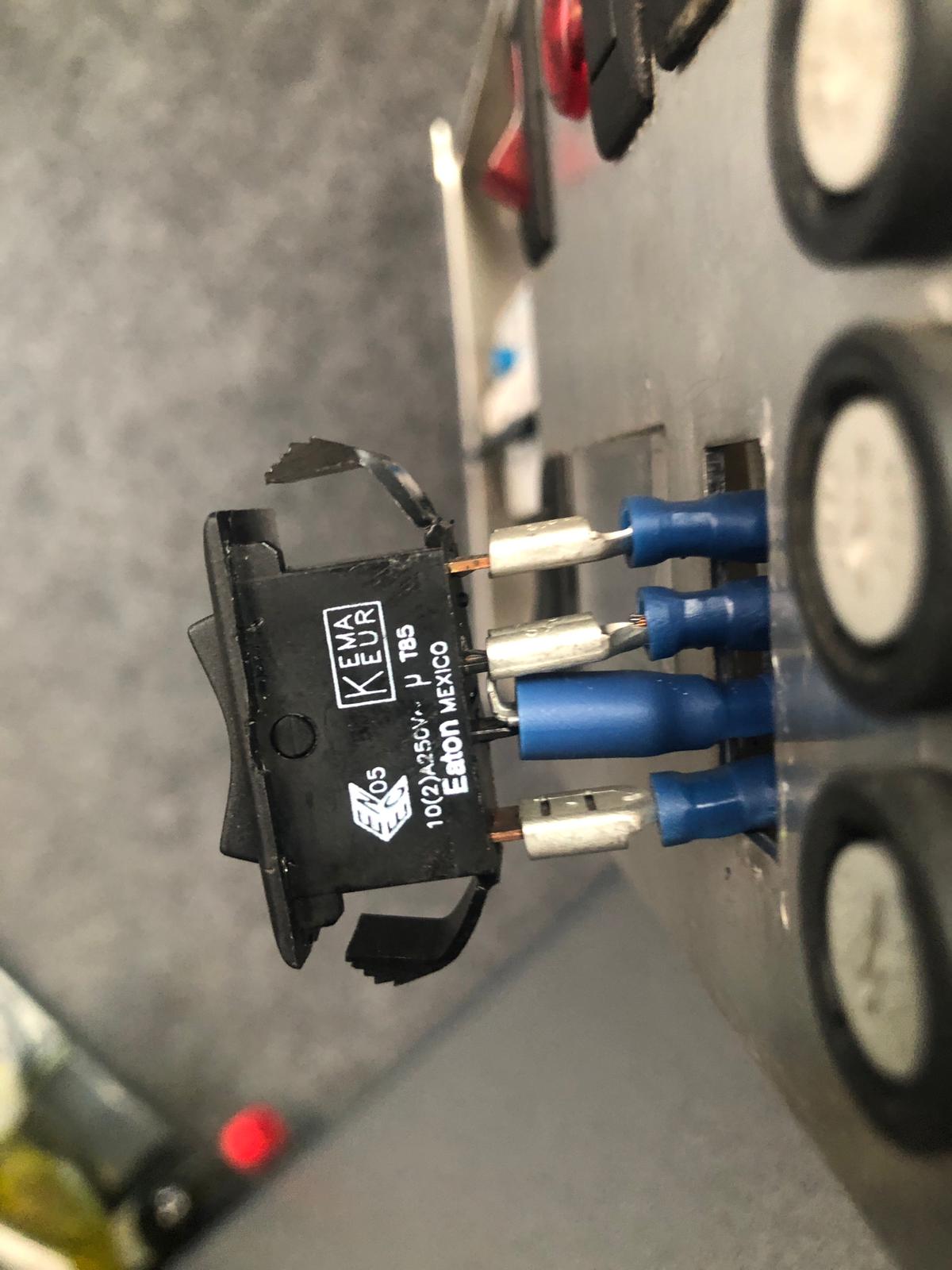

The part I am looking for is the battery selector switch (picture "Battery Selector Switch") that is responsible to switch between the 3 options AUX / OFF / VEH. This part is faulty as I might have fried it, hence it needs replacing.
It has 4 prongs at the end which to me seems to be very rare, given the difficulties I faced in locating a new one.

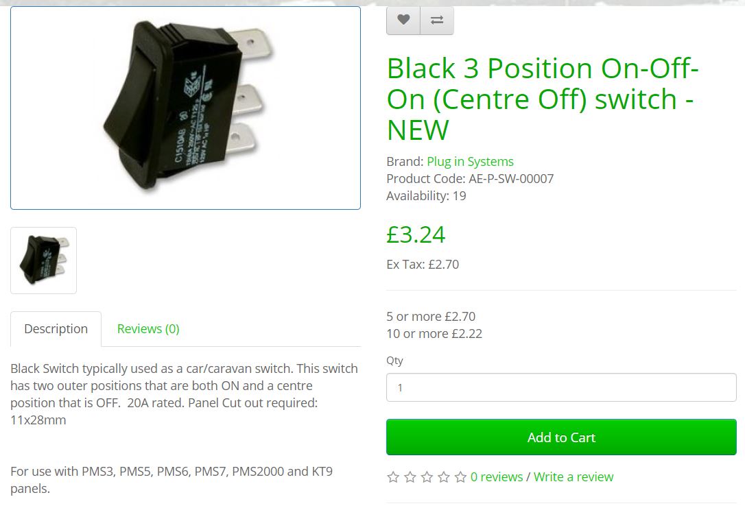

If I can’t get this 4 prong switch anywhere, is it possible to use a 3 prong one? (Picture "Battery Switch 3 Prong") In the description of the website selling the 3 prong it says for PMS3 but again, can I use this without problems?

If I look at the picture you have posted then the central two switch tabs are already connected together by a "piggy back / dual tab" lucas blade connector that that is directly linking/shorting the two middle/central wires together.
If this is the case then a standard single pole / 3 way switch (ON1/OFF/ON2) will be perfectly OK subject to current and voltage rating.
