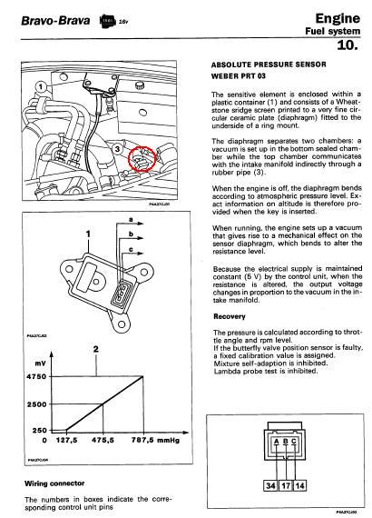

1.6 doest have a MAF.
there is a MAP.
the sensor you cleaned in the air temp sensor. you can test this easily using a multimeter (search for the thread if you're interested, there's a graph showing expected resistance at different temps)
you can't clean the MAP, nor should you ever need to. however its a good idea to check that the vacuum hose is not damaged, blocked or leaking.
