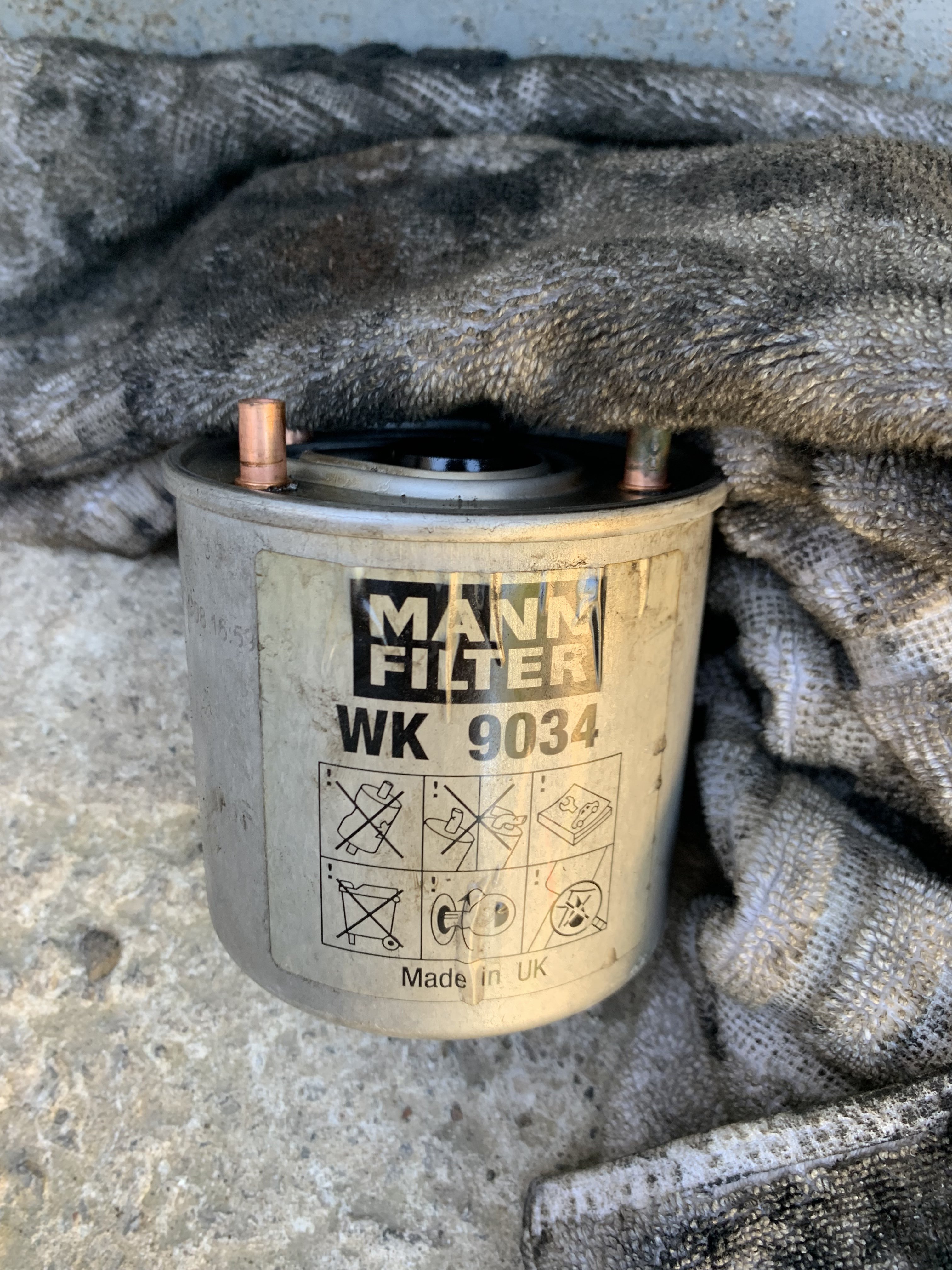

Ive found it and its not same as i thought, anyhow going getting filter wk 9034

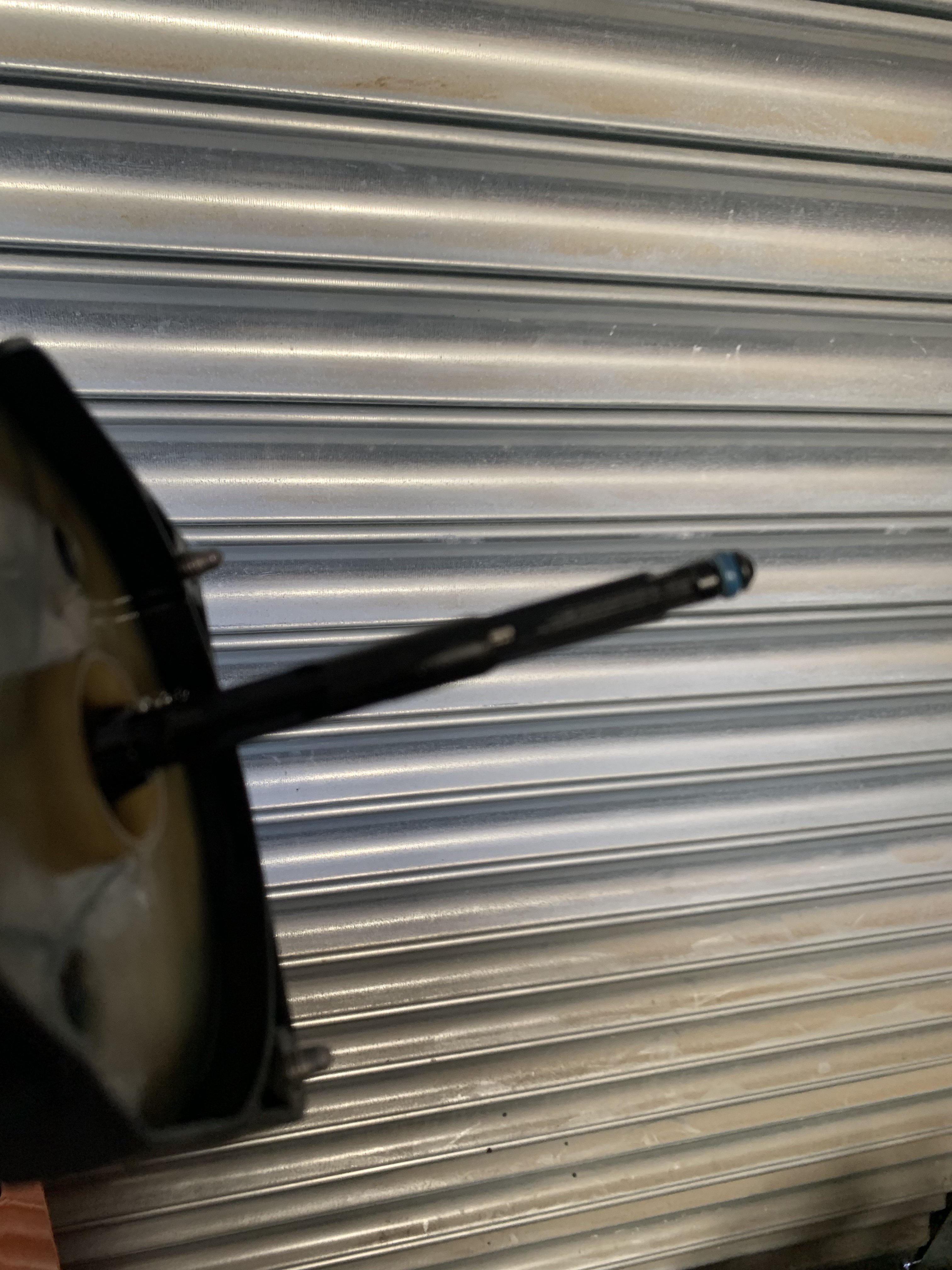

How do i test the sensor with muktimeter please to see if that is defunct? Thxs
Sensor only has 1 prong

I now have new bosch filter primed and back in place but i want to test the sensor assuming its the one prong sensor that detects for water and gave me the warning on the dash "water detected in fuel filter", any advice please?
Depends on the sensor, most are just float switches, some might detect water, if just one wire then probably a float switch
My question is how do i test a single prong sensor? Red multi meter lead on prong, wheres does black go?
Body of the filter housing, which would be earthed to the vehicle body.
But do you know what reading to expect? If not, no point in testing. It might be checking the resistance on the fuel. If a float switch, turning it upside down might change the reading.
Why assume the sensor is at fault. If it says water in the filter, there was probably water in the filter.
