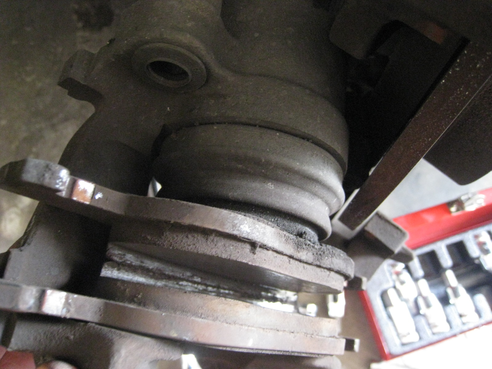

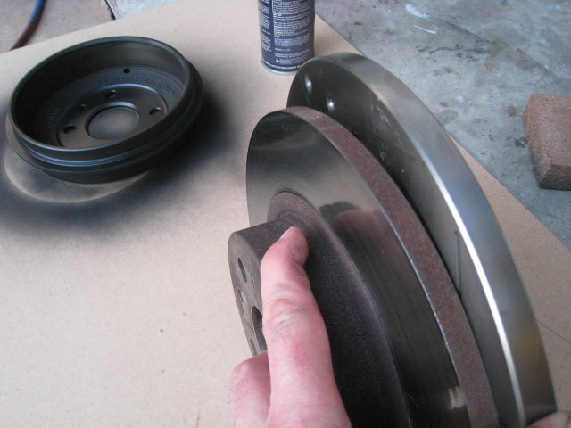

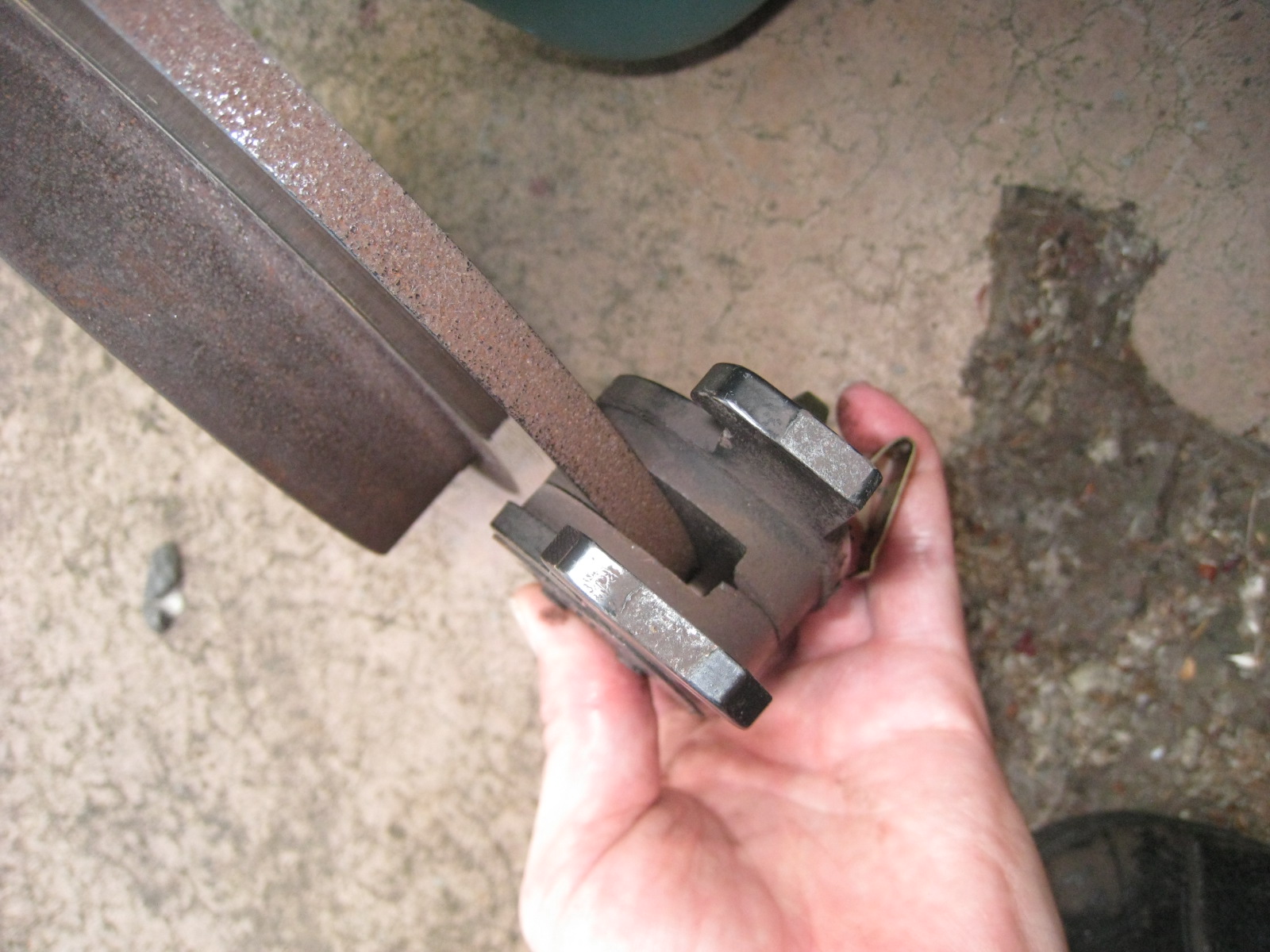

My similar story to yours... my yellow Punto cost the previous lady owner a fair sum; among other things, front brakes had discs and pads replaced. When I bought the car, I did a quick wheels-off inspection - noticed the discs were shiny right out to the edges, didn't think too much about it (presumed the pads were a precise fit). Pads had plenty of thickness visible on the inside (didn't check the outside, as the caliper was in the way.)
About a year later, I noticed the brakes were feeling less and less effective. The pedal was firm, but it felt like most of the braking was happening at the rear. Then the rear brakes started to 'creak' in certain situations. I shone a torch in the front wheels; still plenty of pad thickness left. I was puzzled.

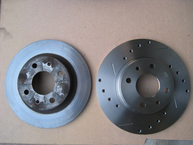

Rear brake shoes were completely worn out. I decided to fit new discs and pads to the front as well, to be on the safe side - and what I found horrified me.
I think the pictures below shows what was happening.
The garage had fitted Uno-size discs (drum roll... on-topic for this forum ;)) rather than the correct Sporting discs, which are larger. They had, however, fitted Sporting pads. The pads wore until the outer edges were touching each other - at that point, the pedal became firm, but the pads were not clamping the disc! How dangerous! :cry:
