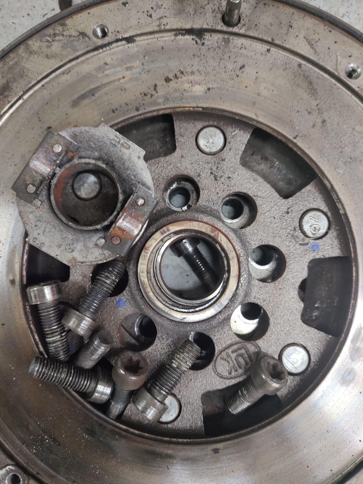

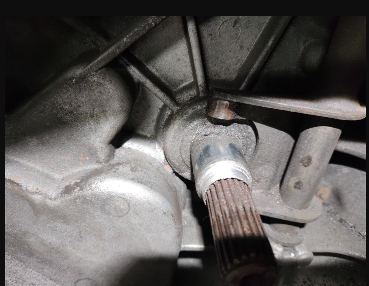

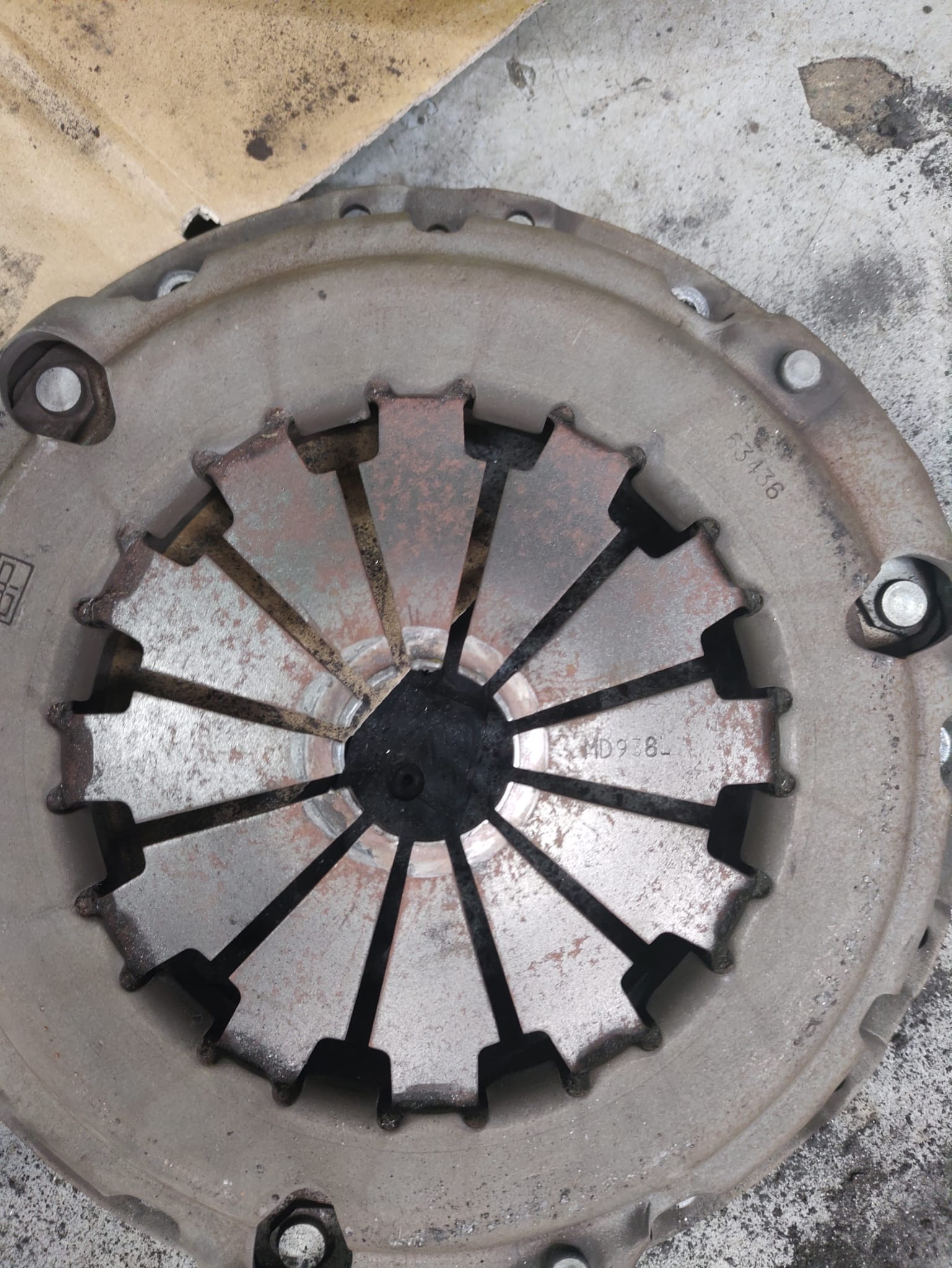

Here's some pics of the broken one... Note the damage around the gearbox primary shaft casting, a little more than cosmetic but it all went back together ok and damage subsequently attributed to "weight reduction or light weighting"!! Also eccentricity of the failed DMF plus this looks like it was a LUC kit (the first replacement) it's now on it's second...
