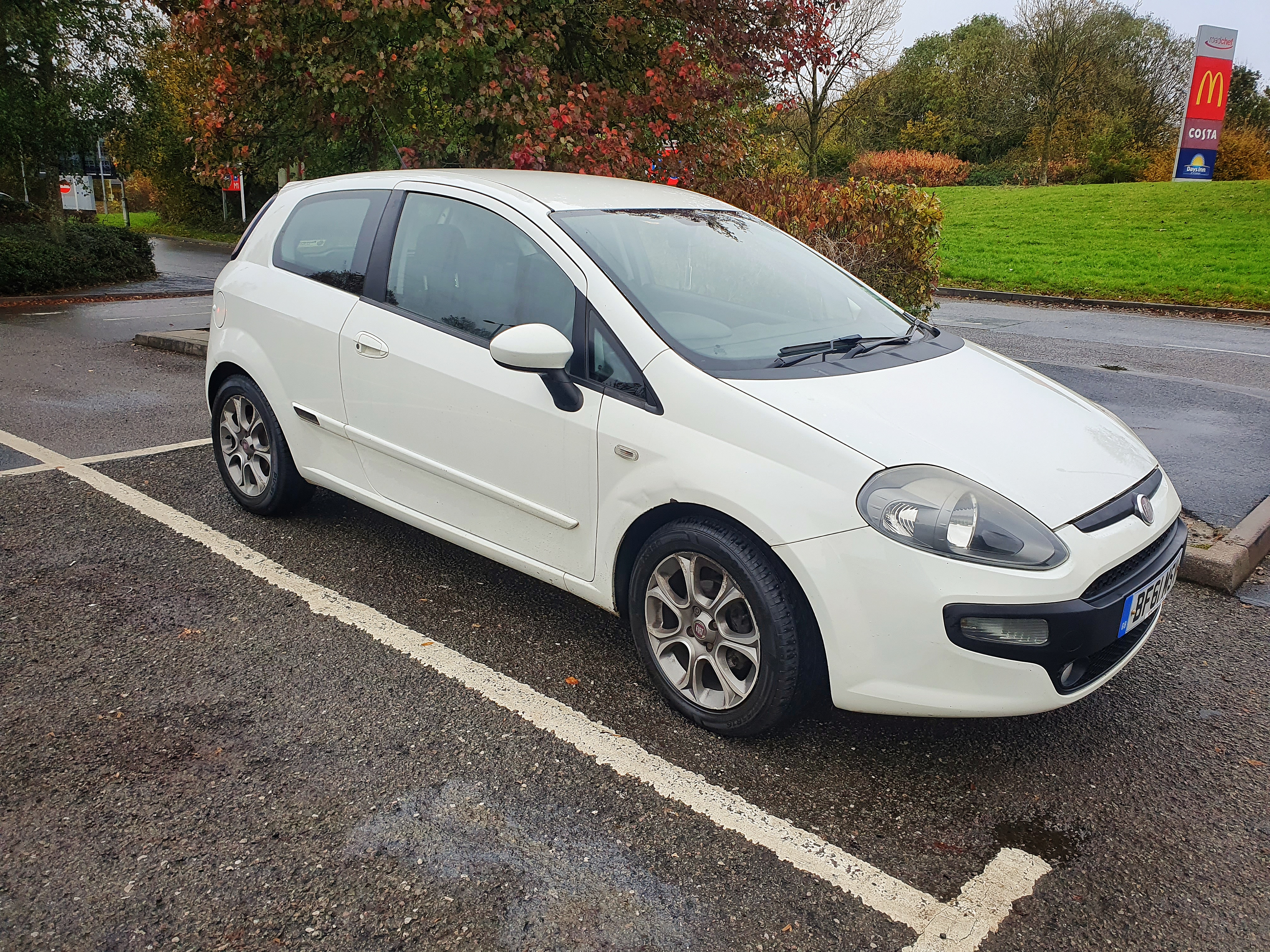

Punto Evo 2011 Fiat Punto Evo 1.4 8v
A recent purchase after making the decision to downsize from my usual choice of estate or saloon cars. Fun to drive but not without its share of niggles!
I purchased this car back in November 2023. I had decided to downsize on my daily driver and my fleet of cars (in varying states of working or broken).
I did own a 59 reg Grande Punto a couple of years ago, just as a runabout, and I quite liked how simple it was to work on, but the fact it was still fun to drive.
White definitely suits the Punto, however it seems to be suffering from lacquer peel a fair bit which is unfortunate.
It is certainly well travelled for one of these, having done over 145,000 miles. It has had a few issues since I've owned it, but nothing serious. Still one or two bits to clear up, but you know what it is like... the work is never done!
