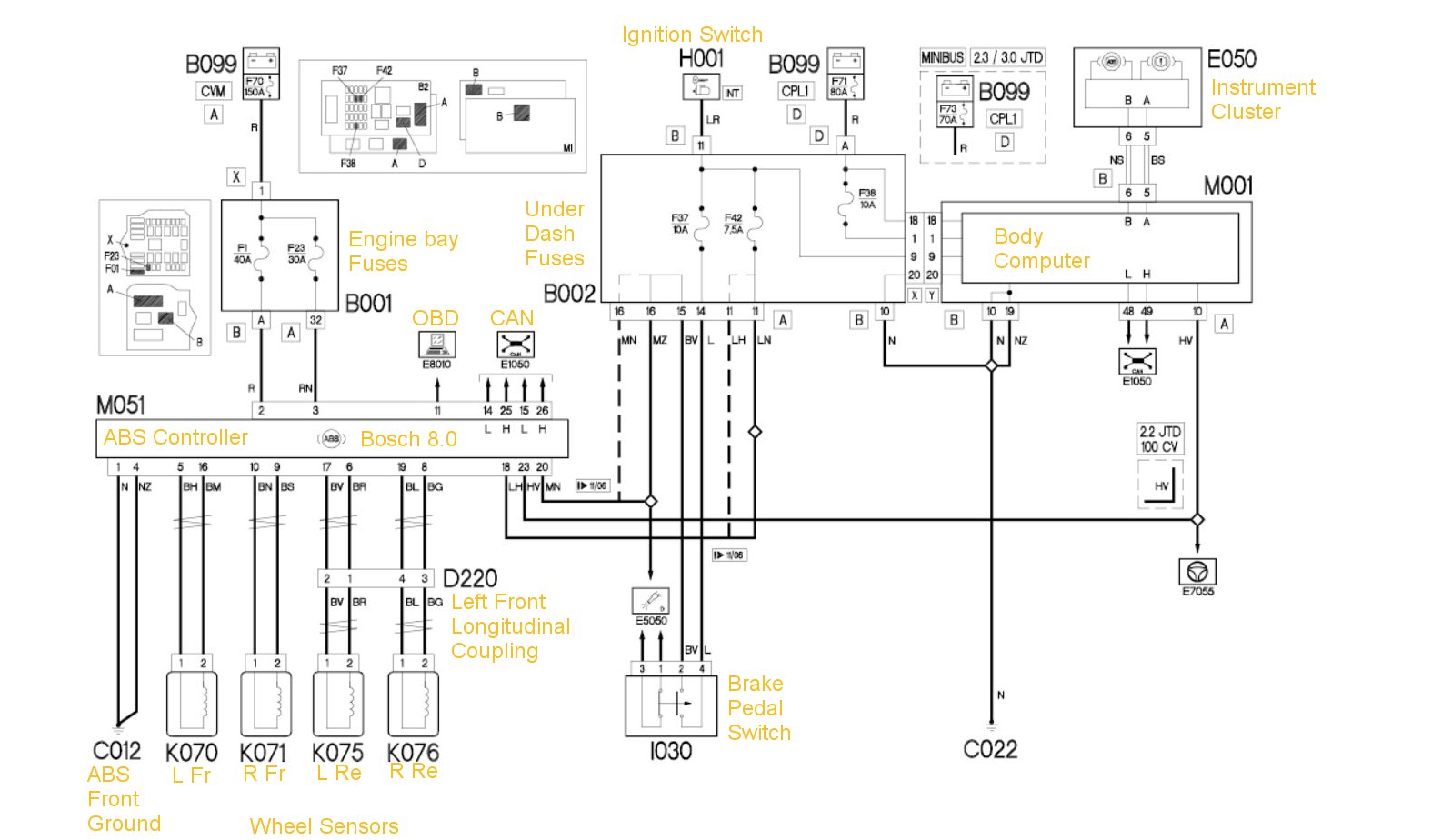

The only information I have on ABS is from eLearn, see extracts attached. The wheel speed sensors are passive (inductive) types, which produce a regular AC waveform of increasing frequency and amplitude as the wheel speed increases. I don't know their resistance, but would expect to measure something other than an open circuit or a dead short.

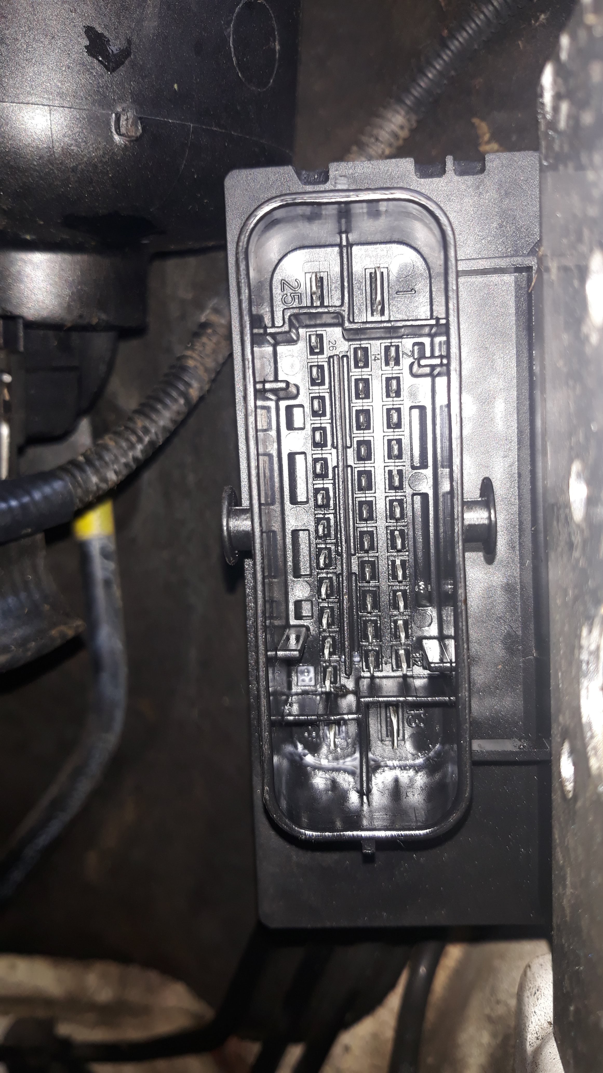

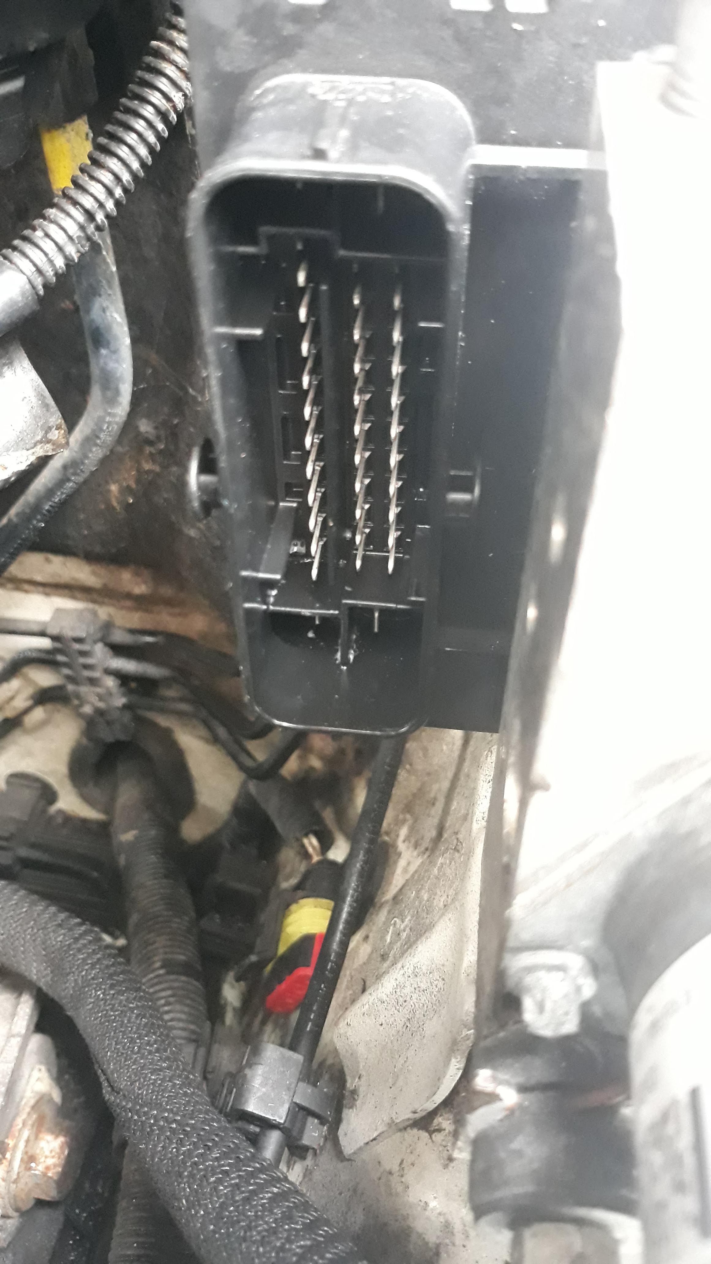

I think my ABS module is a different type though, as it has a lot more terminals than the one shown in the diagram. See pics attached

Think I've resolved this with the help of Anthony's wiring diagrams. I checked the fuses for the CAN circuit to find that fuse 42 had indeed blown, so I replaced the fuse and everything is now ok.
I suspect a breakdown in one of the CAN wires had created some arcing to blow the fuse, so I doubt this is the end of it......
Will update the thread if/when the drama resumes.
Hi
Fuse F42 is listed as supplying ABS, ESR and ESP functions, plus indirectly the half of the brake pedal switch that goes open circuit when you brake to tell the various functions that braking is in process. The other half of this switch deals independently with the brake lights.
I attach an additional schematic that shows that F42 also supplies Module M091 (Slewing Control Unit) and Module M092 (Steering angle control unit. It's a bit hard to see, but M091 seems to be near the cab floor and M092 up behind the dash near the steering column. The wire from F42 (LN = Dark Blue/Black) has a junction within the wiring loom (diamond symbol). From this junction there is a wire each to M091 and M092 (LG = Dark Blue/Yellow), plus a wire to the ABS unit M051 (LH = Dark Blue/Grey)
Any problem with this wiring may have resulted in a short and the blowing of Fuse F42. Also worth looking around the brake light switch wiring in case there has been a short from one half to the other.
