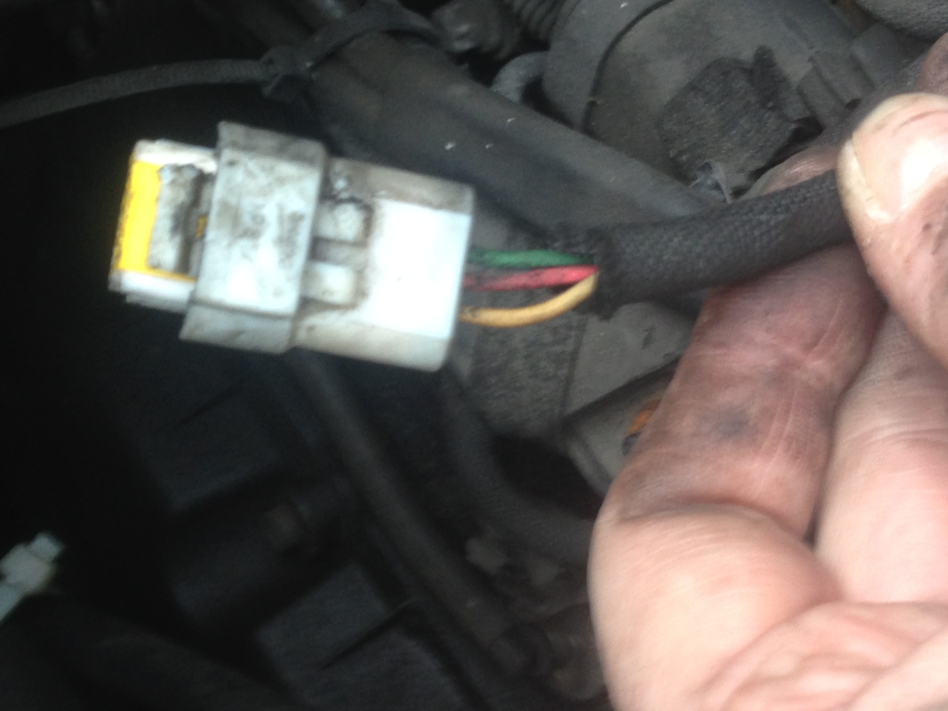

I have just had the head chenged and the person has pulled the cam sensor plug off the loom. it has 3 pins and he cant find what colour order the wires go to put them back in.
i went and got one from the scrap yard as he said it would be easier to just join the wires.
upon taking it to him today the one i picked up fits but the wires are a different colour so he still cant do it.
im desperate to get my van back as its my livley hood
Please help
I think the loom is yellow blue and white
thanks

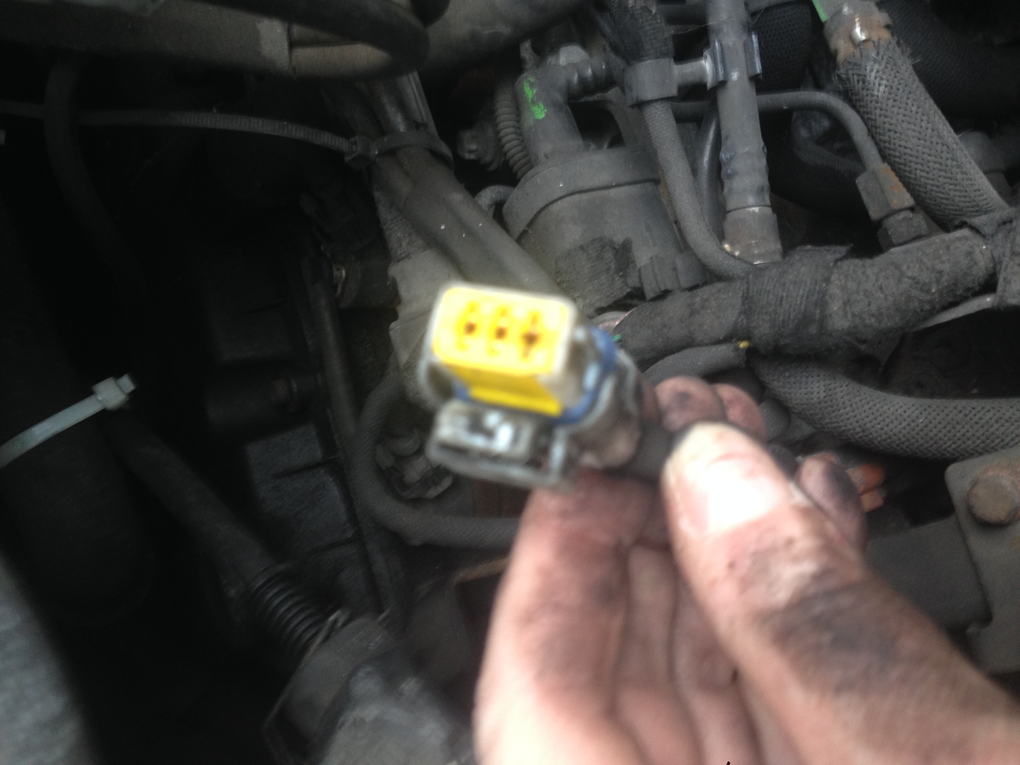

a pic of the sensor plug would be great if anyone has one, many thanks
Hope this is what you're looking for? If you click on the photo, you get a better view.
This connector is located just to the left of the filler cap on the rocker cover. The wires are different colours to what you described so if this is not right connector, describe where yours is located and I'll look again.

Thanks for the pic , that sorted that problem in a minute. many thanks
