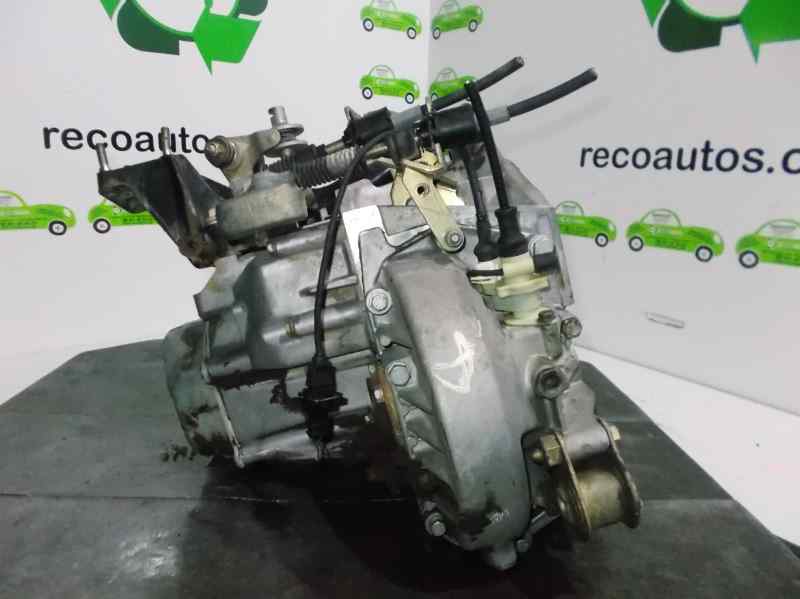

Hi, the cruise control became intermittent then packed in on my 2001 X230 2.8 JTD LAIKA motorhome. I checked the error codes using the Multieuscan and found a P0500-Vehicle speed signal error. I assume this is a fault with the vehicle speed sensor or wiring to/from.Also the speedo needle oscillates slightly. Does anyone know where the sensor is located? Pictures or diagrams will help immensely.

Hi,, I believe on the top of the gearbox (or maybe the back face) some folk remove it to fill the oil up, but there is a danger of a gear dropping into the box, I think top is most likely. That is the case on an 05, which I have, looking in the elearn manual downloaded from here, there is a line drawing showing it on the back face, just above the bolt on crossmember.Confusingly there's another showing it on the top, slightly to the rear and to the right of the reverse switch! It looks like it depends on the year, early ones maybe on the back.
Only one way to find out for sure- get underneath and get dirty....! It does sound like there is a dirty or loose contact at work with fluctuation.
It's easy enough to access from behind underneath. Held in by 8mm bolt as far as I remember. Careful removing it as the pinion can drop into the gearbox. If speedo is jumping you probably have a bad cable which in turn can damage the pinion. Sender itself may be fine.
Thank you corcai, I will have a look when the weather cools,down. If you or anyone has any pics that would be great.
Cheers.
Thanks corcai, on the second pic, which is the speed sensor? The one nearest the camera?
Thanks again for your help.
