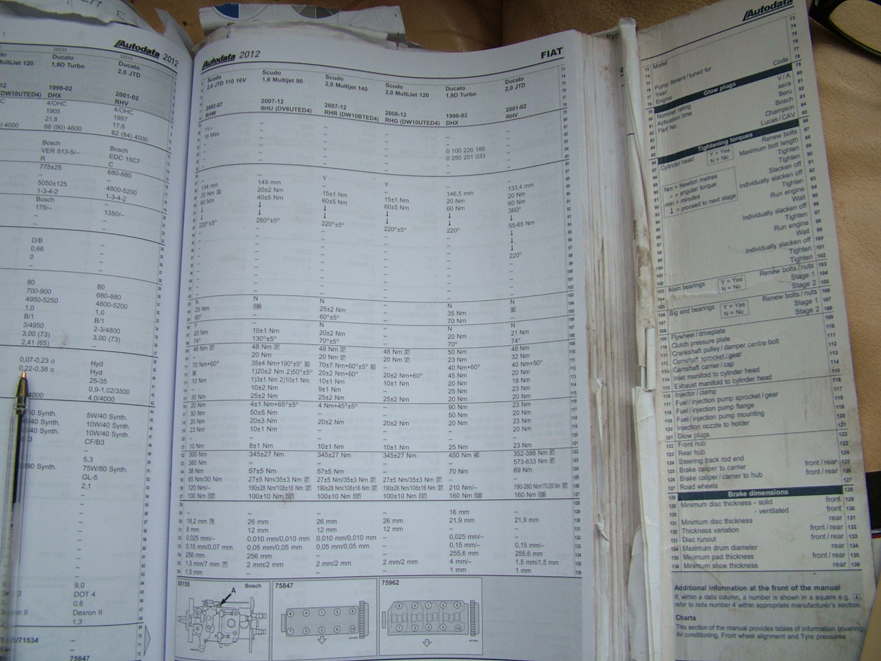

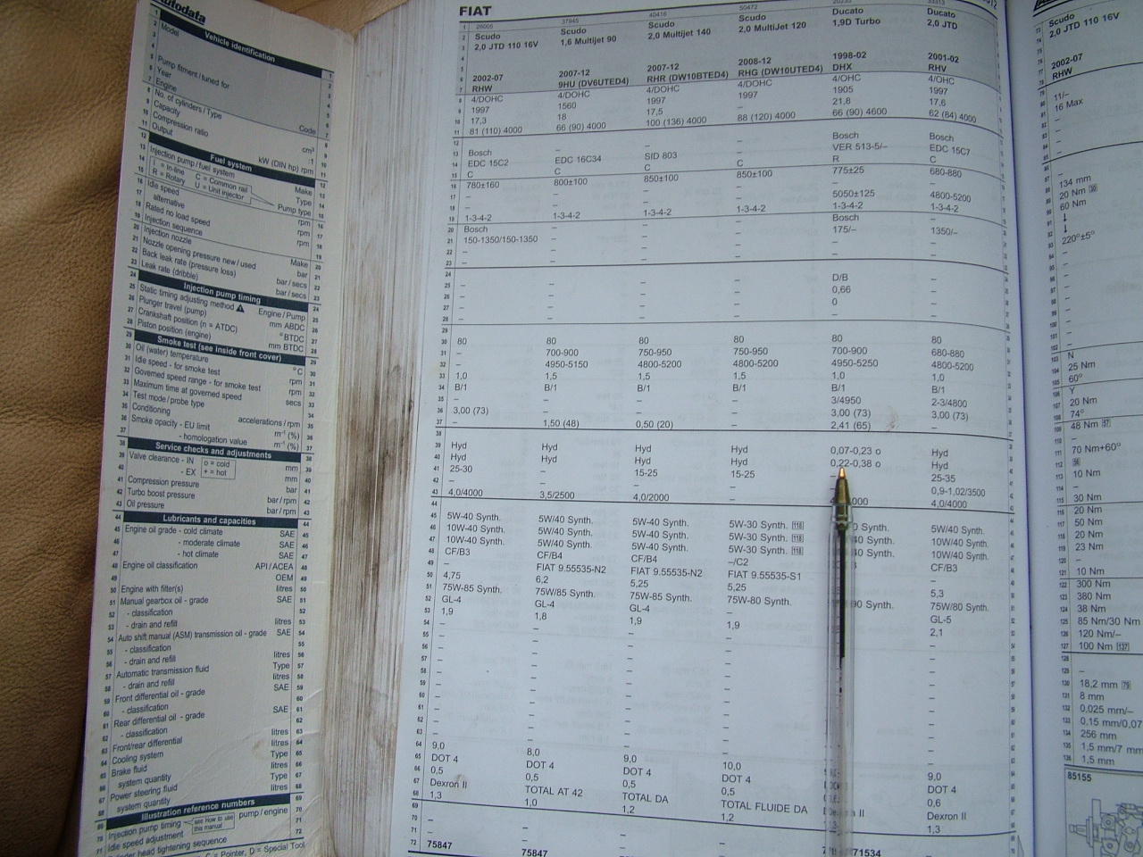

It looks like you may get away with the exhausts, assuming yours is the 1905cc engine in this Autodata manual I have. Pen marks the valve clearances (cold)
I do have a cam belt book, but while it lists a similar engine, the Ducato version seems to start with the later 1.9 which is not an XUD.
If you have an engine code, me or someone else on the Forum may be able to help.
Also if you have the brake vacuum pump on that will have to come off.
Rather than buying shims you may be able to have them ground down at an engineering works, I did on a 1998 2.8 Ducato engine.

As Davren says, not ideal to grind away surface hardened shims, if correct size ones still available that is the preferred option.
DHX on chassis plate corresponds with Autodata details, note it also on right hand page shows torque settings for cam carrier.

Now I am sure it's a DHX (as on nameplate) 1.9td. You have correctly pointed out the specifications of this engine on the catalog pages. Thanks again.
