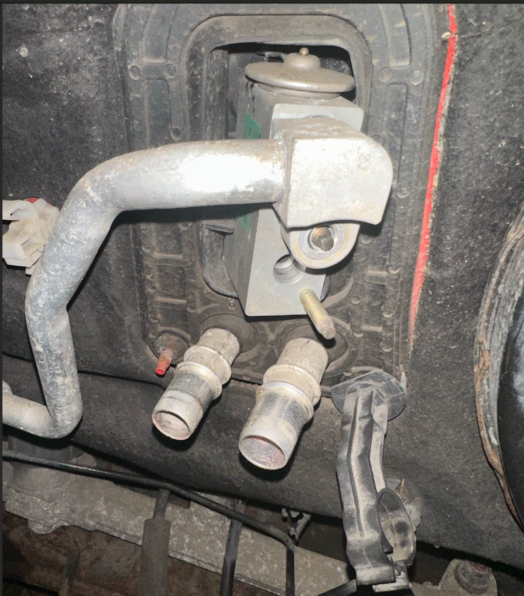

2: The cooling pipes going through the firewall - the part that is hard pipe mounted in the firewall has two retaining edges on them. I can only get the rubber hoses that connect to reach the first. Should it reach the second? (I don't remember how far in they were mounted on disassembly).

Attaching a picture of the pipes going through the firewall (second question) - from the dirt it seems like the hoses locks on to the first retaining edge.

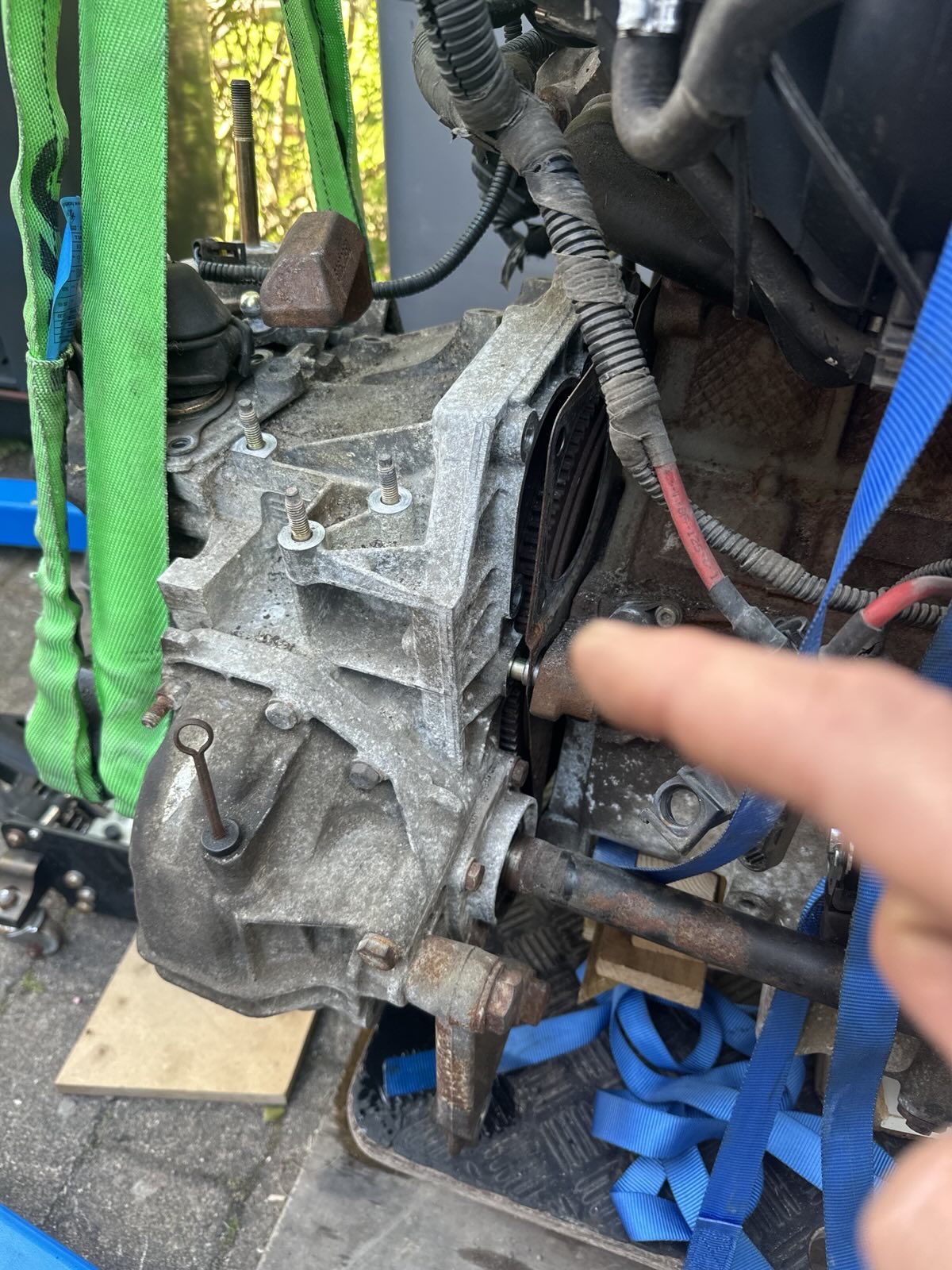

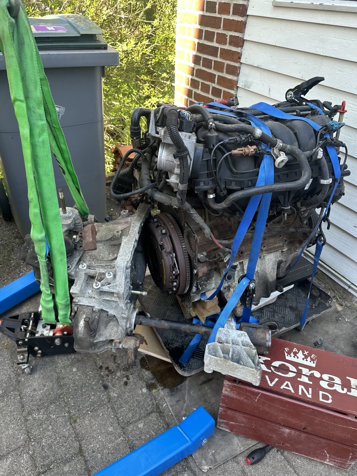

Interesting, so looking into the engine bay from the front, with the engine slightly on the left and the battery on the right, can you guide me to where is the gearbox dipstick is located ?
it's easier to see if you take out the left hand side wheel and arch. On the back of gearbox if you are standing in front of your vehicle.
(on the picture my finger is not pointing at it, but it is right next to the end of the green rope)
