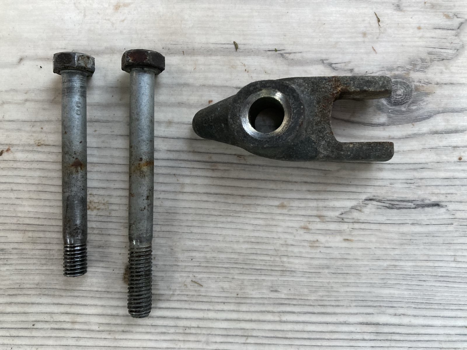

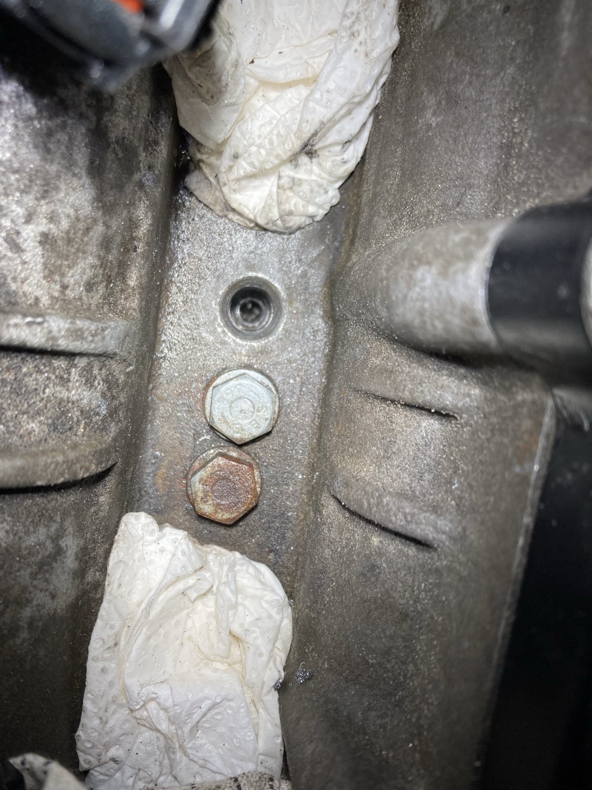

I've snapped 2nd injector clamp bolt during injector removal. Luckily all 4 got out without much trouble after spraying rust removal fortnightly for past two weeks.
Bolt that snapped wasn't easy to unscrew just to start with, used ratchet, I was making one turn out, then half back in and slowly unscrewing. I was spraying it with WD-40, but it wasn't helping. I've went past the moment where I couldn't screw it back in without risking snapping, so I've tried to unscrew until it broke.

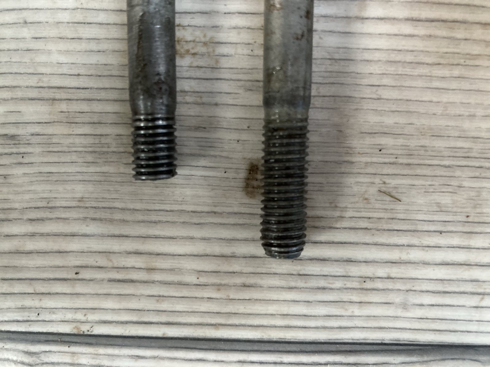

It seems that approximately 50% of the thread got out and remaining part is inside. The remaining part starts at 30mm depth.
It also seems that the bolt thread is partially damaged, so not entirely sure what's the condition of the thread that remains inside.
Any ideas, tips how to fix it?

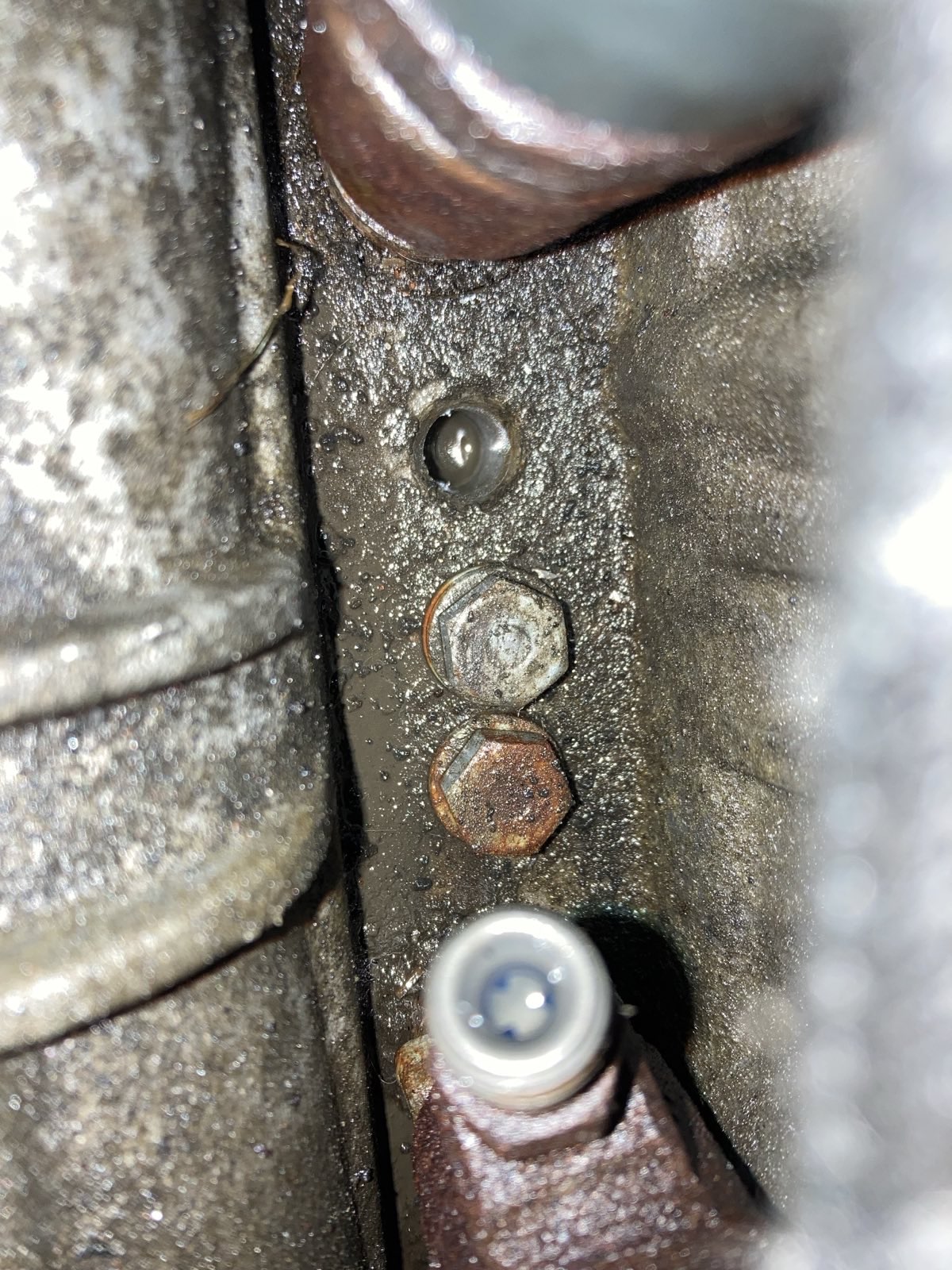

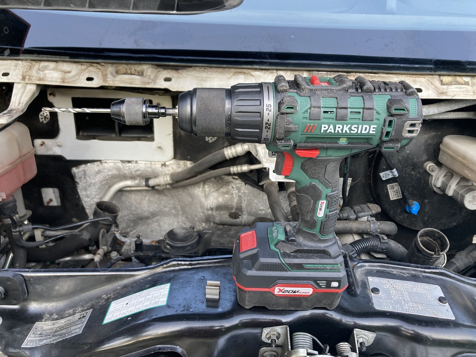

Call me stupid or an amateur, but I am halfway through it, with some help of 10mm (outside diameter) bushes that helped me to centralize the drill.
I've initially drilled 4mm hole, then used 6mm drill, now I've got perfectly aligned 6mm hole in the snapped M8:
