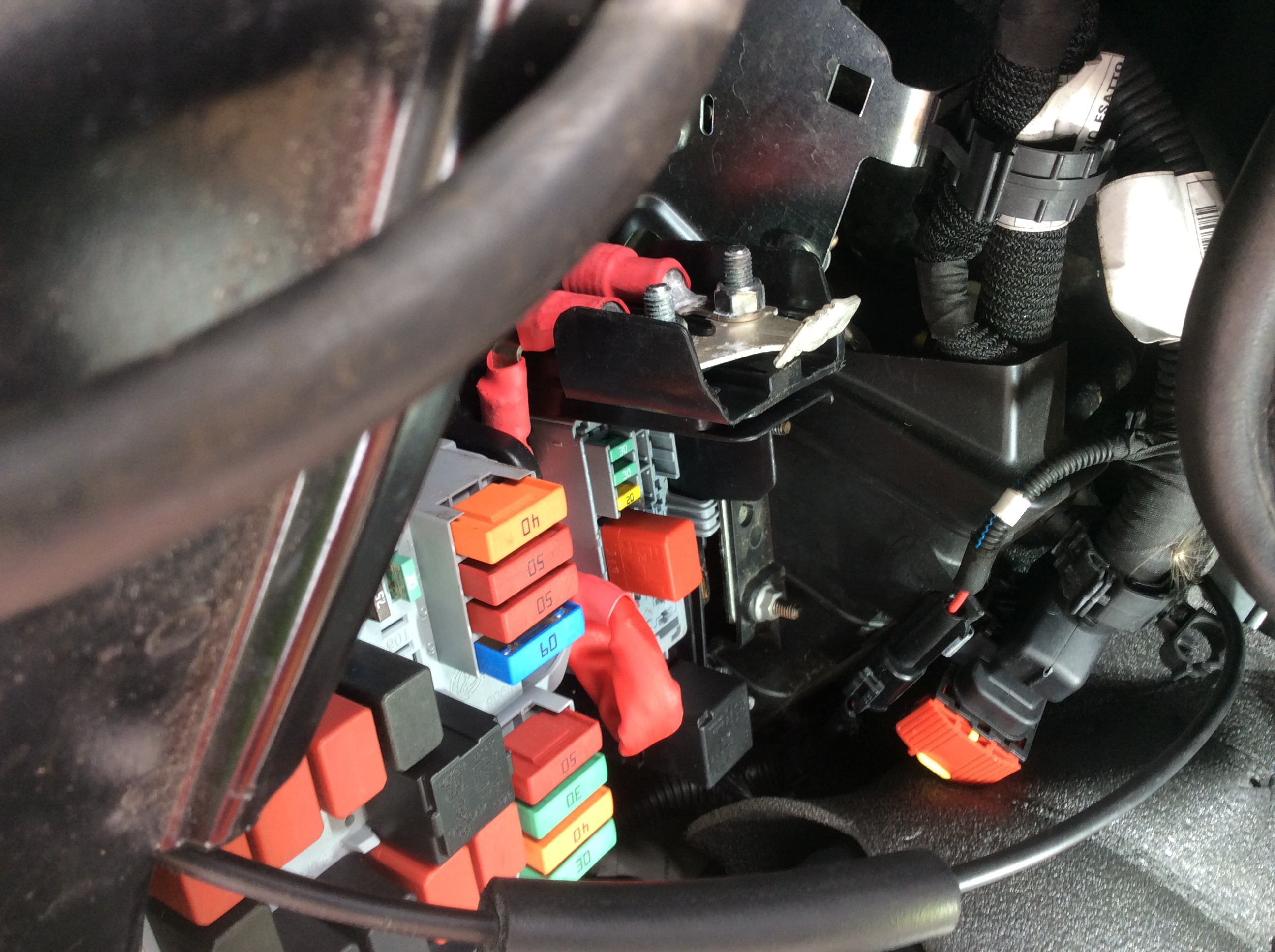

We're sitting here in our immobile 2014 2.3 Ducato 150bhp Comfortmatic x250 Motorhome after a frustrating day. We had packed up to leave site at 11:00, went to start the engine - nothing. Then an error "Check transmission see handbook". The gearbox is stuck in first so the engine won't start.
Fiat Camper Assist/ RAC came out after a couple of hours and read OBD codes including P1810. Tried disconnecting the battery and other tricks but no joy. Jacked up the front and rocked the wheel - still the same. Requested recovery. This proved difficult as we are parked on gravel nose-in so getting the van onto a truck has defeated us for the time being. Also checked fuse F05 for the robotised gearbox pump as suggested by our local Fiat Commercial garage but it had not blown.
I haven't found anything about Ducato Comfortmatic stuck in 1st gear. Any one else had this?
I haven't come across this issue yet, though a few years back they had a major issue with the gear selection actuator breaking up, seen as this component controlls gear selection this would probably be the next place to look, I take it the hydraulic fluid levels are okay ?
FIXED!Re: 2.3 Ducato Comfortmatic code P1810 won't start. stuck in 1st
Ok, the problem has been fixed my a mobile engineer arranged by Fiat Camper Assist (i.e. RAC) together with telephone assistance from a technician at Adams Morey Portsmouth.
The pump operating the Comfort matic robotised manual gearbox was not working. This was determined by listening for the pump whirring when the drivers door is opened (the system readies itself by pressurising the system before you enter the vehicle, see Fiat manual). I had already checked fuse F05 as advised my Adams Morey and it was intact. The fault was traced back to a connector located under a cover behind the fuse box under the bonnet. See the thin red wire in the mid right of the attached photograph which enter the connector. Wiggling the connector fixed the problem.
Thanks for the reply. Hope this helps someone else down the road.

there is also a multi plug that gets water ingress just to the left of that red wire and corodes.
