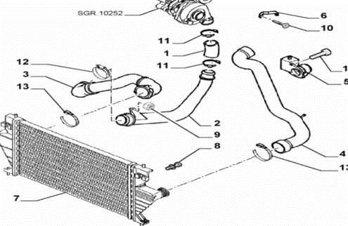

The diagramme helpfully uploaded by Andycabs does not seem to show the hose I've got. The failed part is a short 90 degree rubber bend between two straight hard plastic hoses, held on by a clip at each end. I will phone around.

[FONT=&quot]"no.3 in the image is priced at £150.72+vat. A special order item[/FONT]"

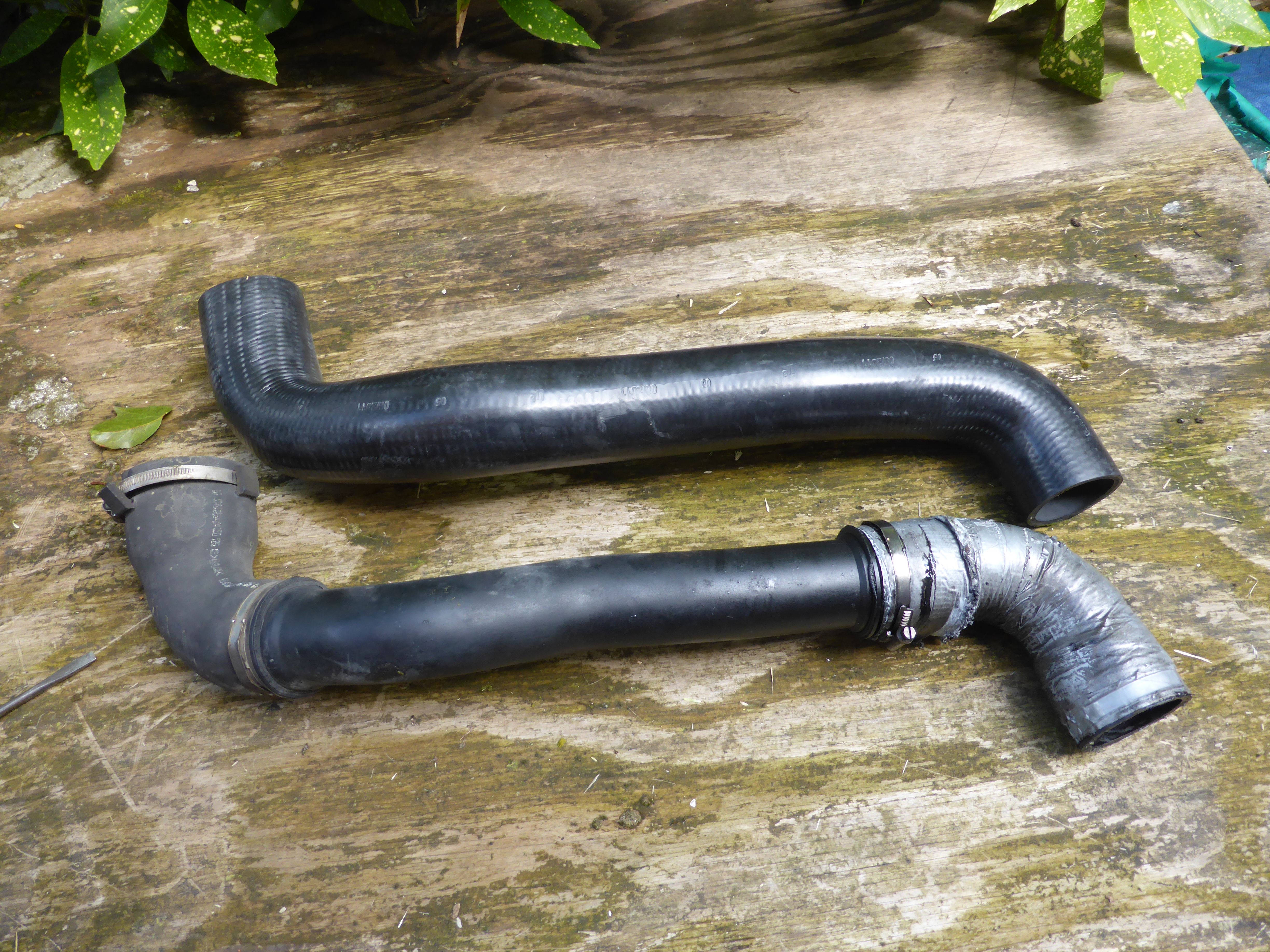

Re: 2.0JTD SX 04 turbo issue (fixed)
Bought the hose from turbo-hose.com (Google: turbo hose 0382.HQ for various vendors).
It fitted, replacing the burst elbow (just above/behind the front bumper, in the middle), and the glassfibre/plastic pipe, and the elbow to the intercooler.
The volume of the pipe has increased (compared to the original). I hope this won't affect anything, but if it does I'll cut off the part requitrd to replace the elbow & use that.
An easy job.
