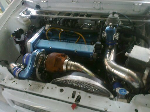

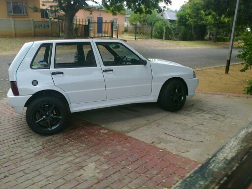

Hi my name is vincent if from pretoria south africa i fitted the lancia thema 2.0l 16v turbo engine with gearbox so it can be done. i used the uno pacer body

Did 1.6hf turbo swap requir costum engine mounts iordriveshafts?
