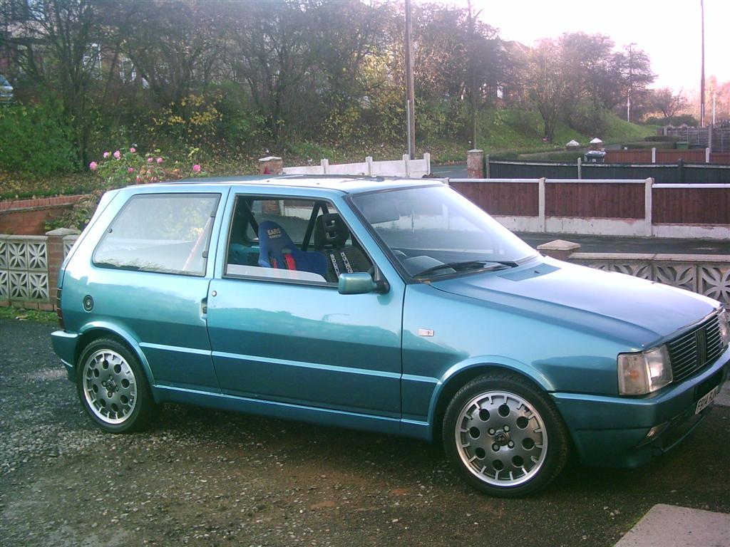

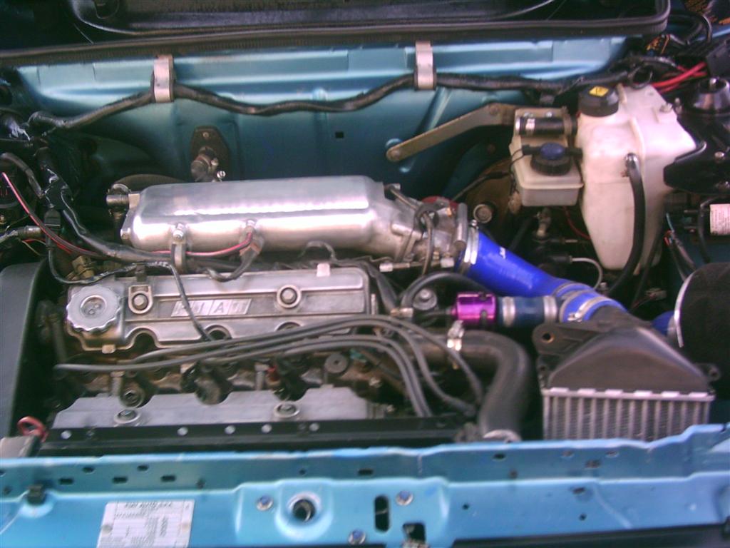

the 1.6 twin cam 8v turbo engine goes in the same as the 2.0 8v twin cam, i've seen it done and been out in the blue mk1 in attached pictures was 220bhp at the wheels
waynegts is the person you need to speak to he has a 1.6 twin cam uno and and is about to swap the motor for a 2.0 twin cam,
see attached pictures of a 2.0 twin cam uno turbo and a 2.0 16v uno
avanti motorsport sell the required engine mounts and driveshafts which you need to convert, the wiring loom is quite simple you only need to connect 3 wires to get it working.

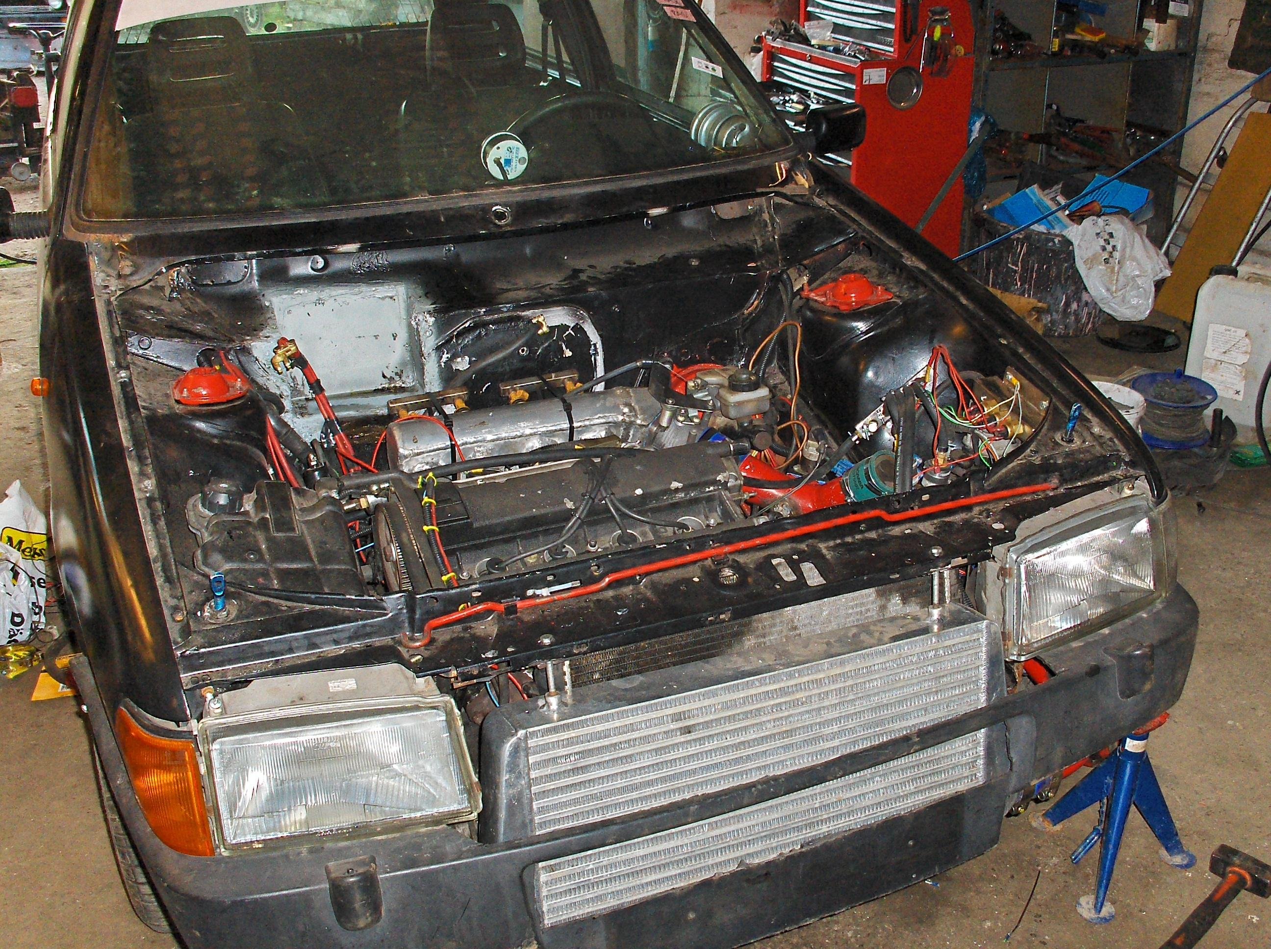

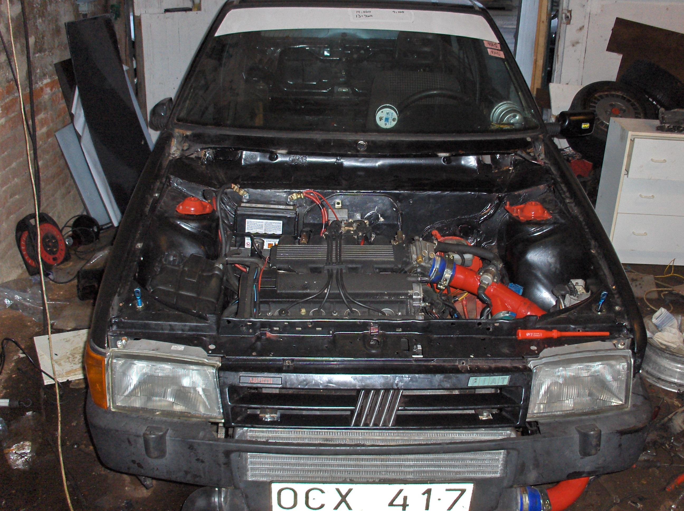

the car with the 16v is my old setup
nowdays i have a 2,0 8v
looks like this
its actually pretty easy conversion.. i´v done worse :bang:
if you want any hints and tips..dont be affraid to ask.. but be prepered my english suchs!! :slayer:

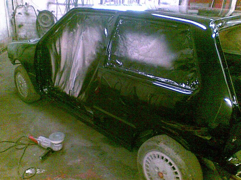

hello again everyone and thanks for all the comments, its nice to see so many different opinions! Ive now bought my uno and have started stripping it ill try and get some pics up after the weekend, ive also sourced a 1987 croma 2.0 8v turbo complete in running order done 81000 miles. £350 thanks to your advice, i hope to view it on tuesday next week and be bringing it back! Ive also e-mailed avanti about engine mounts etc needed for the conversion. Cant wait to get right into it will keep u all updated thanks gaz.(y)
