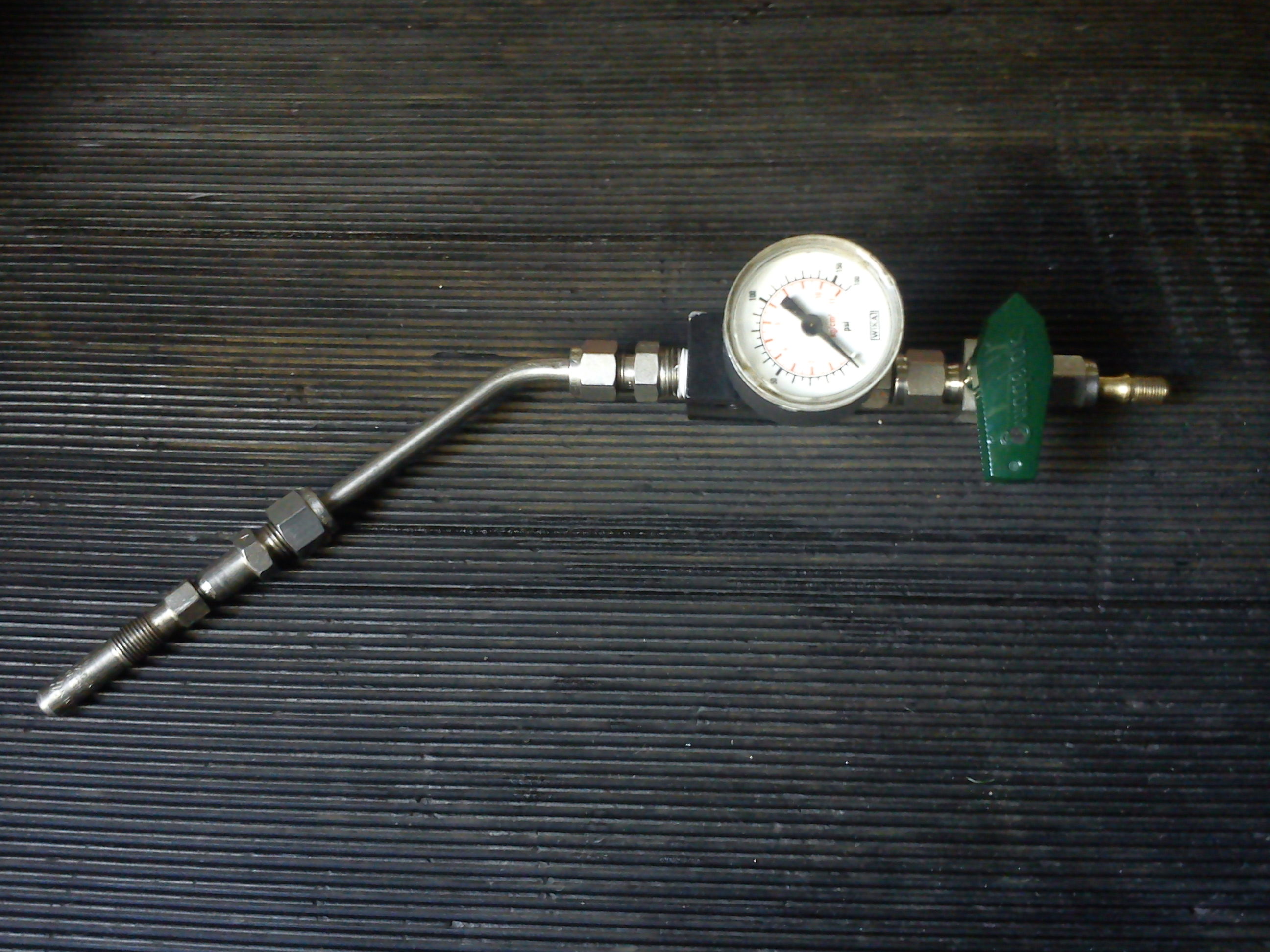

A non start from cold but a start from warm as already has been said is usually duff glow plugs or lack of compression, in our case it was the valves. We checked the tappets and most were tight, we removed the camshaft to sort out the shims then decided to do a leak-down test while the camshaft was off and all valves closed, no reading on any cylinder, so took the head off to check the valves, all needed ground in. Maybe a common fault on the engine, valve recession or shims?
My home made leakdown tester, utilising a drilled-out glowplug and a Schrader valve from a tyre valve.

Once air was injected into the cylinders on our engine, it was obvious straight away that the head needed to come off, as the air was whistling out the inlet trunking & the exhaust pipe.
