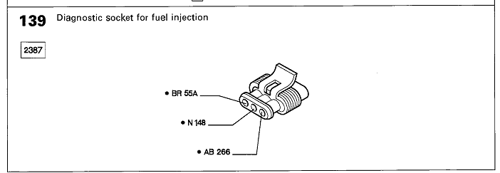

One of these ECU specialists declared that there _is_ a diagnostic port on my vehicle. He said it was a 2-pin port and situated under the bonnet near the battery. I thought it unlikely (data comms normally needs more wires after all), but lo and behold when I looked this morning, I found a strange object. Oblong, mounted on the bulkhead, pointing upwards, and with a rubber cap, what I saw has 3 wires connecting it. When I removed said cap, I saw a circular white plastic moulding with what appears to be 2 or 3 connectors recessed into it. It may well be a socket of some description, but it's not of a type I've ever seen before.
As you can see from the pic, I've held a mirror up against it so the top can be seen more clearly. Can anyone here confirm that this _is_ a diagnostic port, and if so, what sort of plug it takes.
If it isn't a port, WTH is it??
