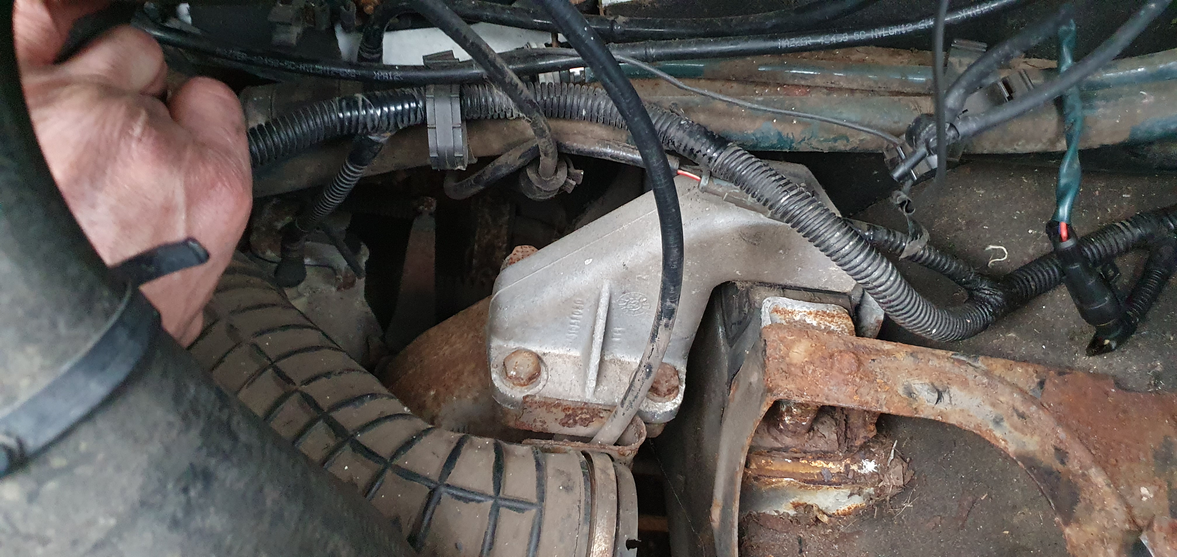

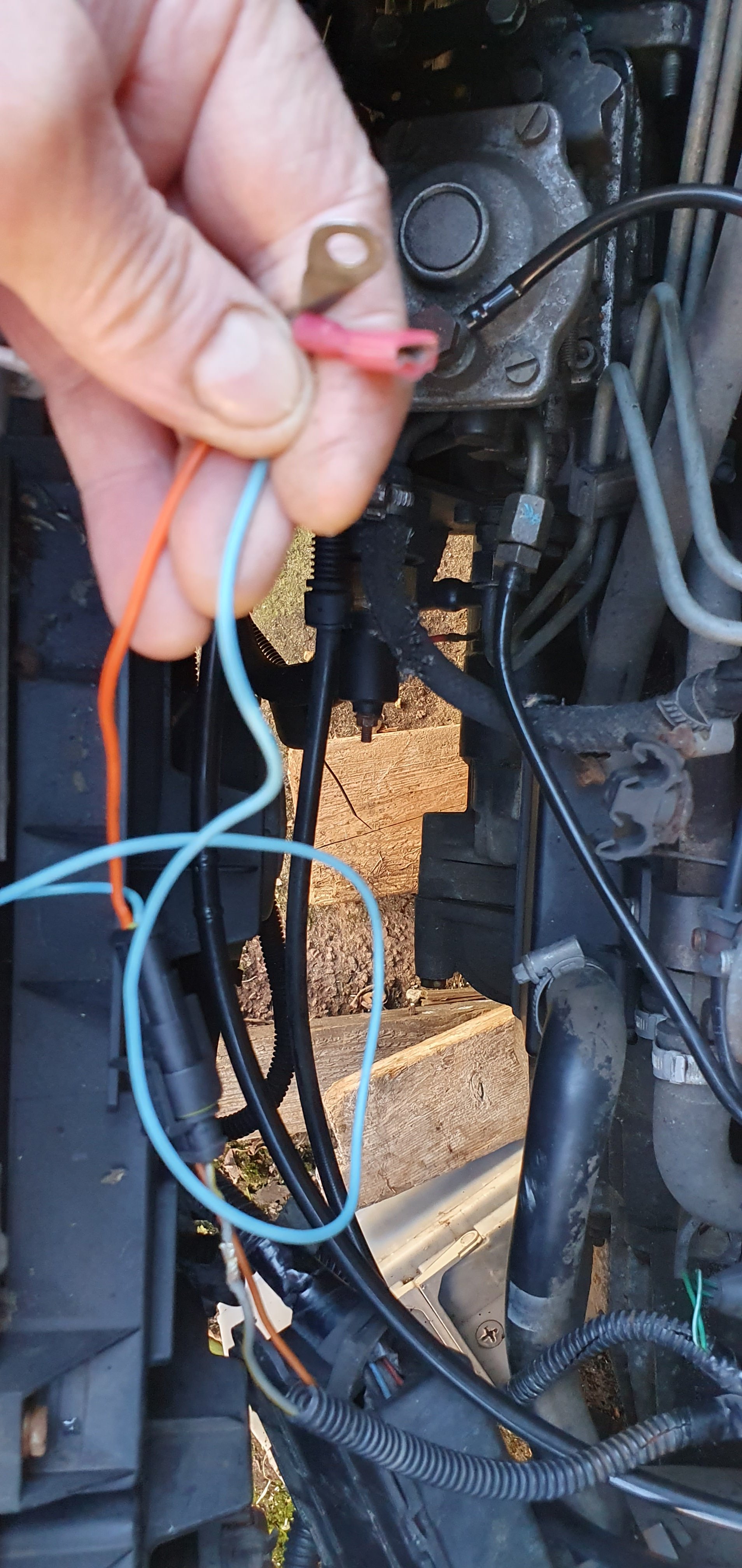

Hi everyone,
Thanks for replies!
Regarding the loose wire do you think it could be the orange wire in pic1, as it has a crimped circular connector and the blue one fits on a bayonet pin from that waxstat below in pic 1,, maybe only the blue one should be connected to it and the orange one to the starter solenoid valve, as the orange one has a circular connector crimped on the wire, that would fit on top of the starter solenoid.
Both wires are connected to that waxstat in pic 2, but because this has been going on for a long time maybe only one wire was meant to be connected to the waxstat in pic 2. I could have mixed them up?? Only problem is, both these wires, ( orange and blue) dont have any voltage on them??
In pic's 3,4,5,6 and 7, I'm following the cable back the opposite way!
In pic 7 there is a connector to the right with a blue heat shrink wire going up, this wire connects to the bottom of the fuel filter, not sure why there is a wire connected to the bottom of the fuel filter?
I will keep looking for a 12v wire that when I connect to it with my test wire it will start engine and stop engine when I turn ignition off. I have been looking and testing different 12v wires in connectors but no such luck as yet, will take some pics of connectors tomorrow and attach, if ok.

I have looked at the photos, perhaps some more than others.
Please check fuses, as suggested by @bugsymike
The orange and blue wires appear to be pushed into a two way socket? Yes/No?
If yes then the original connections to the pump, with mating half connector are missing.
I can see no reason for two wires on the waxstat, which will probably use earth return via the pump body.
The orange wire is significant, as I have seen that colour wire shown on a diagram, as connected to the relevant terminal of the ignition switch.
So inline with your suggestion remove the orange wire from the waxstat, and then test the wire for 12V with ignition on, and also with switch in starting position. There must be no 12V when ignition switch is off.
If all OK connect orange wire to stop solenoid, then test starting and stopping of engine.
Given positive results, the supply to the waxstat should be checked.
If as seems to be the case, the orange and blue wires are just pushed into the half AMP Superseal Connector, then this connection must be improved. If the connection should separate the vehicle will lose power. Not something that you want. At the very least securely tape over the connection. Amp Superseal Connectors for various wire sizes should be available from Ebay, or elsewhere.
