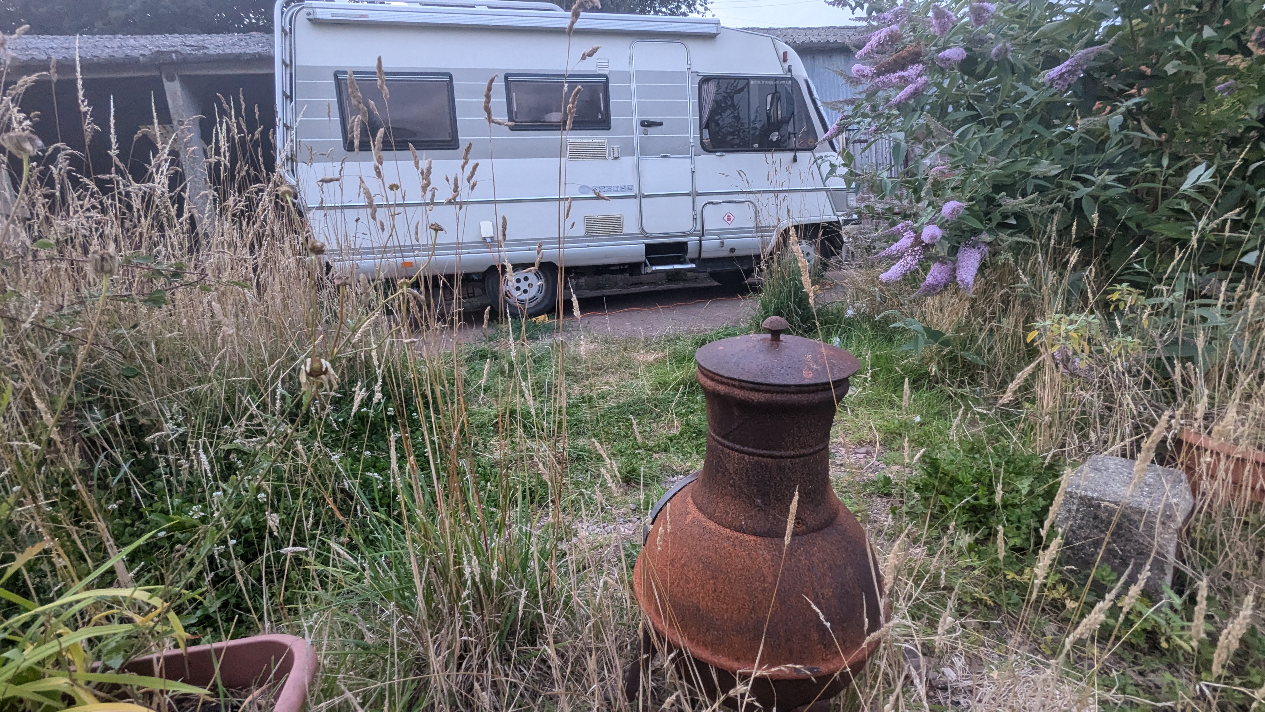

I have changed my driving habits...used to do removals around Europe pre-Brexit with a 2007 Mk7 Transit, often likely pushing or over 3.5Te. Never had a brake issue.
After Sunday's episode on a steep slope into Budleigh Salterton beach car park, I should have just stopped and waited for the lady to reverse the 75m and then drive down the hill in 1st, rather than slowly follow her down just using my brakes.
I can get round it if drive with the brake problem in mind but it shouldn't be like that....but maybe it's just a weakness.
Our Hymer 534. is pretty much the smallest model. I should put her on the weighbridge but likely to be only 3.2Te.
