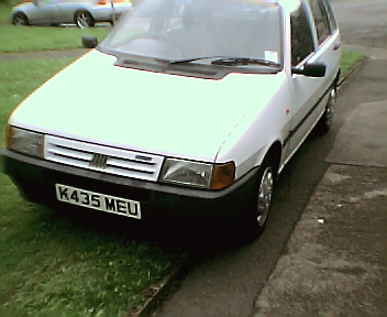

uno1001.jpg here is the old bitch! (y)

The Uno looks very smart, by the way (y)

Hi, thanks for the compliment about the uno... i do try to look after it and although its gettin on in years i refuse to part with it! :D its by far the best car i have ever owned.... Anyway got some good news, ive just tried the motor and the fuse and the fan worked so i thought its either thermostat or fan switch!!!! got a new thermostat this morn and have fitted it on....refilled and bled cooling system and the car is now heating up as it used to and when the gauge is on halfway the fan kicks in and so on... so it looks as though it was the thermo... only cost me £12 so thats even better :) thanks for the help everyone!! (y)
