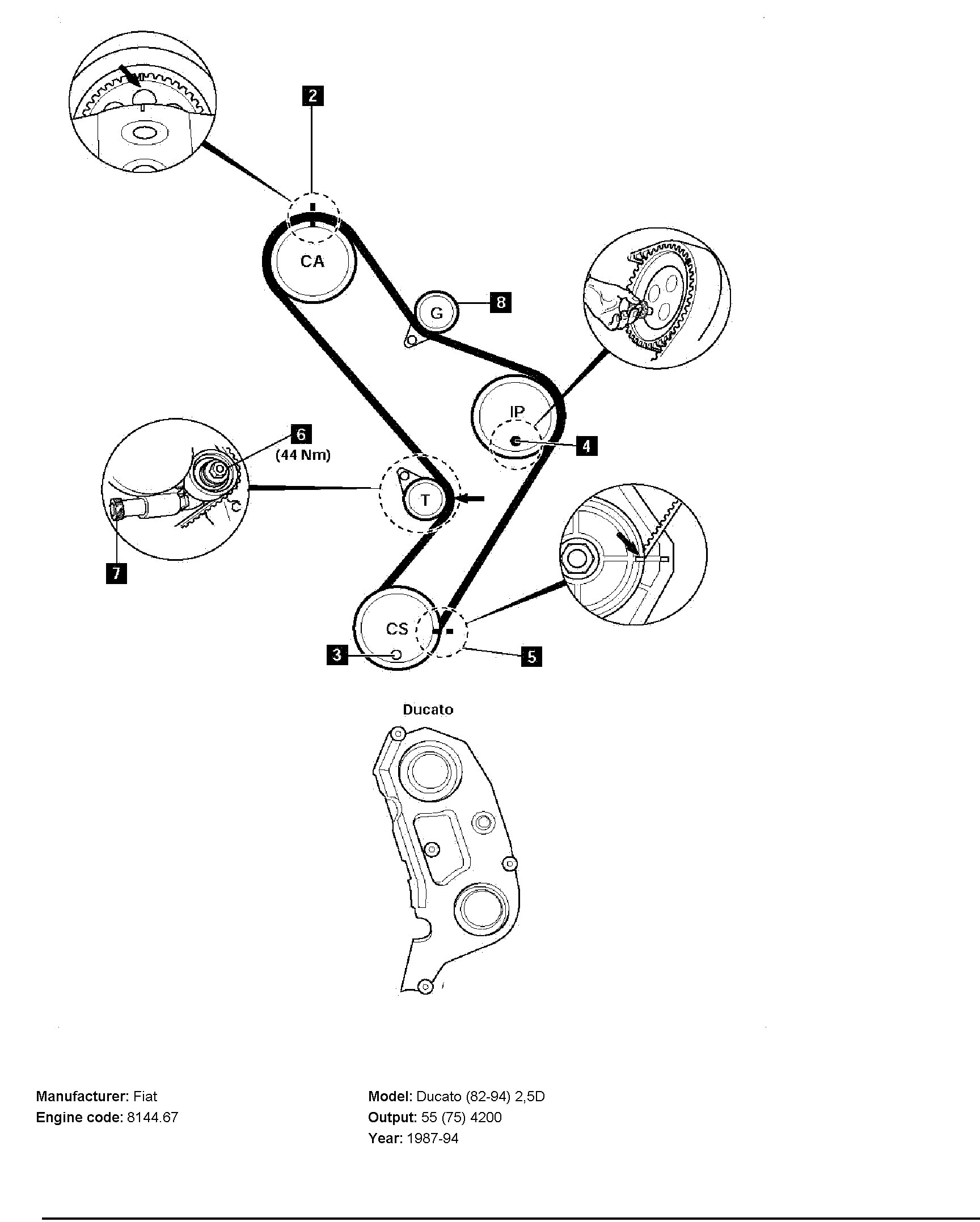

Hi
According to my info the 8144.67 (87-94) & has a capacity of 2499 cc 55 kw @4200 rpm & is not a Factory Turbo engine. The Turbo must have been added by TB at Lancaster. The timing belt should be changed @ 100,000Klm or 78 months. as for the engine No. location ??

Thanks for that info Freespirit, most helpful, well that confirms what I had worked out, the V5 stating 2428cc must be wrong, also the turbo not being original would appear to be correct, ( goodness knows how much that must have cost, because you would not know its not original) the autodata print out for changing the belt that I have, is the same as what you have posted, but there is no mention of removing the crankshaft pully, (which clearly has to come off) why its not mentioned I dont know, as its the most difficult bit, and I was not sure there is enough room to get the pulley off, I was hoping someone who has already done the job could give some tips on how it was done??? thanks again FF
