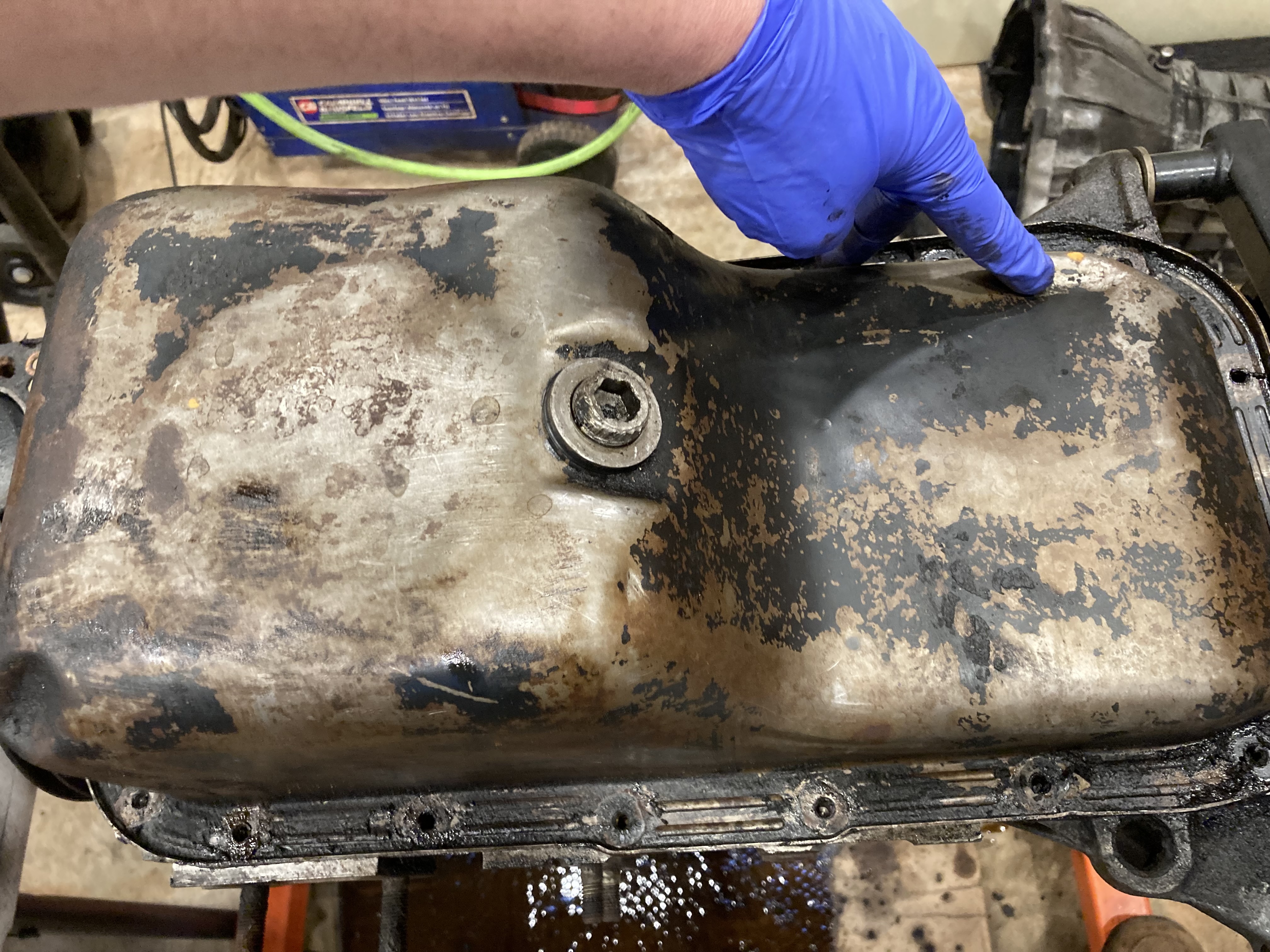

Okay here’s today’s update:
1) oil pan. It’s got some dings in it but nothing that impedes the oil flow / pump. Leave it alone?

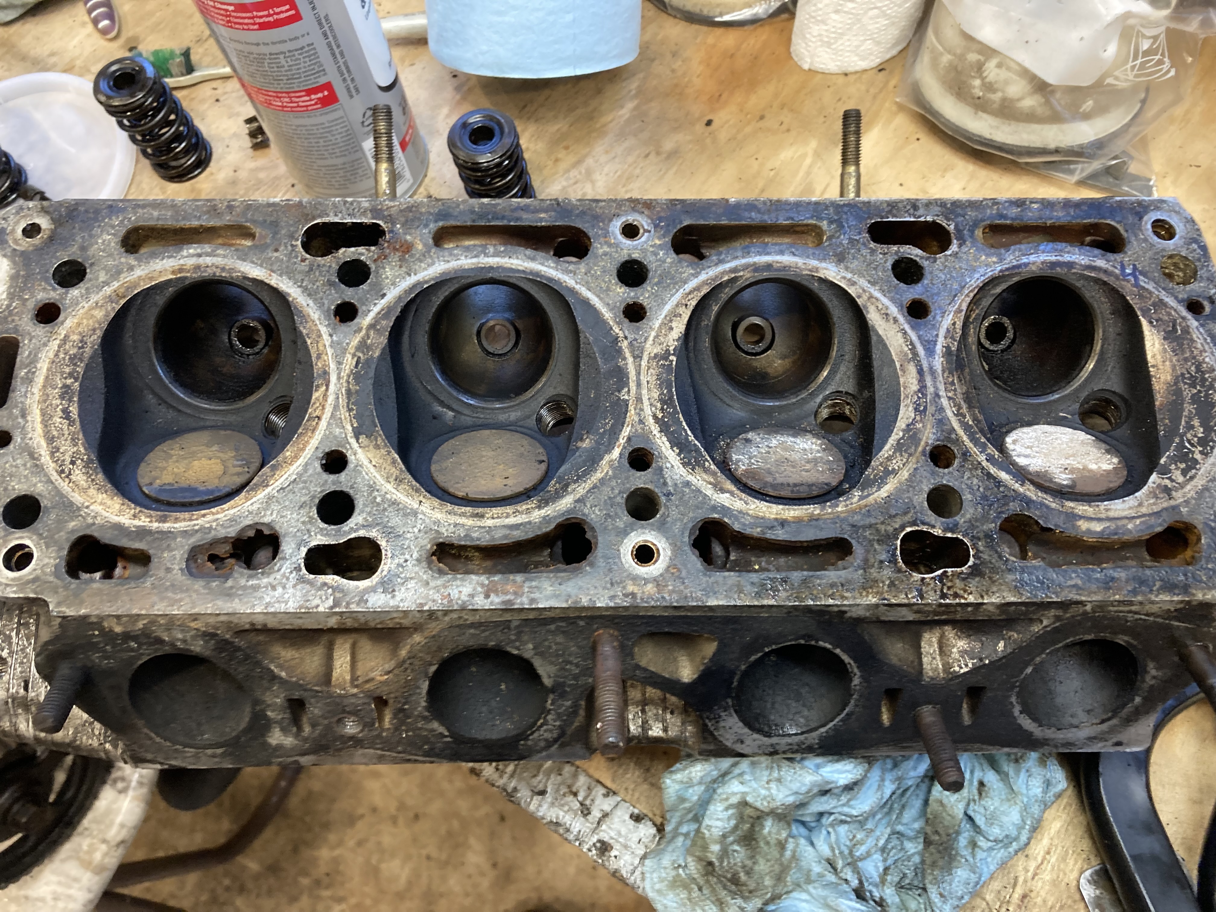

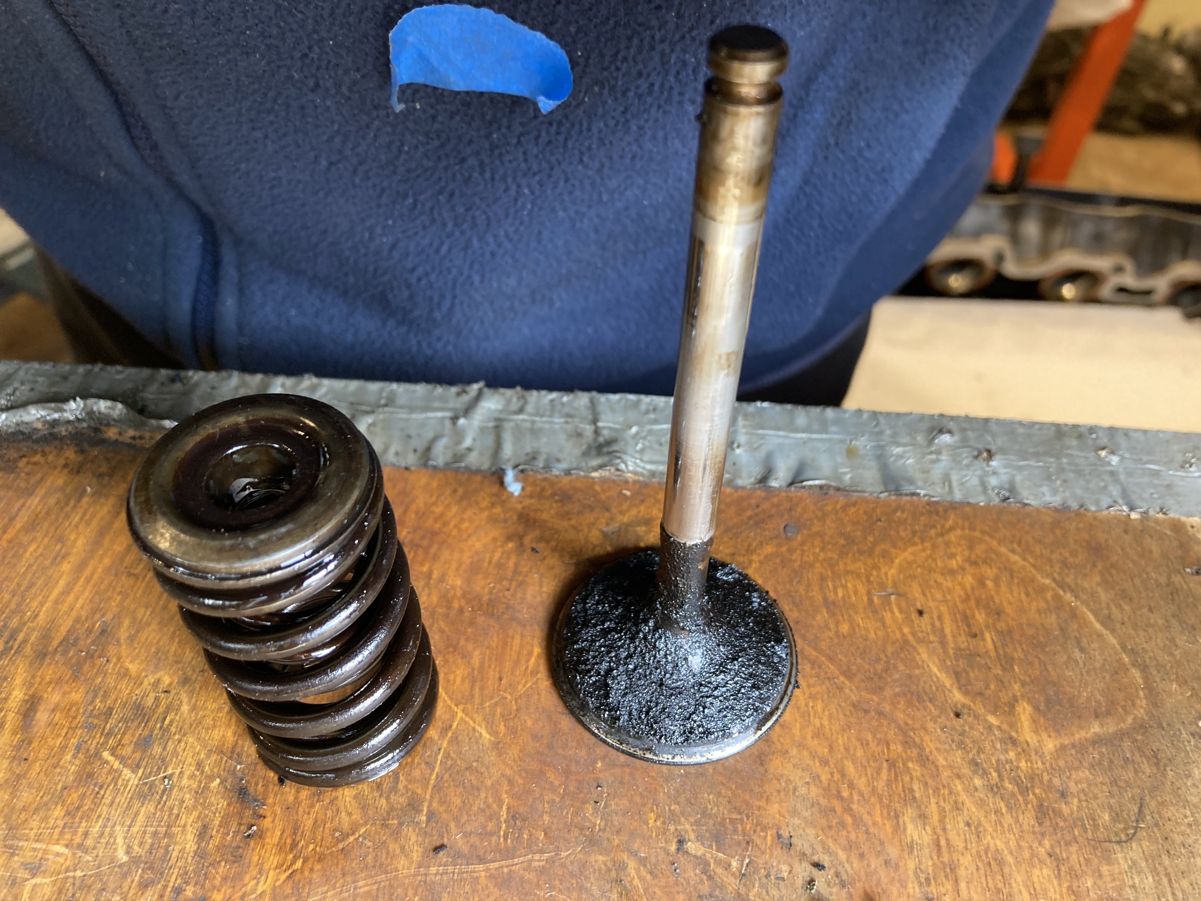

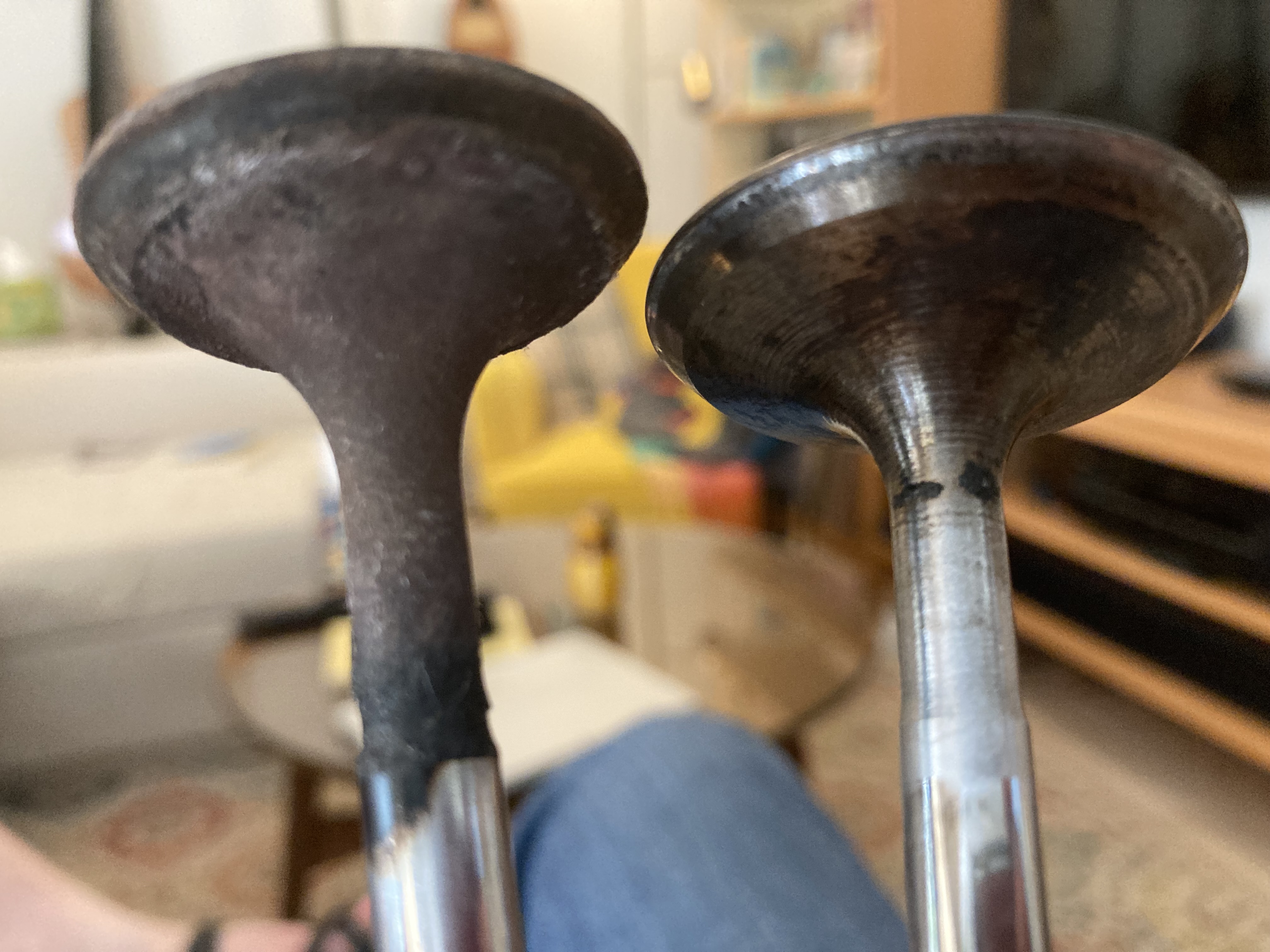

2) Cylinder head and valves. I procured a spring compressor and removed the intake valves. They all are black and crusty with buildup on the top, and caked a bit with burnt on business on the hot side. I soaked them for an hour in chem dip, rinsed and wiped a bit - some came off; perhaps more will with another round.
Salvageable or should I just go ahead and buy a new set? BTW valve guides seem smooth at first inspection…
All looks pretty normal
What matters most is valve guide wear, if the valve stems are at all sloppy in the guides you need new guides
The valves can be cleaned up. Spin them up in a drill chuck and use emery paper, possibly a blade. The valves material is pretty hard but dont go too mad
Check the valve seats for cracks, craters etc
A crude way to get an idea is to put the valves back in and with the head upside down pour some diesel or kerosene into each chamber and see how long it takes to drain

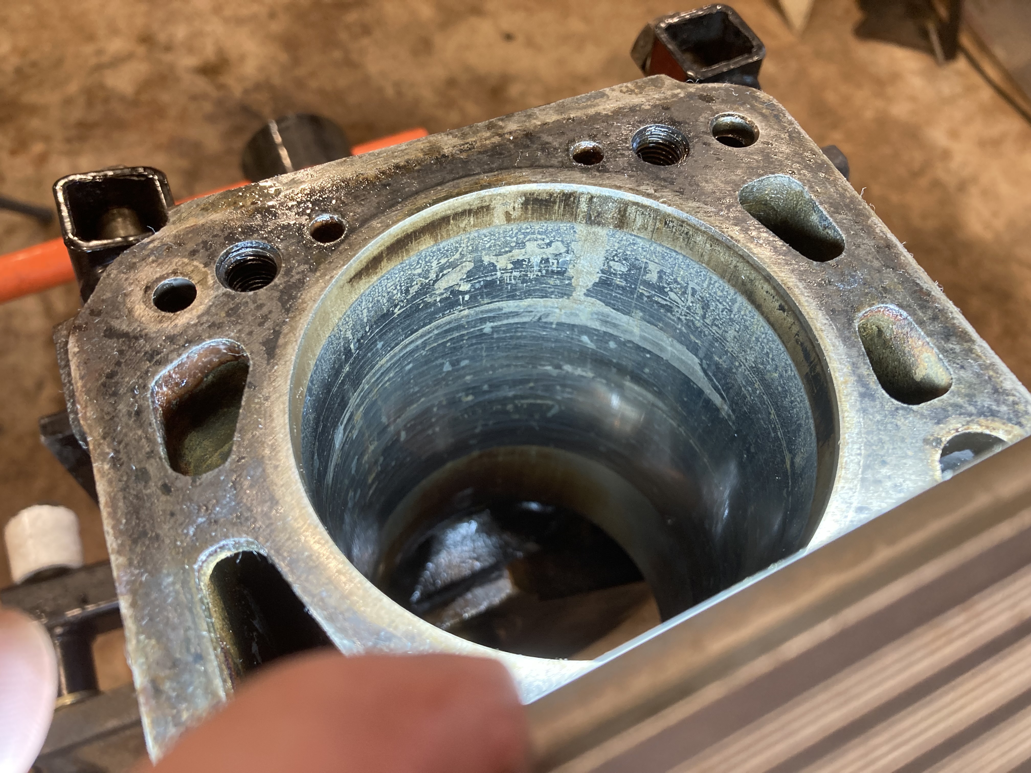

Ideally you should have done a compression test and pressurisation/leak down test to establish condition before the teardown
Oil pump again ideally should have done a test on oil pressure to assess.
You can measure wear if you have a manual with the specs and the kit to do it, but its a lot easier to fit a pressure guage and crank the engine over!
Most engine components have detail dimensions and tolerances, unless complete toast there isn’t much you can infer from photos.

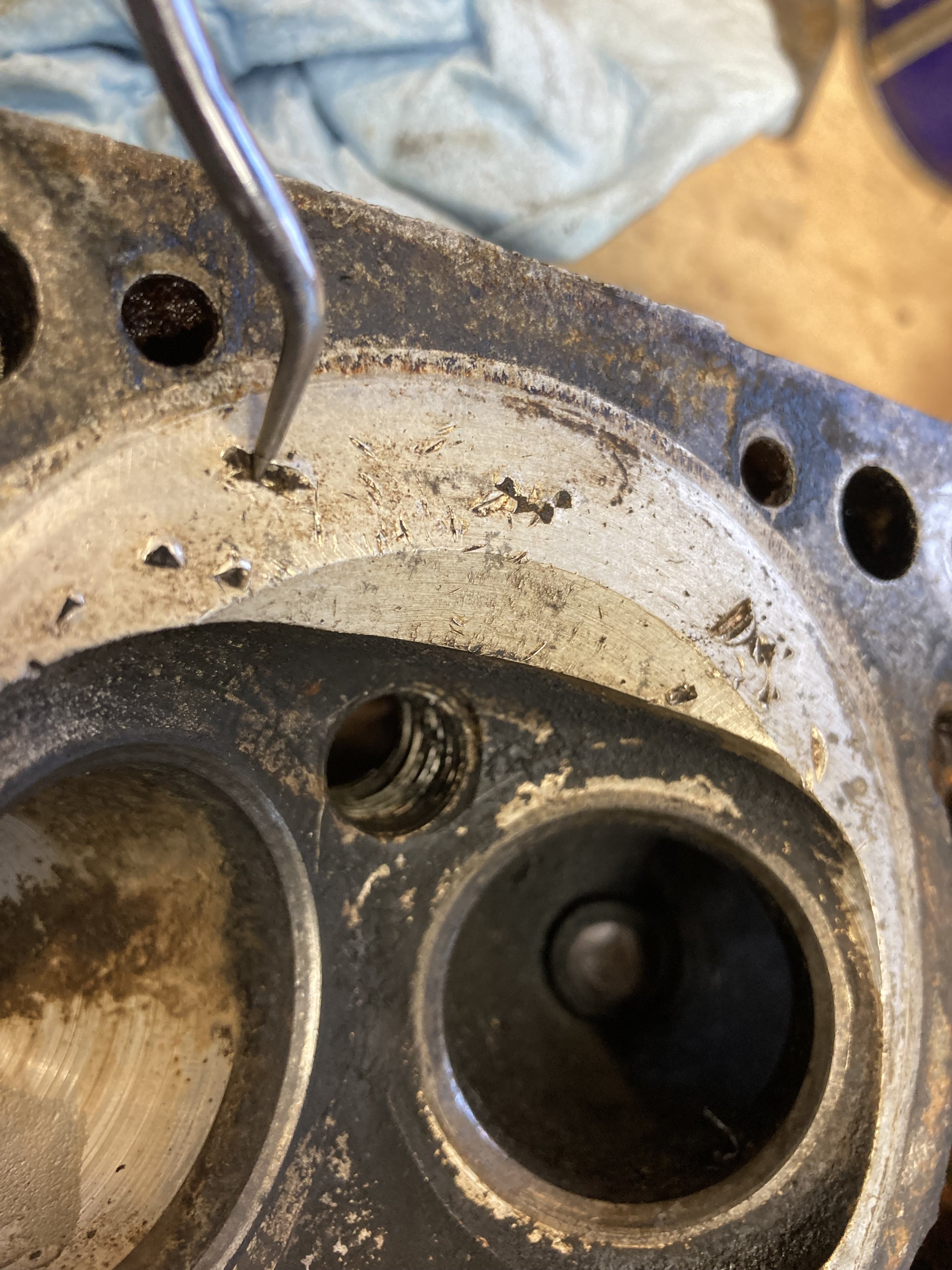

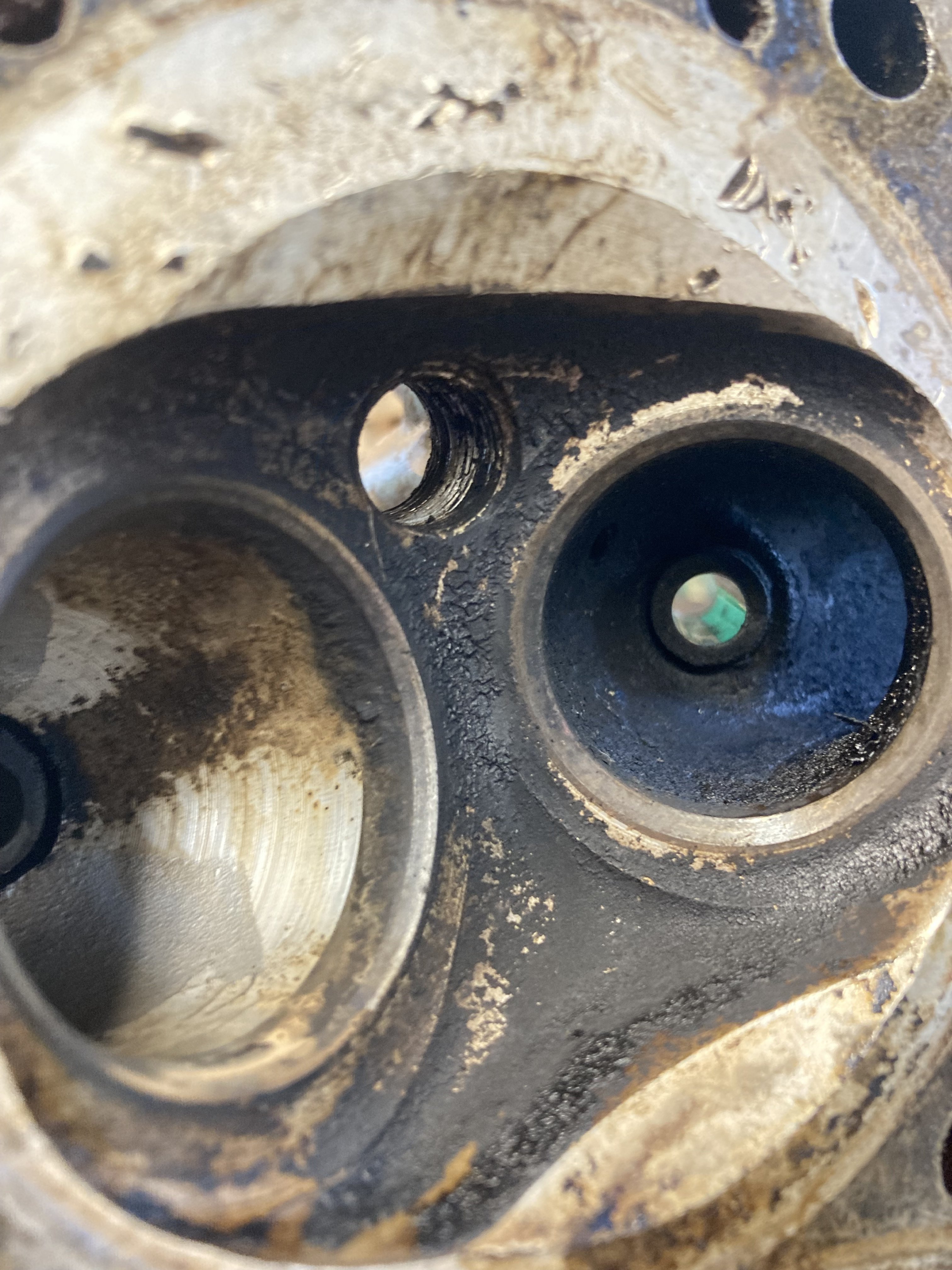

Update: #4 cylinder reveals new info:
Yikes. Looks like something banged around in there?
Also - will need helicoil for the plug:

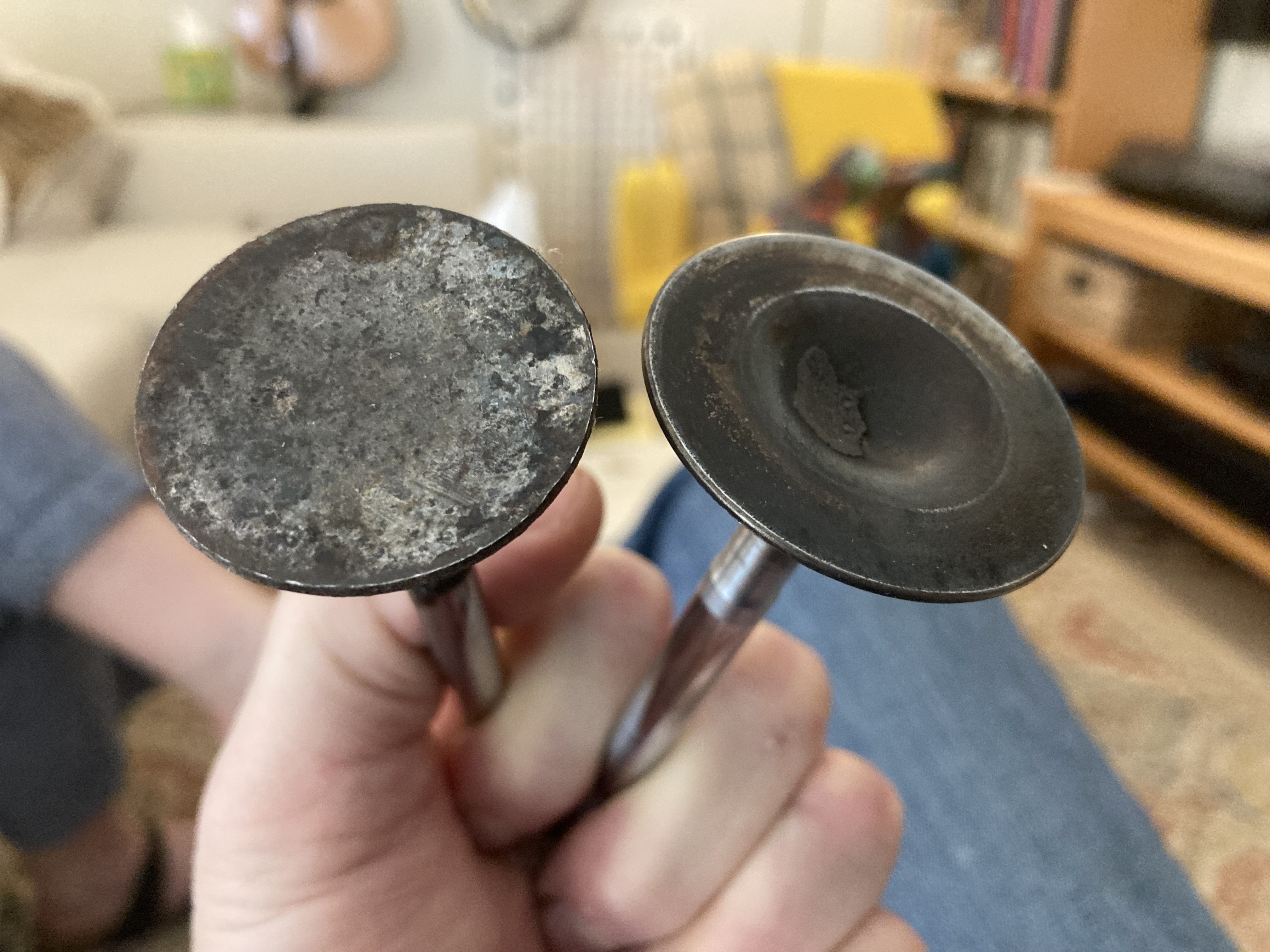

And finally - 3 rounds of work on the intake valves and they are looking better. Thanks for the tips on using the drill / emory cloth. Still some buildup on the hot side to contend with before moving on to lapping.

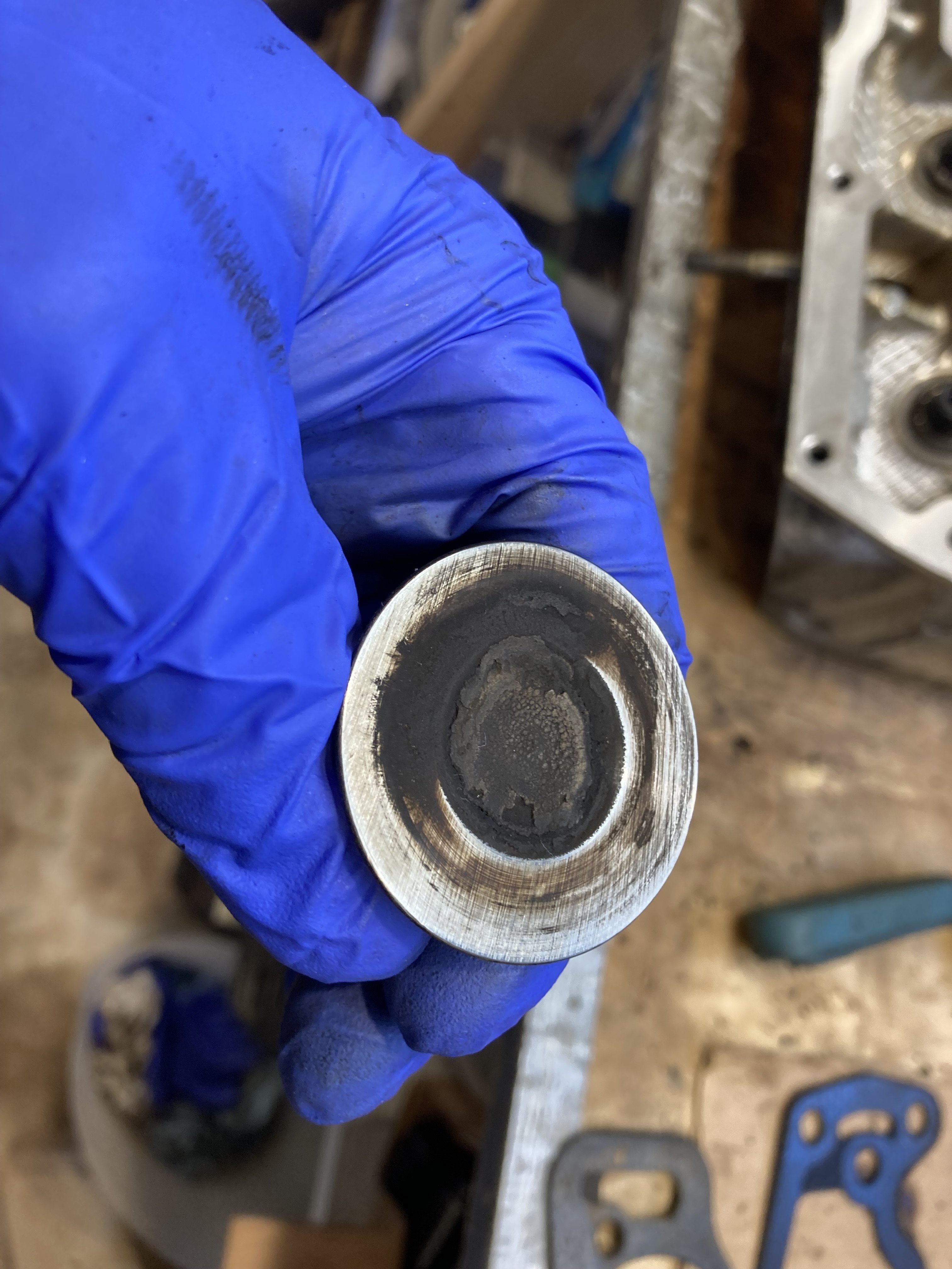

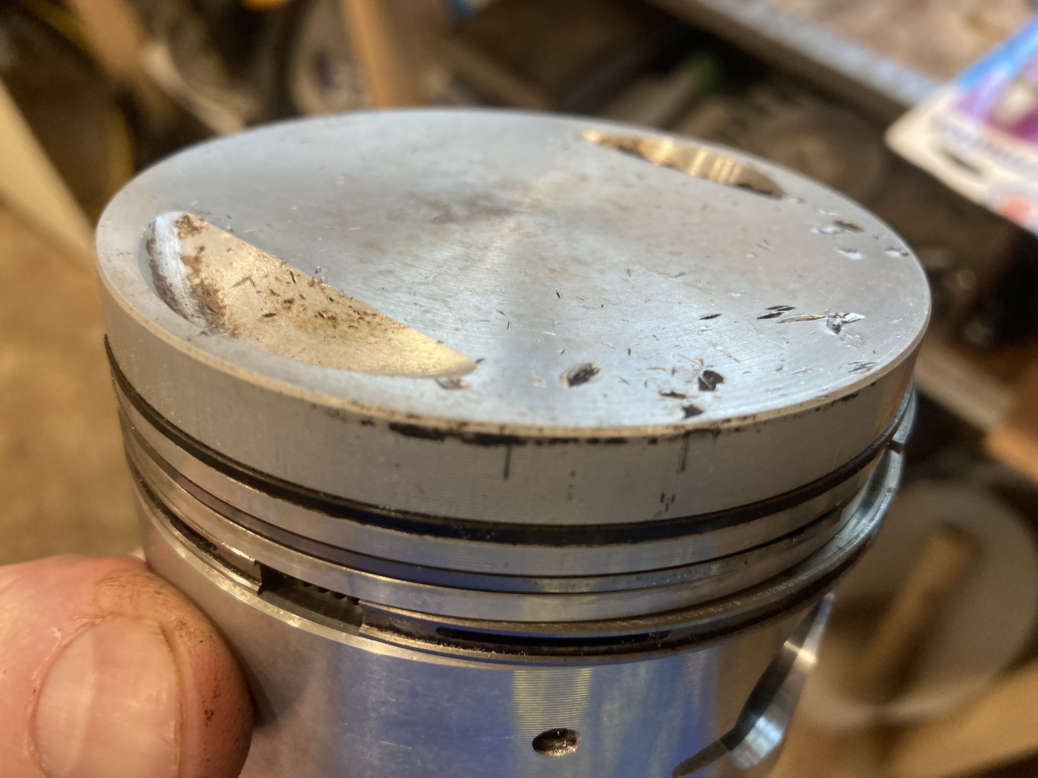

Update du jour. some good news. Some not so good. Good news! Was able to successfully repair the spark plug hole for #4 cylinder.

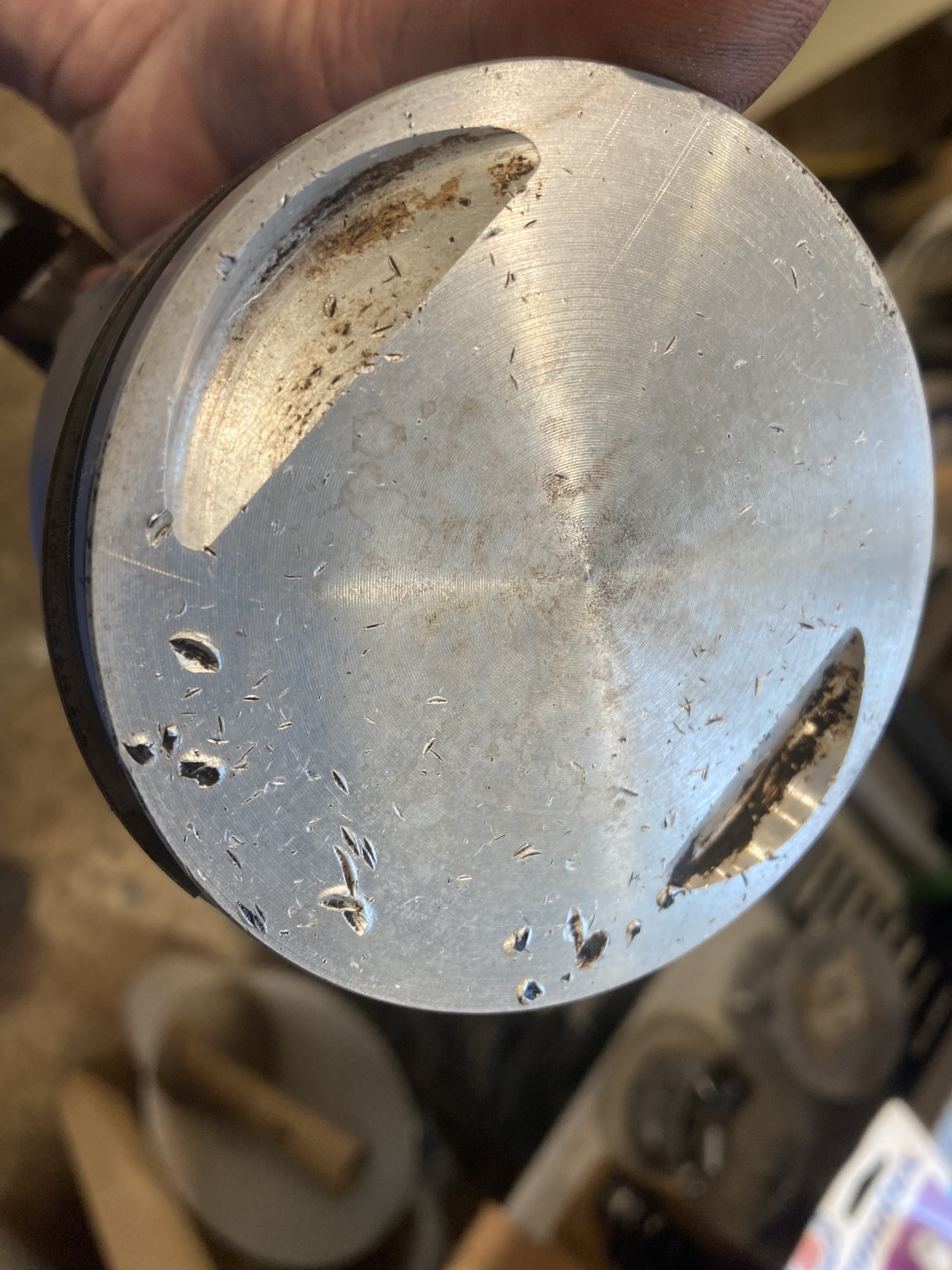

Also good news - first round of cleaning the pistons leave me thinking that I can keep them and their rings.
Bad news. 4 rounds of chem dip, wire brush, cleaners, razor blade, 0000 steel wool and the valves just don’t look like I want to use them again. This is intake and exhaust from #3, and is not the worst of them.
Well done for fixing the No. 4 plug thread.

Razor blades and 0000 wire wool? - Too gentle.
Wearing eye protection, chip the heavy lumps of carbon from the valve heads, e.g. using an old screwdriver, old decorator's scraper/putty knife. Recalcitrant lumps of carbon can be despatched using a judiciously applied gentle tap from a small (pick) hammer or similar. Then either mount each valve stem in a drill chuck and press emery cloth against the valve head to remove any remaining carbon or/ use a wire wheel on a bench grinder to clean off any carbon (be careful doing this...).
I noticed deep parallel scratch marks on the inlet valve shown in post #128, as if the valves had been cleaned on a sanding/linishing belt - my way of cleaning, using emery cloth, will leave a nice smooth very clean surface (almost as good as new). They're not going to stay clean for very long once back in the engine.
When decarbonising the combustion chambers in the cyl. head, refit the valves to protect the valve seats, scrape of any heavy carbon deposits by careful use of an old blunt screwdriver, clean remainder of carbon using a wire brush in an electric drill and if you wish, you can finish off with some wire wool (0000 is possibly? too gentle). I'm not a fan of mirror-polishing the combustion chambers or the cyl. head ports on an engine to be used on the road.
I usually just clean the ports using an electric/air drill with a wire brush attachment on road going engines.
Your valves look fine to me - as far as I can tell from your pics.
Bear this in mind - those valves seemed to have be performing just fine (going by your pics of the combustion chambers and piston crowns) before you stripped this engine and will likely work even better having been decoked and lapped-in....
As per my earlier comment the fit of the part is more important than the surface crud. Piston rings need to be sized to the corresponding bore, there are limits and specs for this in a good manual
Relapping the valves will help but if the guides are worn and the stem seals have hardened its still going to pull oil through and smoke (the cam boxes are flooded with oil when running, there is a weir system to maintain level)
If the rings are worn (even if they look ok) the compression will be lower, you will get more blow by past the rings and a lot of oil mist out the crankcase breather
One thing I meant to mention - when you removed the cylinder head, did you notice and save the 2 small locating dowels that locate the cylinder head and gasket onto the cyl. block? (sometimes they remain in the block, sometimes in the head, but if they remain in the head gasket they might not be noticed and are then discarded). These dowels are, iirc, approx. 8mm diameter, one fits in the front left corner of the cyl. block ,the other goes in the right rear corner, when looking at the front of the engine.
I've seen these locating dowels being left out on engines being reassembled in various YouTube videos, I've also seen other 'mistakes' being made...
Hey @124BC1 - thanks, and yes I spotted and saved the little dowels on the head gasket. I did some of your suggested approaches on the head with a blunt screwdriver and some steel wool and that really helped. I think the various openings (save the valves) are in good shape - especially since today was a cleaning day and I got the pressure washer focused on the coolant ports and wow the cascades of chunky orange water that came out - for a long time! I used the pressure washer on the block (focused on the water ports) and feel much better about that aspect.

Decision: this #4 piston and cylinder have me worried. There is a noticeable gouge on the top edge of the piston, matching a couple of verticals in the cylinder. Given all the scarring from what must have been a fantastic-sounding incident, I’m leaning towards committing what would have been budget for interior to the engine to procure new pistons and rings, and hone the cylinders.

You can hone the bores lightly with a drill mounted tool
The piston can be lightly sanded flat again. The projections will cause hot spots and pre ignition.

Update: thanks for the encouragement folks. This is after a first pass with the hone. I’m going to run a finer stone next (once I get them) but cylinder walls are looking and feeling smoother. I also gently filed the high spots from the damaged areas from #4 piston and head surfaces.
