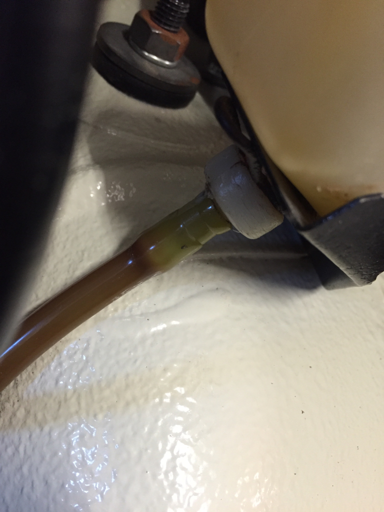

Bought a vacuum bleeder kit from my local auto parts shop and gave that a whirl. Still no pressure on the brake pedal. Not sure what else to do. Air still getting in the system somehow?
Is there supposed to be a clamp on the hose that goes to the reservoir on the nipple? It's the only thing I can think of. I'm at my whits end now.

Yes definitely meant to be a clip at the reservoir. It even looks from your picture that there used to be one there before from the indentation in the pipe.
I know it won't be easy but I would trim the end off that pipe at the reservoir to remove the indentation in the pipe. That old Cavis pipe goes really brittle over the years especially at the ends where it has been clamped previously or to be 100% sure replace it with some modern stuff, it only runs down into the central tunnel.

I had this with my car and it nearly drove me insane:bang:
I used a vacuum bleeder and eventually figured it was down to the tiny bleed screws on the wheel cylinders. I finally started to get some solid feel when I carefully wrapped some PTFE plumber's tape around the threads of the bleed nipples..technically not a good move, and slackened them by a very minimal amount when bleeding.
On the first few runs the brakes were pretty rubbish but eventually the shoes bedded in and the adjusters took up the slack.
Mine have a windy metal strip clamp, like a split pin head.
This is low pressure at that point, and if it is not leaking there under gravity, it is not your problem.
I would put a clamp on it for good measure.
Have run out of ideas, it is such a simple system being just a single circuit.
The vacuum bleeding kit should make it very easy, I have used them with tricky dual circuit systems, when the usual method failed.
