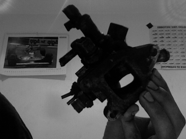

Fan stopped cutting in and she started getting a bit hot so checked lower rad hose - cold. Top hose hot so thermostat was stuck.
Removed stat and was going to smack it thru - always open but decided to buy new.

I had a major issue obtaining this part last year - I nearly had to scrap the car! My post is below just in case the info in it is useful - the photos have now been deleted but th thermostat looked like an artificial heart and most definitely couldn't be obtained by regular British motor factors, including the Halford-Half-Wits. Ultimately I paid about £250 is I recall to get this problem fixed. Next time, it will be a Fiat Coupe engine, I'm afraid
https://www.fiatforum.com/tipo/143489-sedici-thermostat-needed-help.html?highlight=tipo+thermostat

Got to alfa garage by train to find they had got the wrong one in :cry:
some piddly little thing - off a 1.4 i think and i gave them vin too ?? wtf. .
Anyway i asked my dad 4 days ago if he had a old one - er - no its thrown. . .
Asked again today and after some rummaging he found one! result - all on - just finished, made gasket out of card and grease - bled system and its running fine, fan cuts in/out both hoses get hot and hot air thru blower :slayer:
