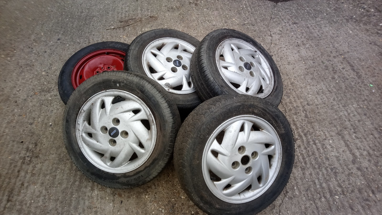

I have just sold a set of GT 14's but have a set of 1.6 Sporting ones available...
https://www.ebay.co.uk/itm/263569446669
...if that's any help. As stated above no 176 Punto was sold with fifteen inch wheels as standard.

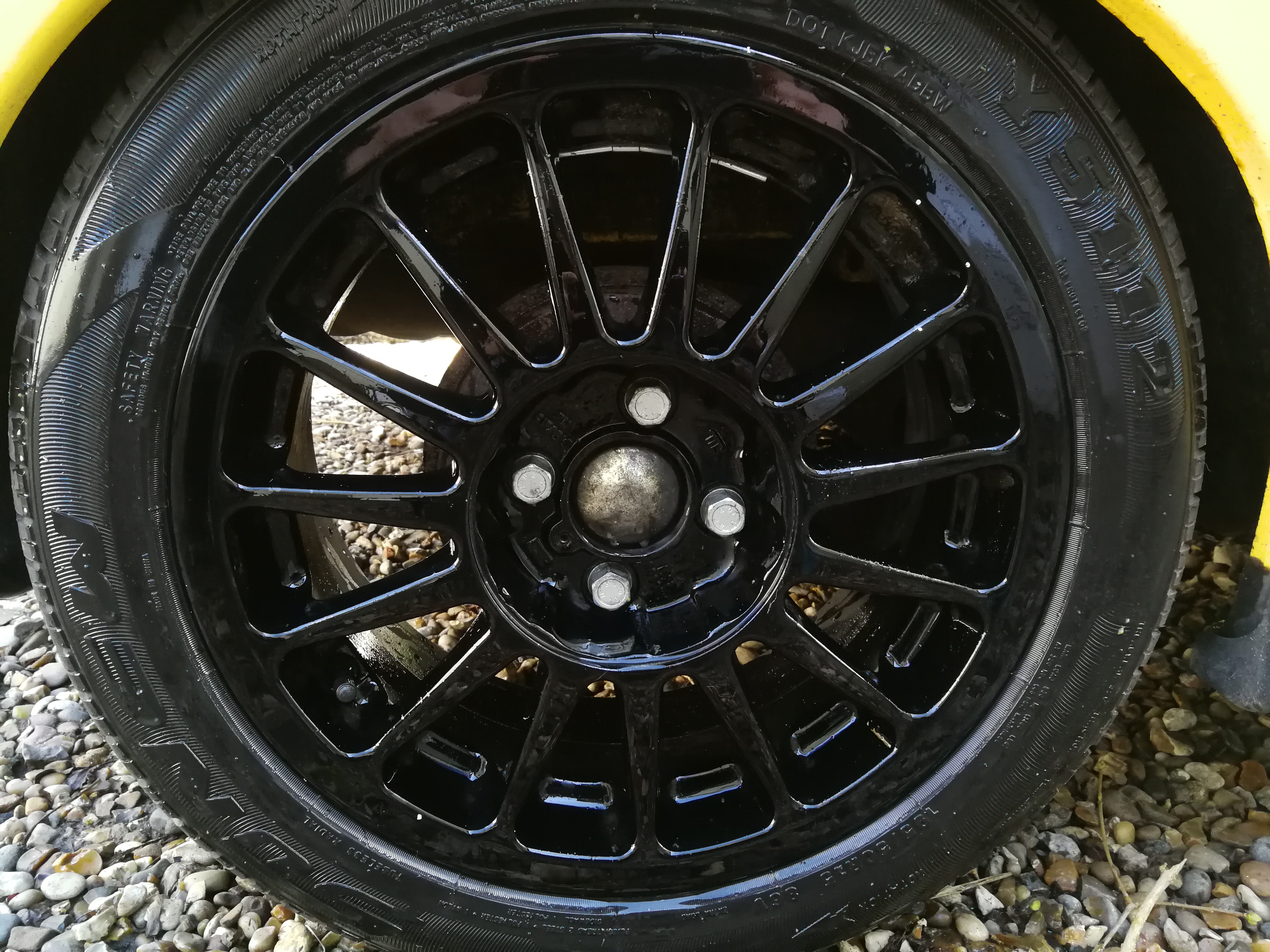

Thanks for all your help, here is a picture of the alloy

Forget the 15" wheels, they are totally wrong and the insurance company is doing you a favour by rejecting this foolishness!
The alloys in Liquid Knight's post aren't factory Sporting but they would do fine.. they look like from a Seicento or maybe the Fiat "Brio" accessories range?
They actually look a bit like the 14" spoked design that was on the earlier 1.6 Punto sporting Mk1s.
Anyway make the effort to get the genuine tyre sizes to avoid any insurance issues... Fiat knew what they were doing when they designed the cars. You've now got the chance to right someone else's wrongs!
yeah they arent fiat wheels, look like team dynamics wheels, like the old version ofg what is now the pro race 2... think they were called monza? anyhow, 100% not factory or even off another fiat.
