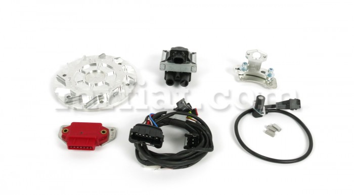

What exact ignition set up do you have, in my old books they started with a simple points and distributor set up (cheap to diagnose and replace) later ones seem to have a variety of electronic systems where faults are not always obvious.
