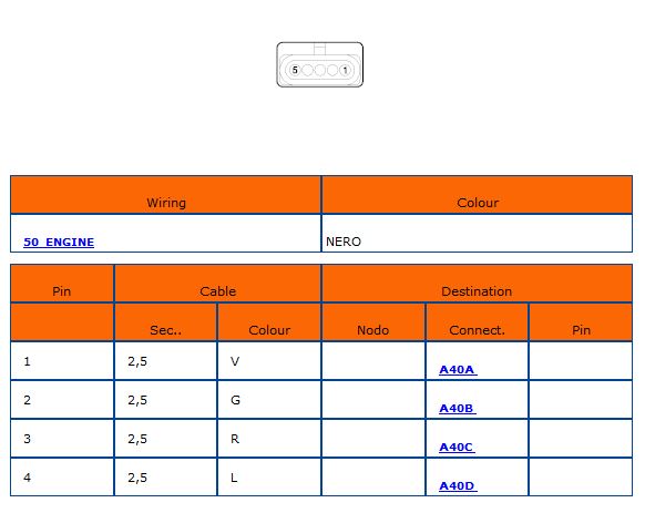

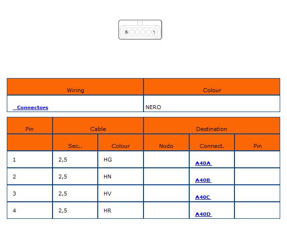

There are only 2 multi-pin connectors on the glow plug control unit. One 5 pin (4 pins used) to the engine management ECU, and one 6 pin (4 pins used) to the glow plugs.
The only 3 pin connectors I can think of in that area are the water in fuel sensor on the side of fuel filter head, and the fuel pressure sensor on the fuel rail. If the 3 pin connector is on a short spur, then reconnect the 2 connectors to the glow plug control unit and see where the short spur reaches to.

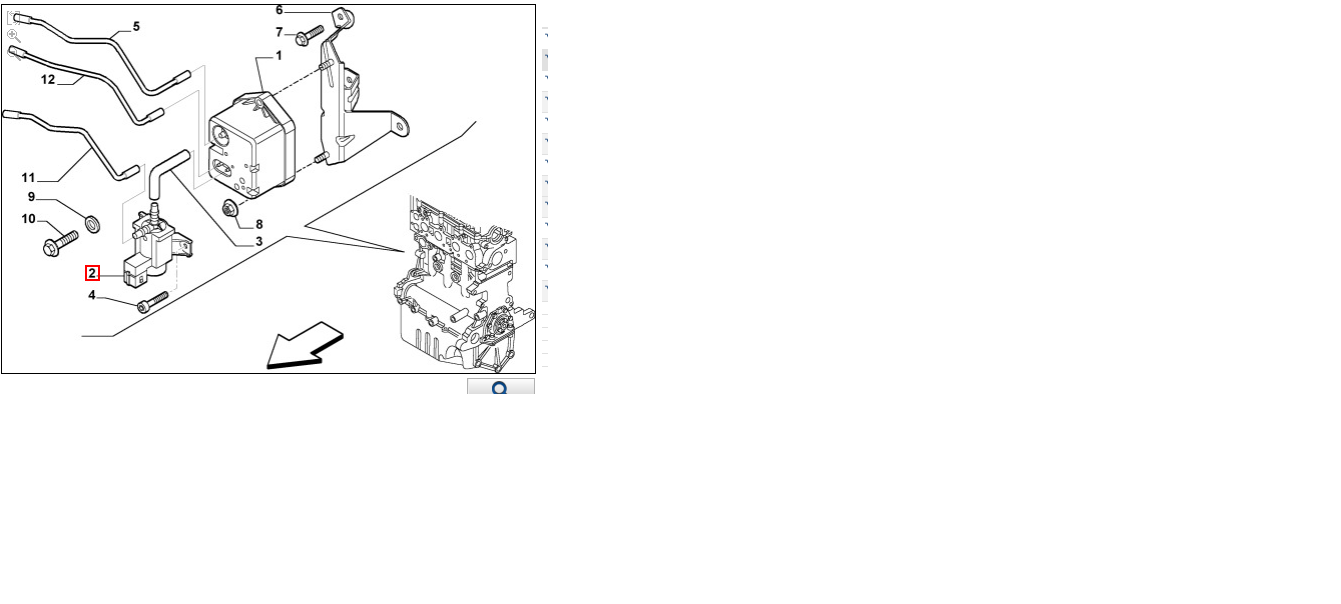

i think theres a connector like that on the vacuum tank, as I had to remove it to get to starter connections.
at least on my jtd 16v , don't know how many pins were in it as I wasn't looking at it.
but it had the wire horseshoe type clip so as others said they wouldn't just fall off unless someone lost the clip previously.
but looking at the pic it has the wire clip still in place.
only take a min to look there , id guess in similar place by wiring to starter motor.
