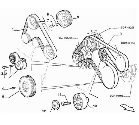

Hi,
My alternator belt recently snapped and I am now attempting to fit a new one.
I have taken off the wheel, and the plastic cover (I am guessing to stop mud etc.) and I can now see where the belt is meant to go.
Even though I can see the position I have no idea how the belt should be fitted, what one is the tensioner.
If anyone has any information or images that might help me I would be very grateful.
Many thanks
Lee
Fiat Bravo 1.9JTD Broom Yellow!
hope this helps :)
thanks...that looks very helpful.
what one is the tensioner?
where did you get this from? is it part of a workshop manual?
Lee
3.2 in the picture is the tensioner. Use a 14 spanner on it to pull it downwards to get the belt on. Requires a good bit of strength.
Would I just put the spanner behind the tensioner and pull down? Is it really that simple?
Lee
Not behind, the tensioner has 2 roles, one is metal where the holding screw goes and one is plastic. The spanner goes on the screw that holds the plastic one and you just push it down, slide the belt on and let it go - thats it.
The tensioner is automatic.
