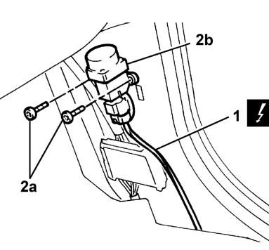

Just a thought, they have pushed in the fuel/ignition shut off valve reset button haven't they??
Otherwise, definitely an engine management problem of course, but that doesn't help you very much and if your guys can't get any fault codes then i would imagine some changing of expensive bits coming up
