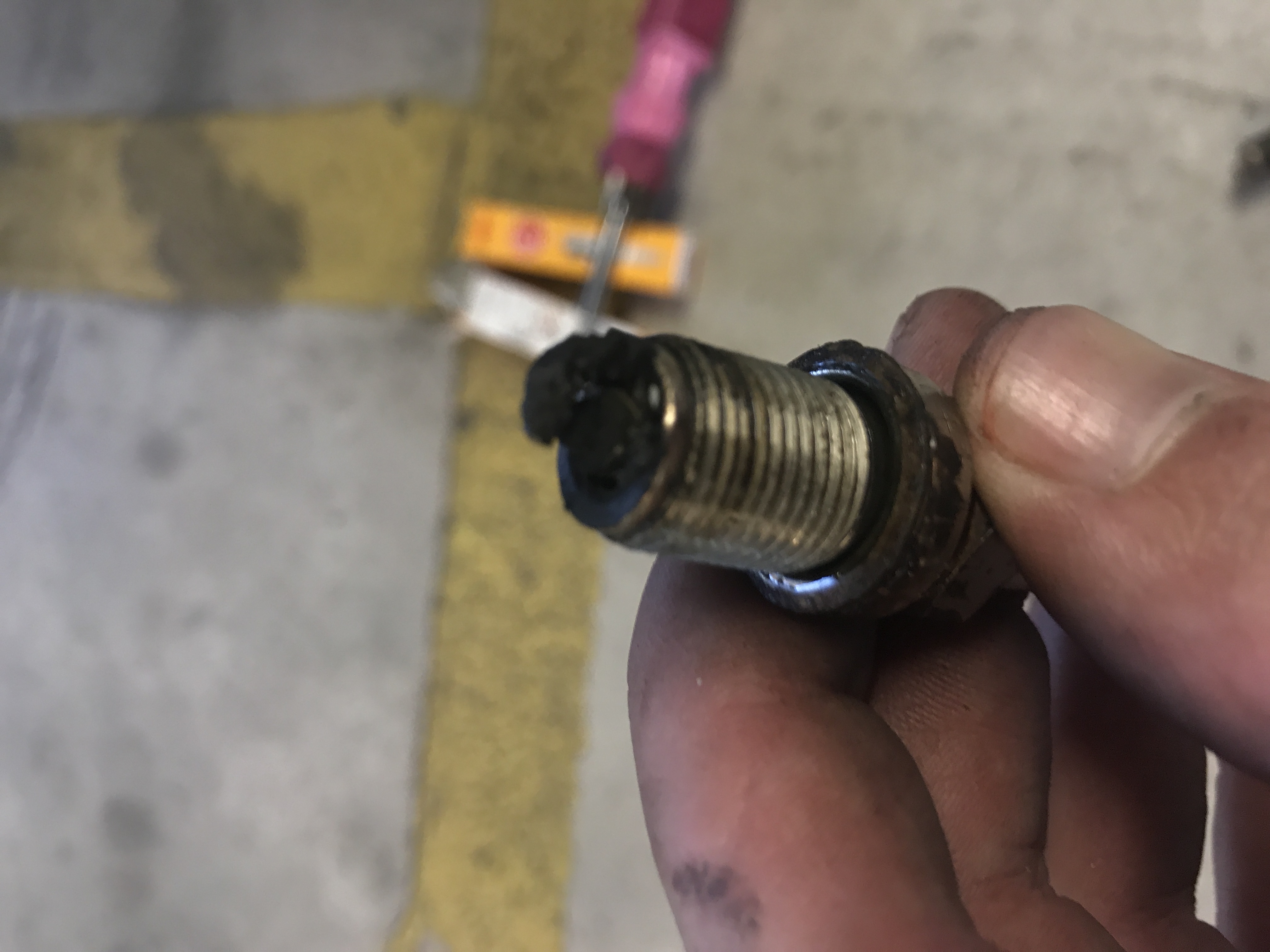

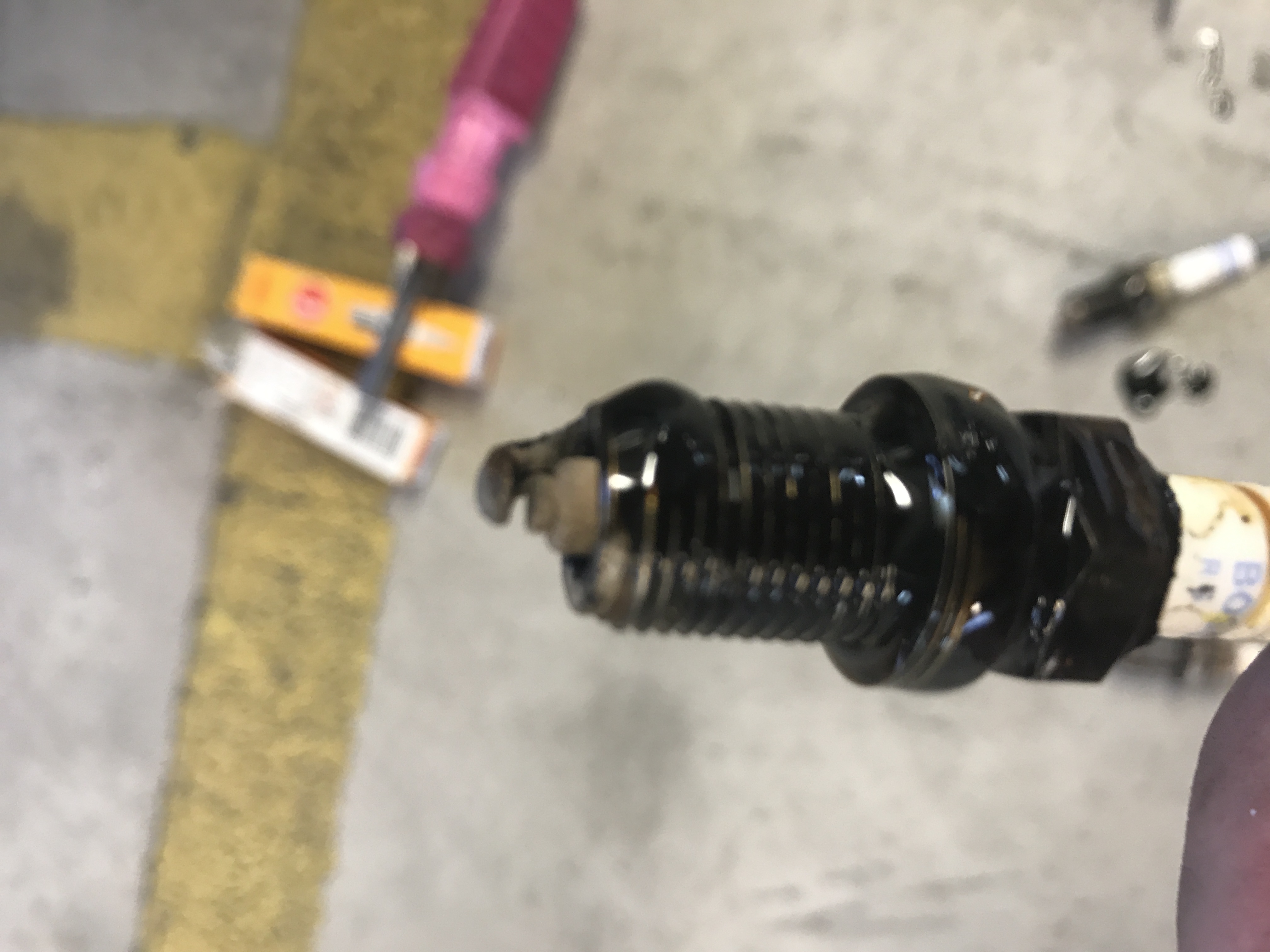

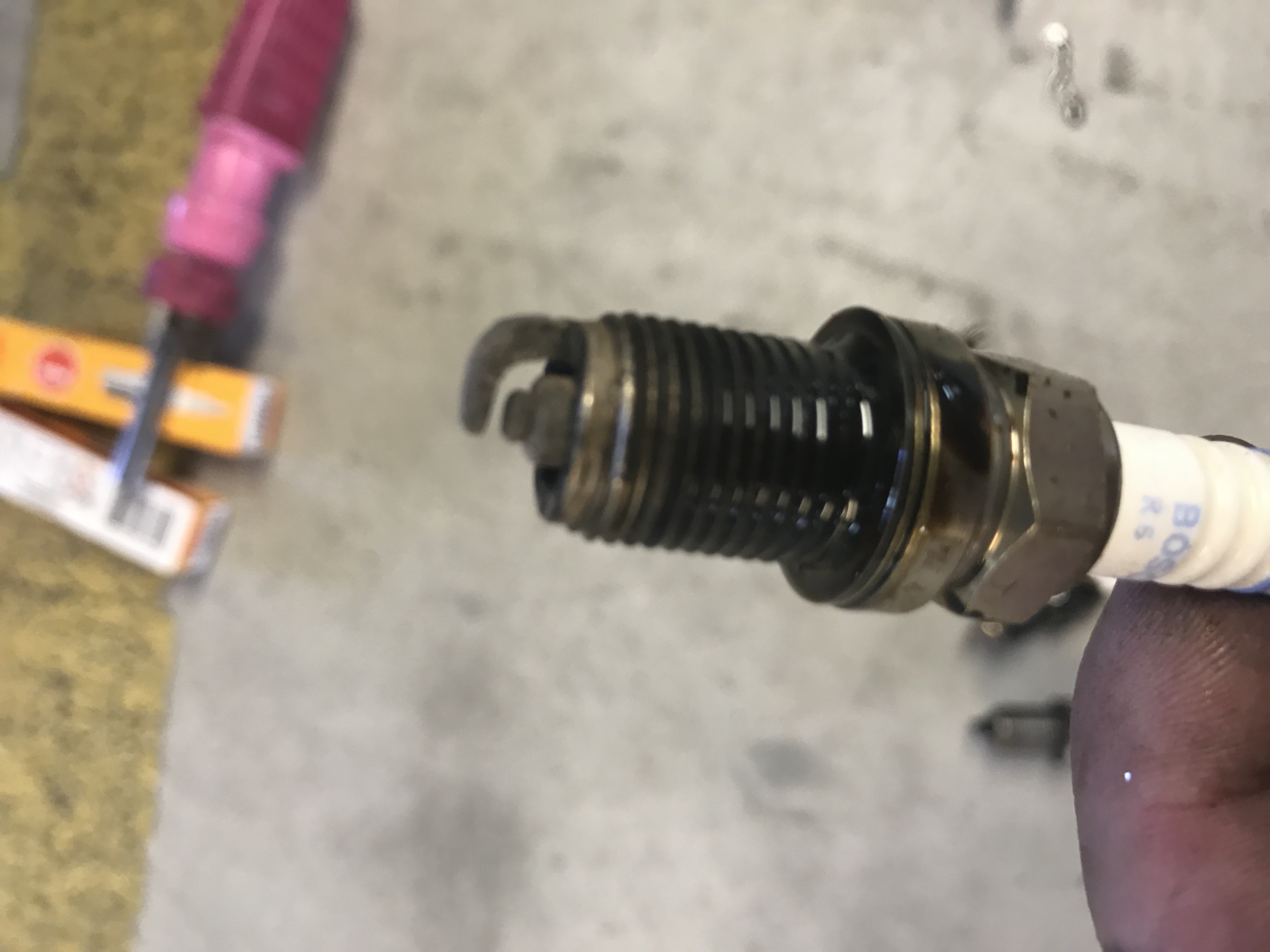

Took the plugs out today and here's what I found!
I couldn't get number 4 out as whoever changed the plugs last time had conveniently cross threaded it ?

One of those plugs looks absolutely horrendous!
I don't see the valve stem seals causing oiling on such an industrial scale. On the face of it, that's pointing to something more serious around piston/ring area.
Indeed and another of those really doesn't look great.

There's a lot of oil on the upper part of those plugs.. so if the plug holes are full of oil, then oil is leaking out through the rocker gasket. The leak could account for some of your oil loss.. but not to the extent you're losing.
The first picture looks nasty though and that's my contender for indicating where the problem lies. All the plugs should look like the other two photos - apart from the oil all over the plugs above the threaded section, they look perfect.
If you/someone is confident enough to take the rocker cover off, you'll be able to clean out any oil from the plug holes... and also have some kind of peep at the top of the valves, particularly the one with the sooted plug. It's tricky to see the valve stem itself (under a tappet and under the camshaft) but if it's in really bad shape, some of the seal may be hanging out.
