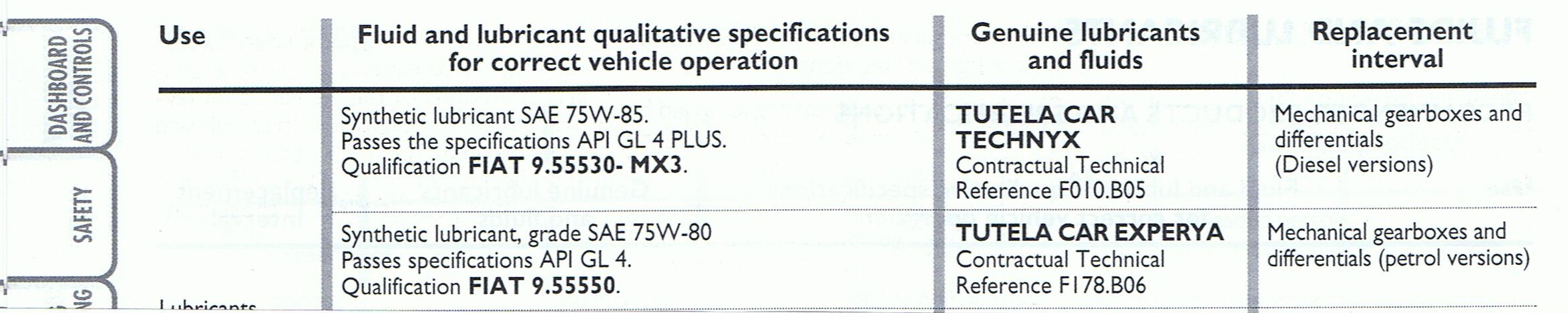

i have 2013 Fiorino 1.3 MJD, 75hp car version of the van, with the auto 5 speed gearbox.
i dont need to change my tranny oil now but am trying to spec out which oil i will need (later) because i think inflation is about to go bonkers.
my book shows 2 specs for diesel trannies...i think i have successfully uploaded my first picture to this site (not sure if i have permissions yet)
which one do i need? are they the same?
thx

Hi Nedro,
I've just checked my handbook and I think you have a typo error in yours. :confused:
My handbook shows the Tutela Car Technyx F010.B05 for Diesel versions and the Tutela Car Experia F178.B06 for Petrol versions. (Not Diesel).
