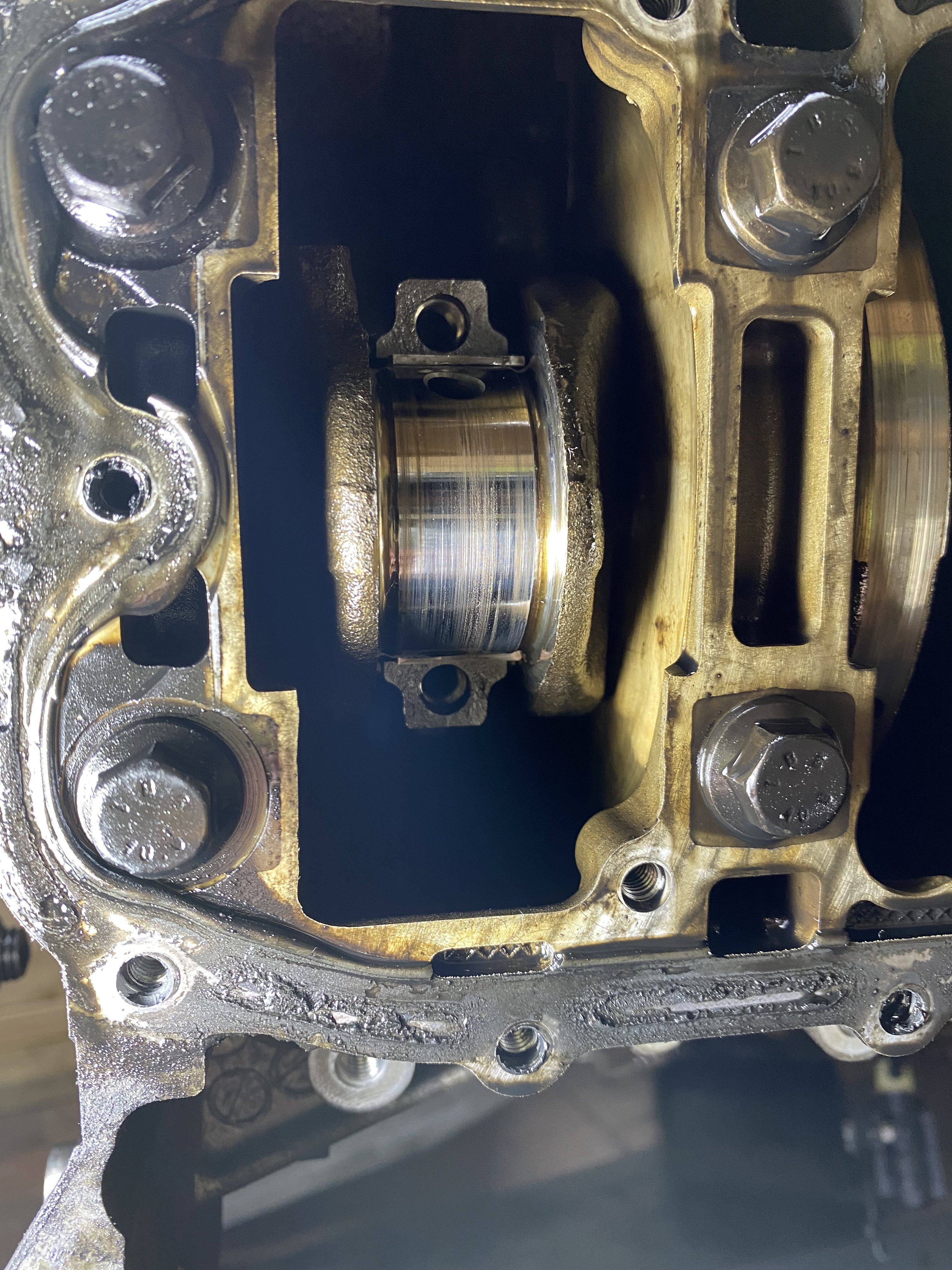

The crank needs to be reground or replaced

The whole engine is scrap really by looks of it really not worth spending big money on these when you could get a second hand running engine and put a new chain on it
The engine parts aren’t that expensive. A second hand engine is about a grand & who’s to say that will be ok. To be honest the car is only good for scrap at this point but I’ve never completely stripped down and rebuilt a Diesel engine so it’s more of a learning experience now.

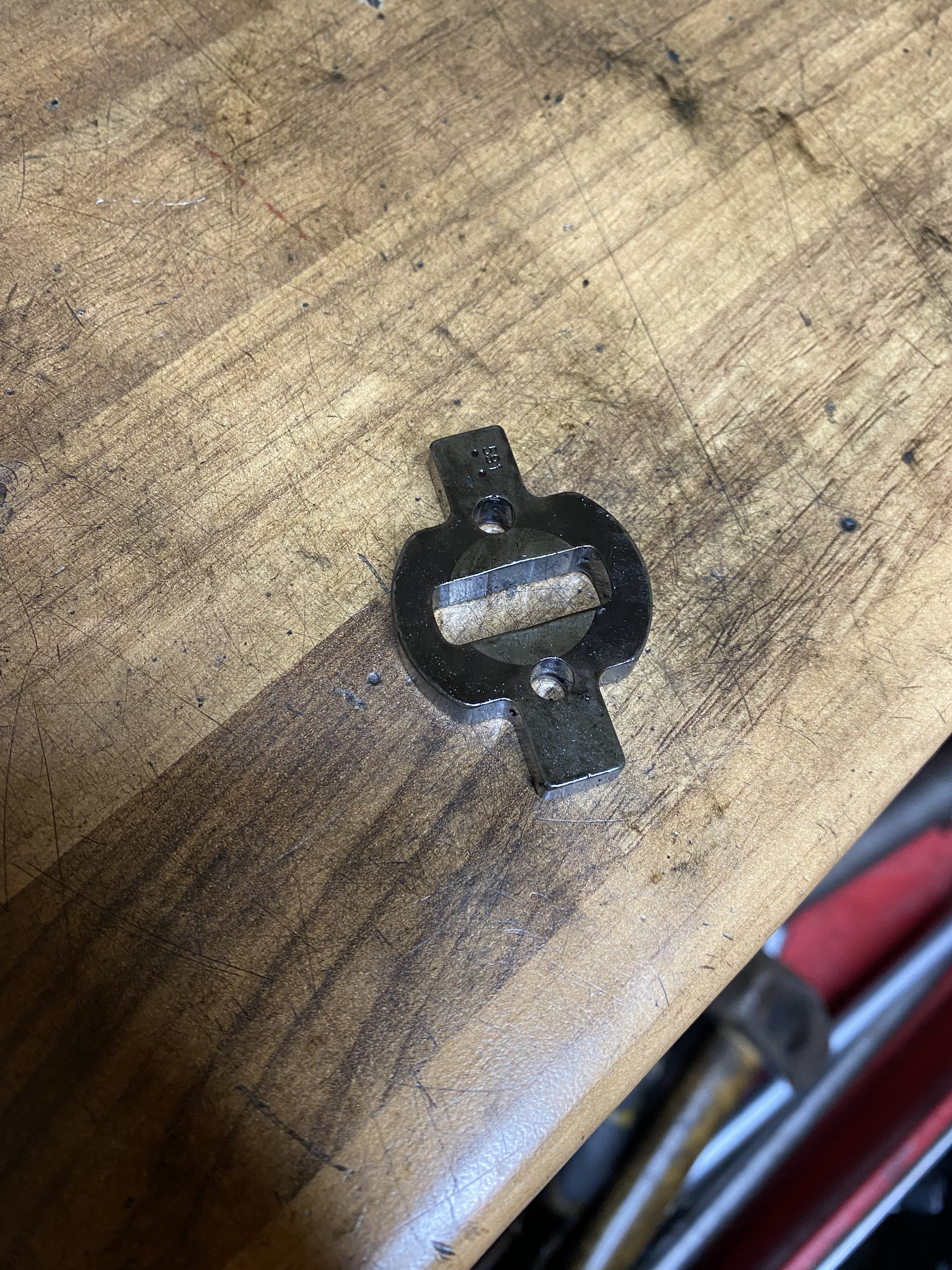

It’s off! 2-3 minutes of map gas and my new impact cracked it but not easily!
It did however knock this small part out from somewhere on the engine & I have no clue where from, can anyone help identify it?
