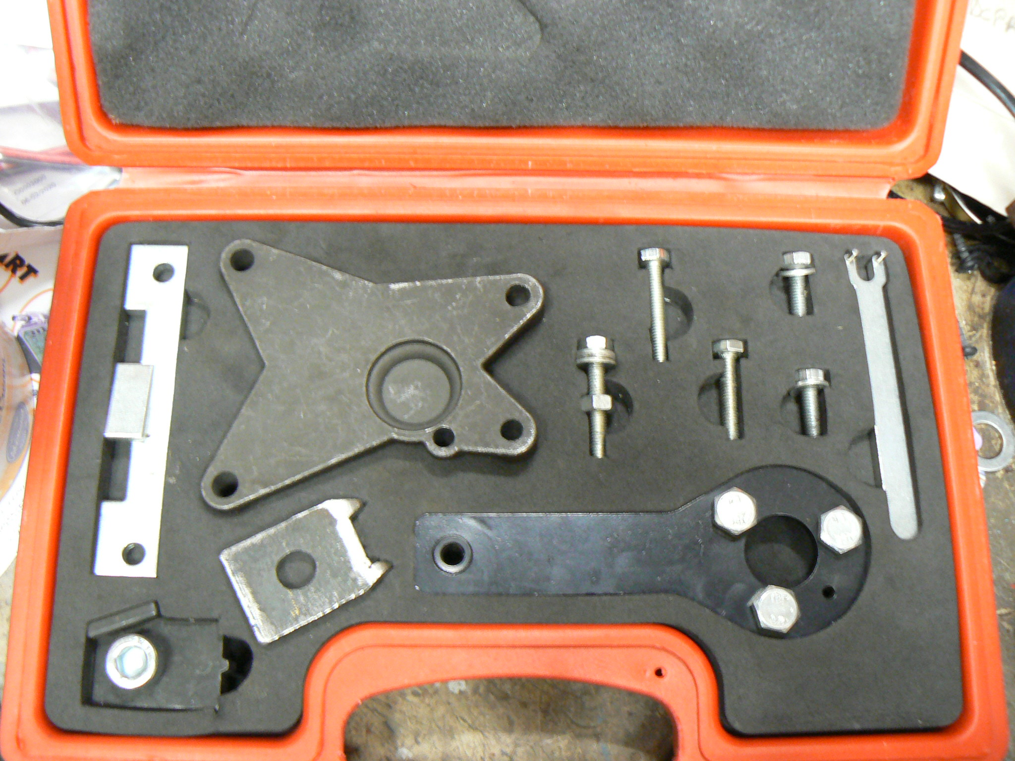

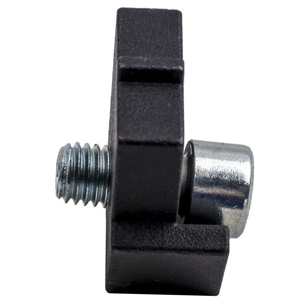

Koalar is telling you just about all you need to know about the locking tools. The top kit you show is the one you want for the 8 valve engine as it includes the wee locking block for locking up the VVT top sprocket if you ever undo it's retaining bolt. However if you decide not to undo the top sprocket bolt then you just need the crank locking tool (round end with 3 bolt holes in it) and cam locking bar (with angled locking face which fits in the slot on the end of the cam) and maybe the two pronged tensioning tool, but you can get round it by using something like right angled circlip pliers.
Here's a couple of pictures of the Neilsen set I bought:
I've noticed that some of the manufacturers of these kits seem to get very confused about which engines their kits fit. In fact you'll notice mine says it does the 16 valve engines - it definitely does not - You need the bottom kit with the two rods in it which go down the spark plug holes so you can set the engine with all pistons at "half mast" and the two screw in cam locking tools. The second kit you show is missing the top sprocket locking block (as I mentioned above) and if you look at my last picture, bottom left, that's it with the silver coloured Allen (hex head) bolt. By the way, at it's 2 o'clock you can see another wee block which is actually a flywheel locking block I made up and is not part of this kit - It's just a convenient place for it to "live".
Koalar is talking above about "cheap" kits and if you really want to save money, have decided not to slacken the cam sprocket and are confident in what you are doing, I've seen offers for just the black crankshaft and silver cam locking tools on their own - you could then use circlip pliers - or similar - on the tensioner and do it very cheaply. If you've any doubts about the cam timing though you do need the whole "shebang". On reflection, it's not a lot of money, just buy the complete kit. Do a couple of mate's cars and you'll be in pocket? Of course if you need to change the cam seal, as Koalar says, you're going to need the whole kit anyway.
