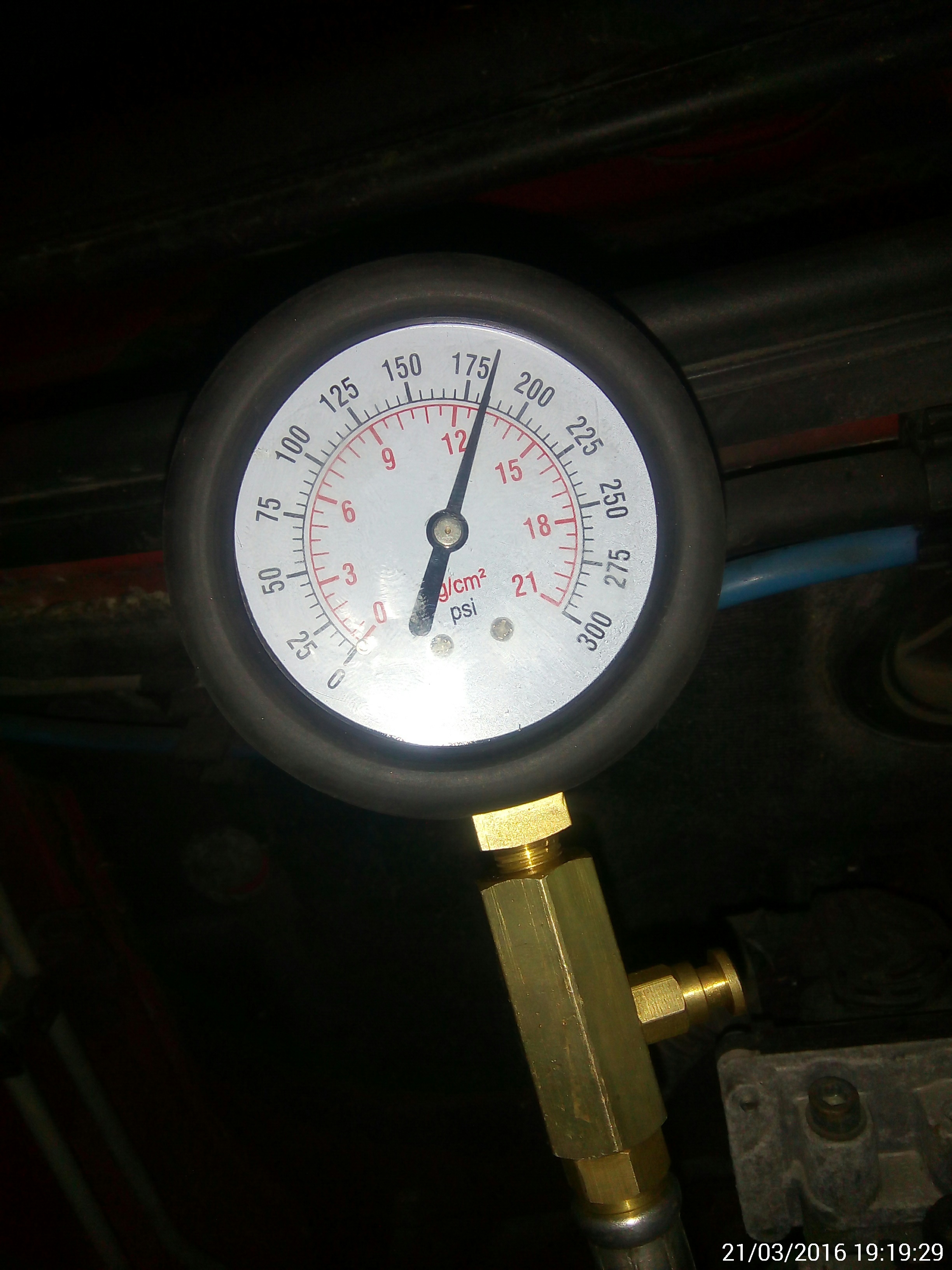

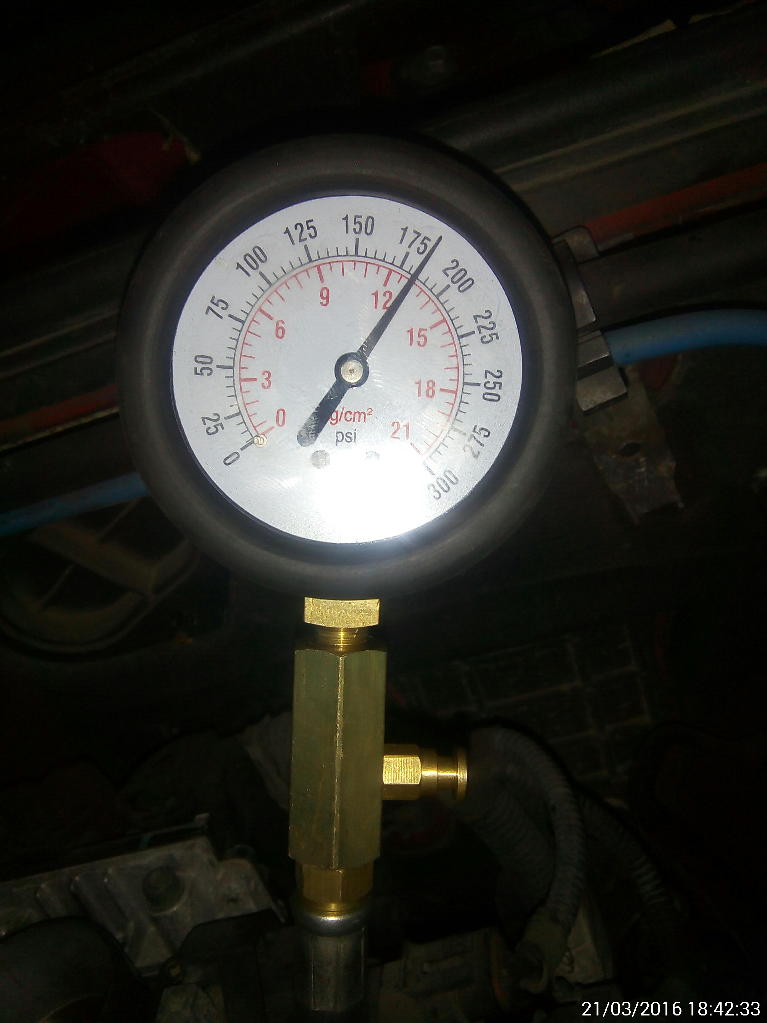

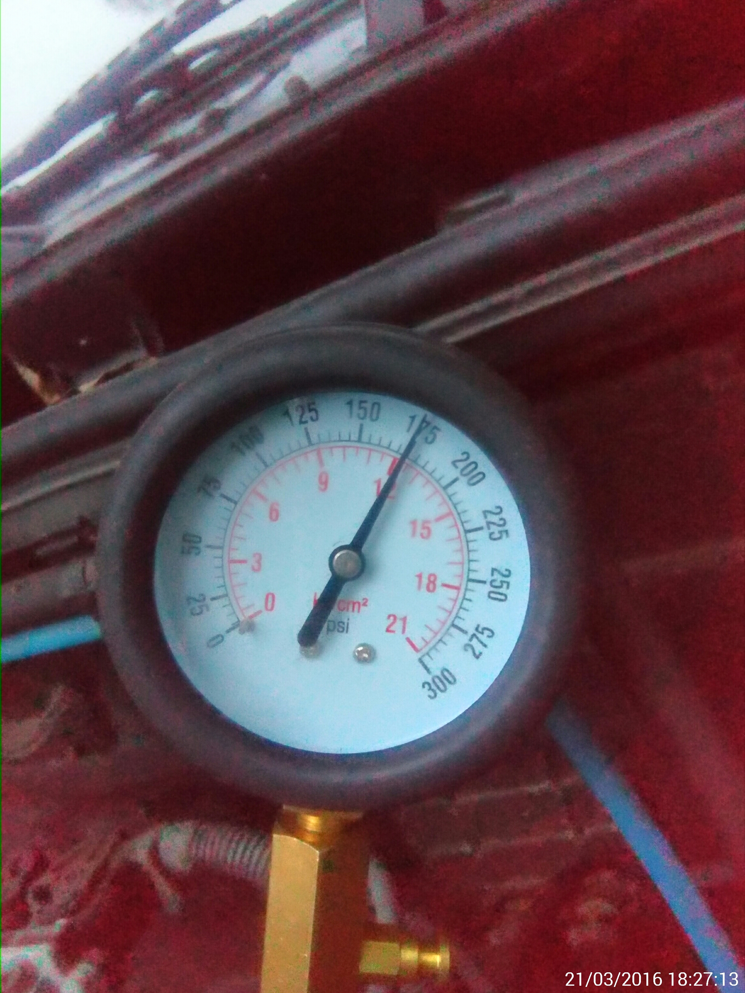

bought this 8v supposedly with bad hg, changed battery car started in first try, measured compression (dry) and it was around 175 psi or 12 bar on all 4 cylinders
car was almost cold, car doesnt lack any power
is that normal compression?

I had a carbon coated pistons givong 200psi on my first engine
When cyl1 failed
I fitted a replacement lump, it was much better running obvs
But only had 160psi all over
Didnt change with oil
So I suspect 175 is good with a little carbon :)
As long as hg hasnt gone oil and water, shud be okay
Ziggy
Reckon your good with anything over 150 and all close together. Lot of variables with a test and even when you can find manufactures specs they tend to specify a range of 50 psi with no more than say 20% difference between top and bottom.
Mine was 160 ish and my head gasket wasn't gone as you know so I think 175 is fairly decent on a cold engine.
