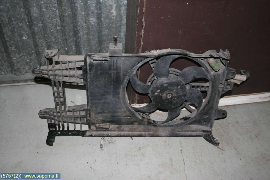

On my 2004 1.2 16V I think the radiator fan shroud is supporting the water radiator on the same support the A/C condensor uses. I dont think it is possible to remove the fan shroud without pulling the condensor up to release the bottom of the fan shroud.
It is impossible to see what is actually there at the moment and I cannot find any pictures of the parts. I just know when I tried to take the radiator fan shroud off it was much more difficult than I had realised.
So when you look at the fan shroud it seems the water radiator is supporting the fan shroud but I think it is the other way around.
I found a picture of my type of fan shroud. The A/C condensor is supported on those plastic legs. (The feet on the water radiator must be fitting into the holes in the metal radiator support bracket).

My arrangement is very similar to what you are describing.
The fan shroud attached to the back of the radiator reaches under the water radiator to support the condensor via the two plastic legs on the fan shroud. The fan shroud then supports the top of the condensor with some plastic fittings which are screwed to the fan shroud and are just resting on top of the condensor to stop it moving around
