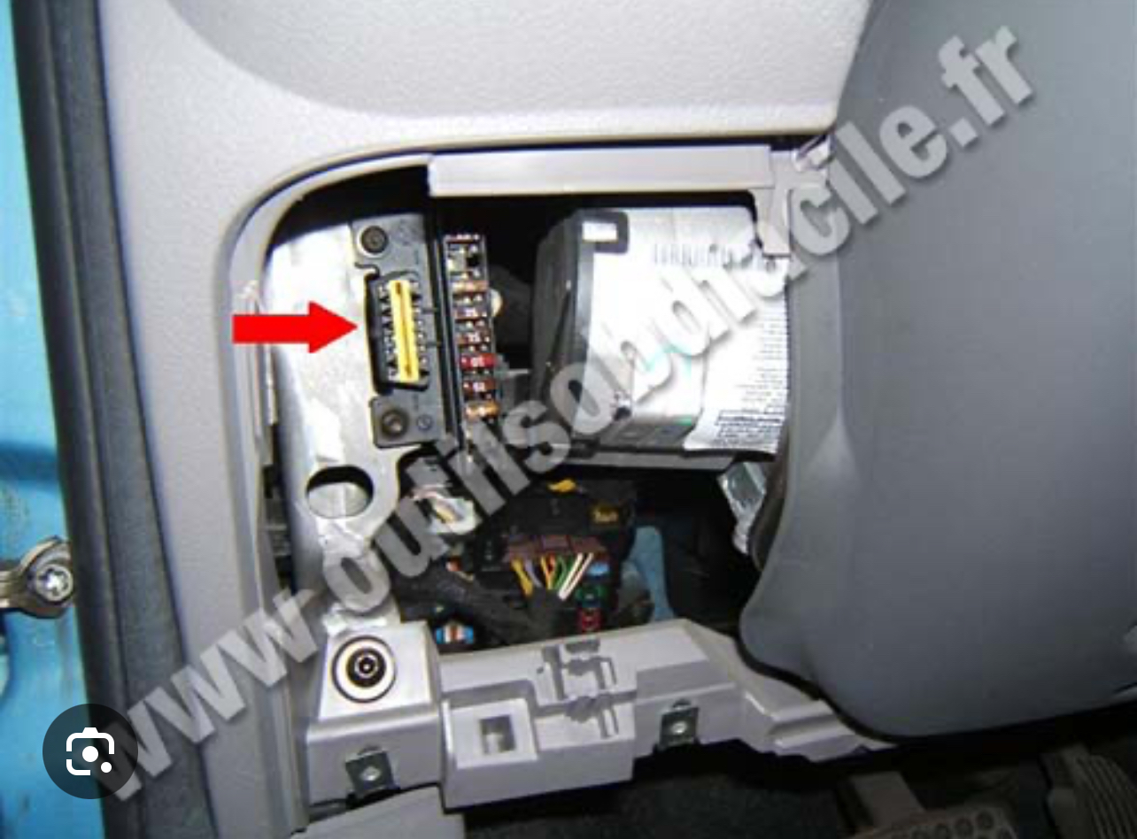

It may be worth checking with diagnostic machine what the coolant temperature sensor is reading when cold, as it gives it more fuel for cold starting.
I'll give the pedal one pump a try! Fortunately the car will start eventually.

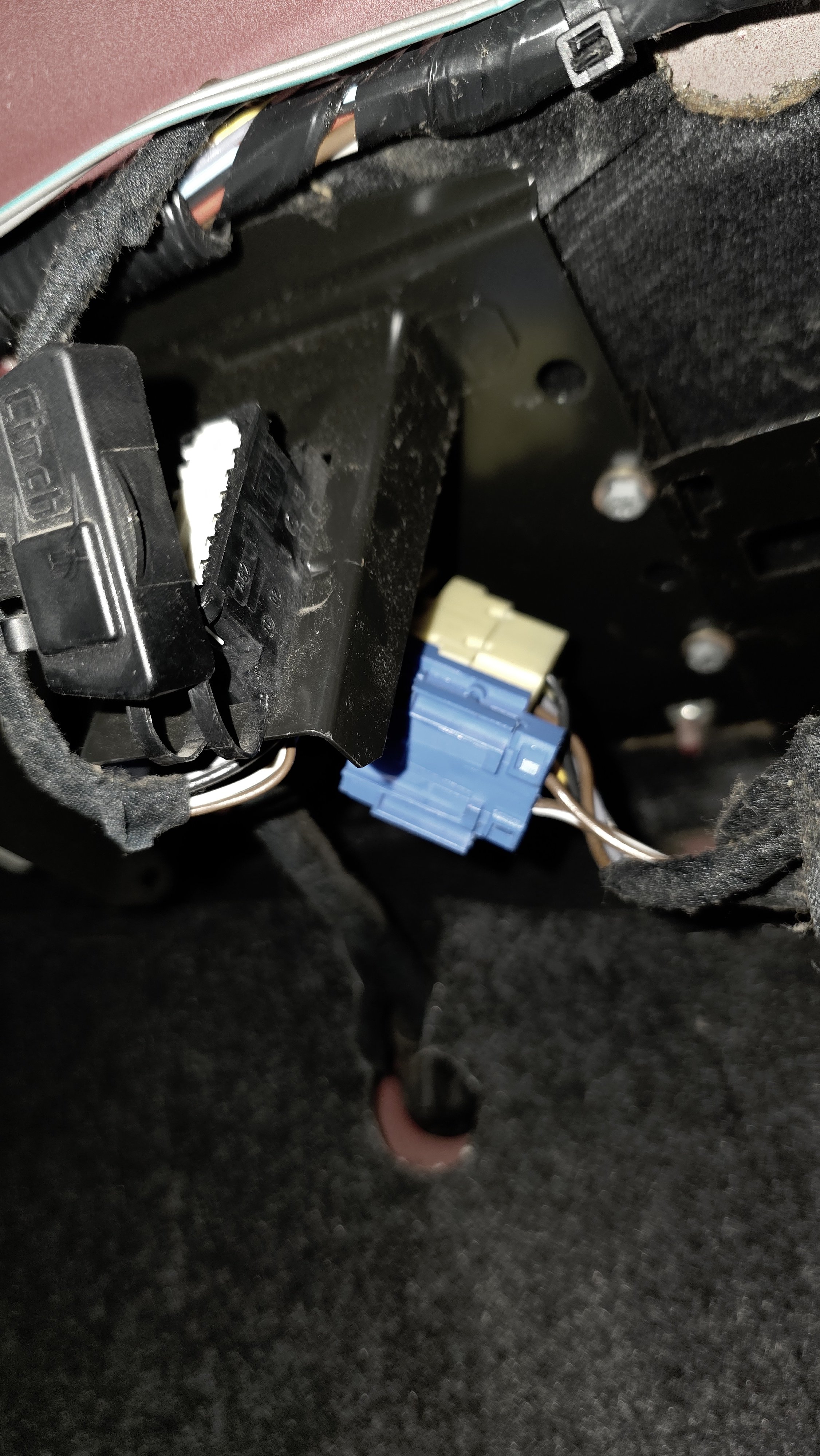

I assume its the obd1 port correct? I only have obd2 hardware so I'll have to source one stuff to read the obd port. I'll give that a try and report back.
Thanks!
Yup, found this. Is this supported by the obd2 protocol? I always thought obd1 and 2 have the same physical interface. Wasn't able to research much information about it.
If so, I'll plug in my scanner tomorrow and see.
