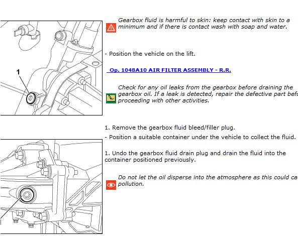

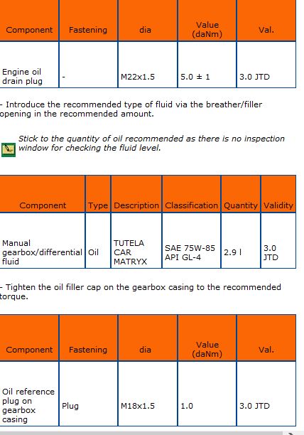

Hi looking for info to drain and refill transmission in Fiat 3.0 multi jet with comfomatic. Where are the drain and fill plugs, how much oil required. TIA.
From the X250 eLearn.
From the specs it takes 2.9 litres & as there is no level plug you have to fill with the correct amount. From the diagram & description the filler plug must be located under/behind the air cleaner & the drain plug is located under the final drive casing. The comfortmatic transmission from what I have read uses the same gearbox as the manual version.
