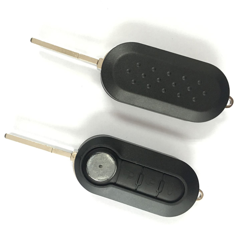

Hello lads and ladets.i was wondering has anyone changed theyr key shell?mine is now splitting apart ad i want to order a new one.by any chance does anyone knows a decent place where to buy them?and is the tracker chip/pin located on the main michroscheme or somewhere hidden in the shell?i disassembled it to look at it but wasnt actually sure.

The immobilizer chip is on the main board.
You can get a decent shell from aliexpress.
https://www.aliexpress.com/store/product/KEYYOU-Key-Case-3-Buttons-Flip-folding-Remote-Key-Case-Shell-Cover-For-FIAT-500-Panda/1467030_32831414883.html
I have one brought from these guys,
You say your key is still working, then you will need to change over some parts of that key to the new shell.
The shell is basically an entire key.. without the electronics and the blade.
You might have to slightly file down the original blade in order to make it fit into the new holder., or might have to bend some of the contacts of the new shell... but for that price... it's unbeatable.

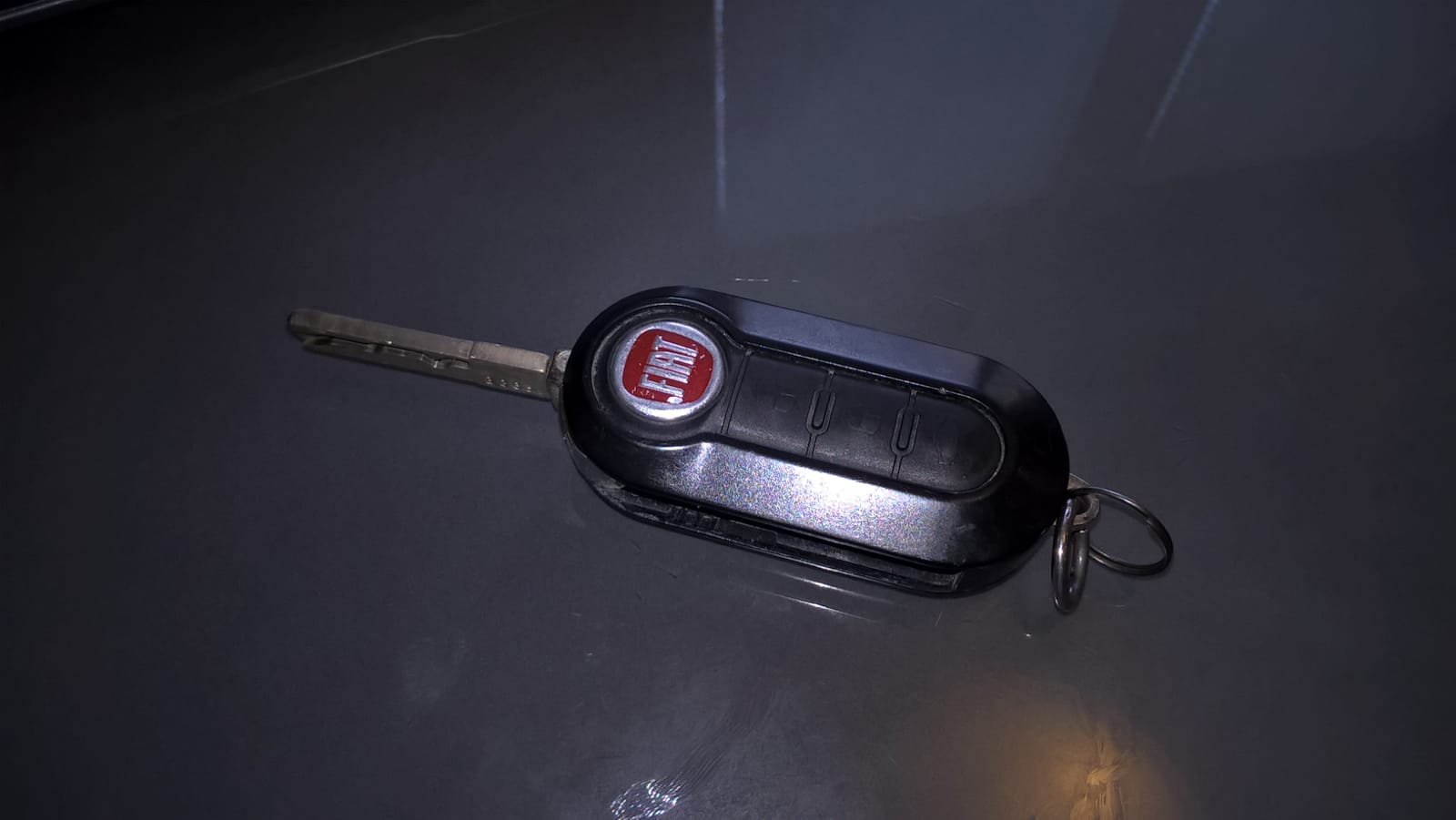

This how my aliexpress key looks about one year in use (and it also suffered a few drops on to concrete):
