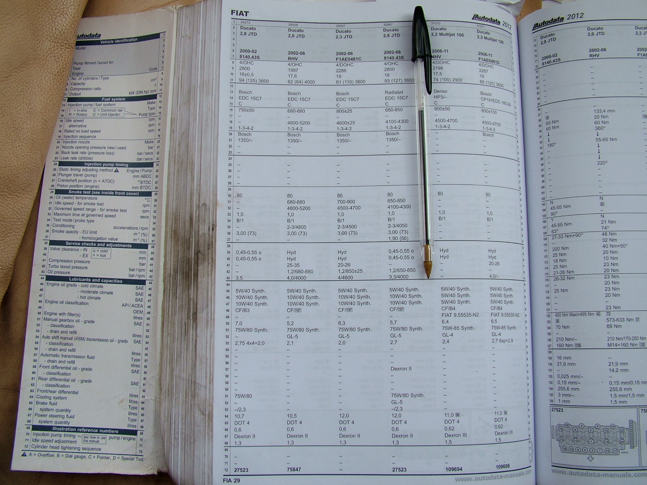

Is this any good, sorry for shakey hand photo, old age, not alcohol honest.;)

While @bugsymike was taking photographs, I was checking on the internet. Assuming an M8 bolt 8.2 grade steel, the answer was 25Nm. The page that I used also cautioned that the figures given were for dry unlubricated bolts. I would be reluctant to go higher than 25Nm.
