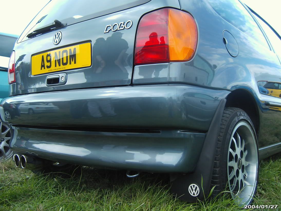

Not a fiat :eek: but its a good example of a good blend that my mate had done. Bit of a colour differnece in the new back bumper so he had to have it blended, can you tell? No-body can!
