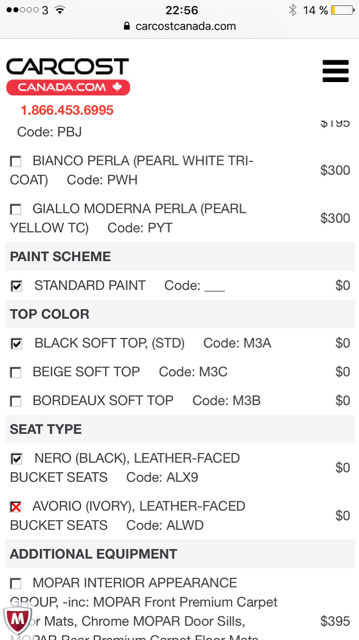

Hi,
Anyone know where to find the color codes for the BORDEAUX COLOR spoiler on the 500c?
Thanks :D
I think it is 1WC13KC8AA partnumber and bordeaux is colorcode M3B...
but want to hear from you guys...

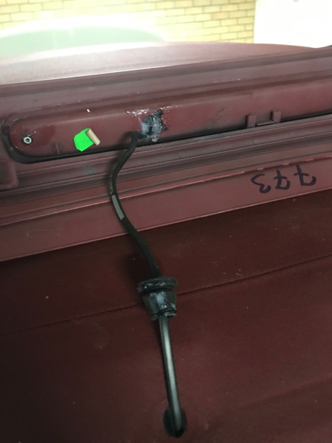

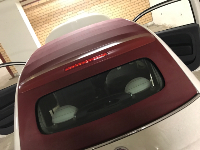

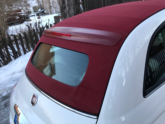

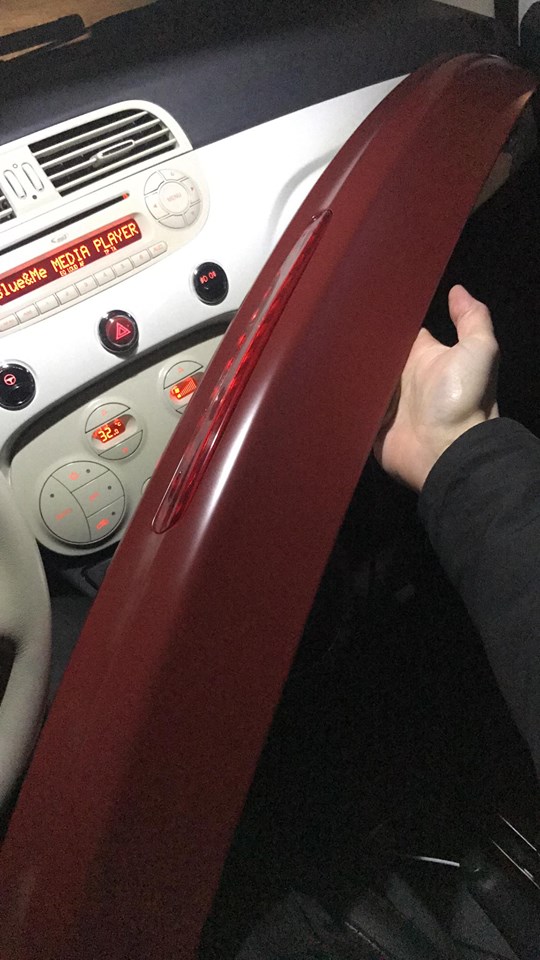

I have gotten the part back from the painter and it looks so good! :D
I have used another paint code that FIAT is not disclosing...
(n)
I will make a writeup DIY soon. :slayer:

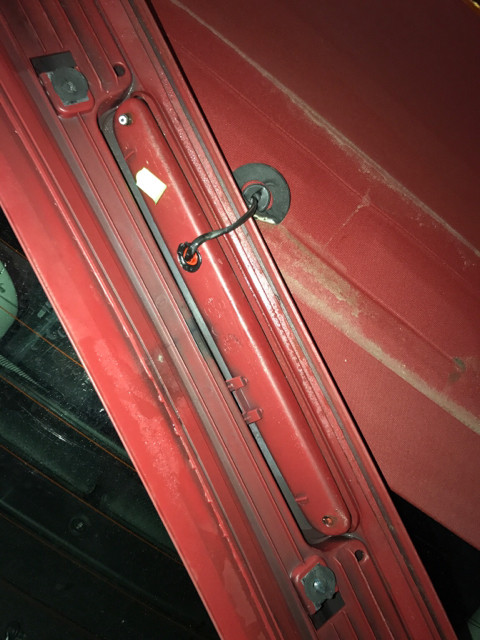

U need small torx ratchet T-25 and T-15 i think it was. Pair of scissors.

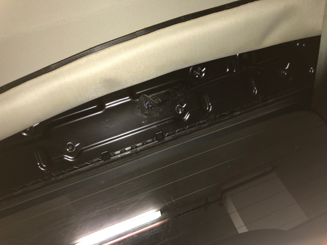

1. Remover inner roof lining. Start at the edges of the window (bottom) and work your way into the middle. It is like a black plastic edge you have to wedge out. Fold it upwards so it is out of the way.
2. Push out the connector on right sight. White.
3. Cut the plastic (black) 4 pcs that holds the cable tight
4. Unbolt: 4 bolt t25, 4 bolt t15
5. Go to outside of car and remove the wing.
6. Clean the roof now when u can

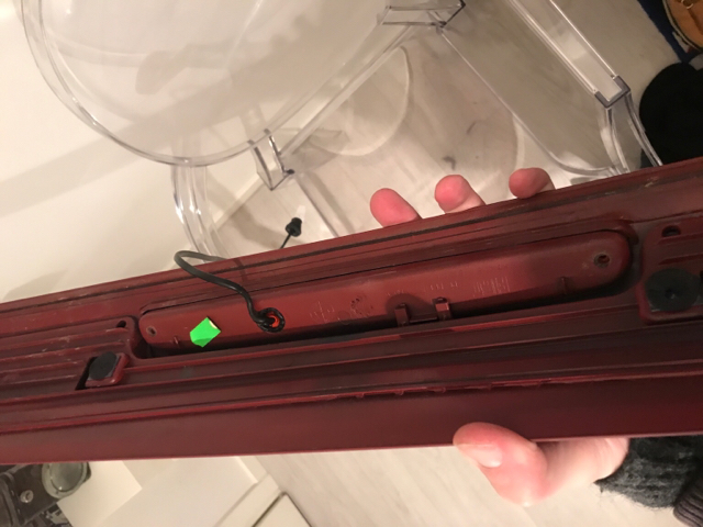

7. Repaint with color "Renault 773" matte with clear coat. Remember to remove the breaklight with 2 T-10? Bolts. Then the painter will be able to paint better.
8. Get some transparent silicone to prevent leaks.
9. Use silicone in each hole in the roof. Also in the hole from breaklight to the spoiler. Remember it can fall through on the other side so beware. Have someone on inside to smear it out.
10. Bolt
The wing. Start with one bolt but do not tightening too much. Then do another on the other side. Do like a cross pattern and tighten little by little.
11. Connect the cable.
12. Use black zipties
13. Push roof lining back in again. Start from the middle and work your way out.
Enjoy!
Just a few notes after DIY this week.
3. You definitely don't have to cut the zip ties. Just remove the whole two plastic holders with pray (trim) tool for car fasteners a then push them back. Trim tool is cheap and widely used when DIY.
4. Unbolting 4 bigger screws with T25 is not recommended as they don't hold the roof spoiler. Only those 4 smaller with T15 is necessary.
