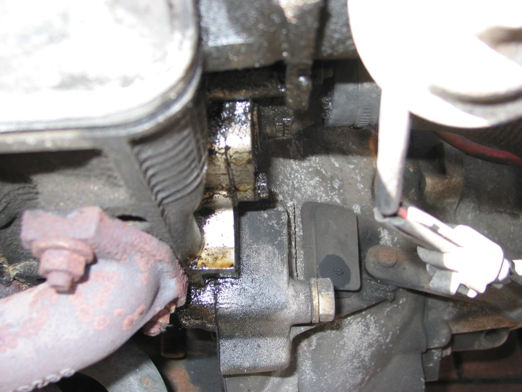

Take a short drive and check for leaks. – check after a day or too and you should be OK and not see like below:
