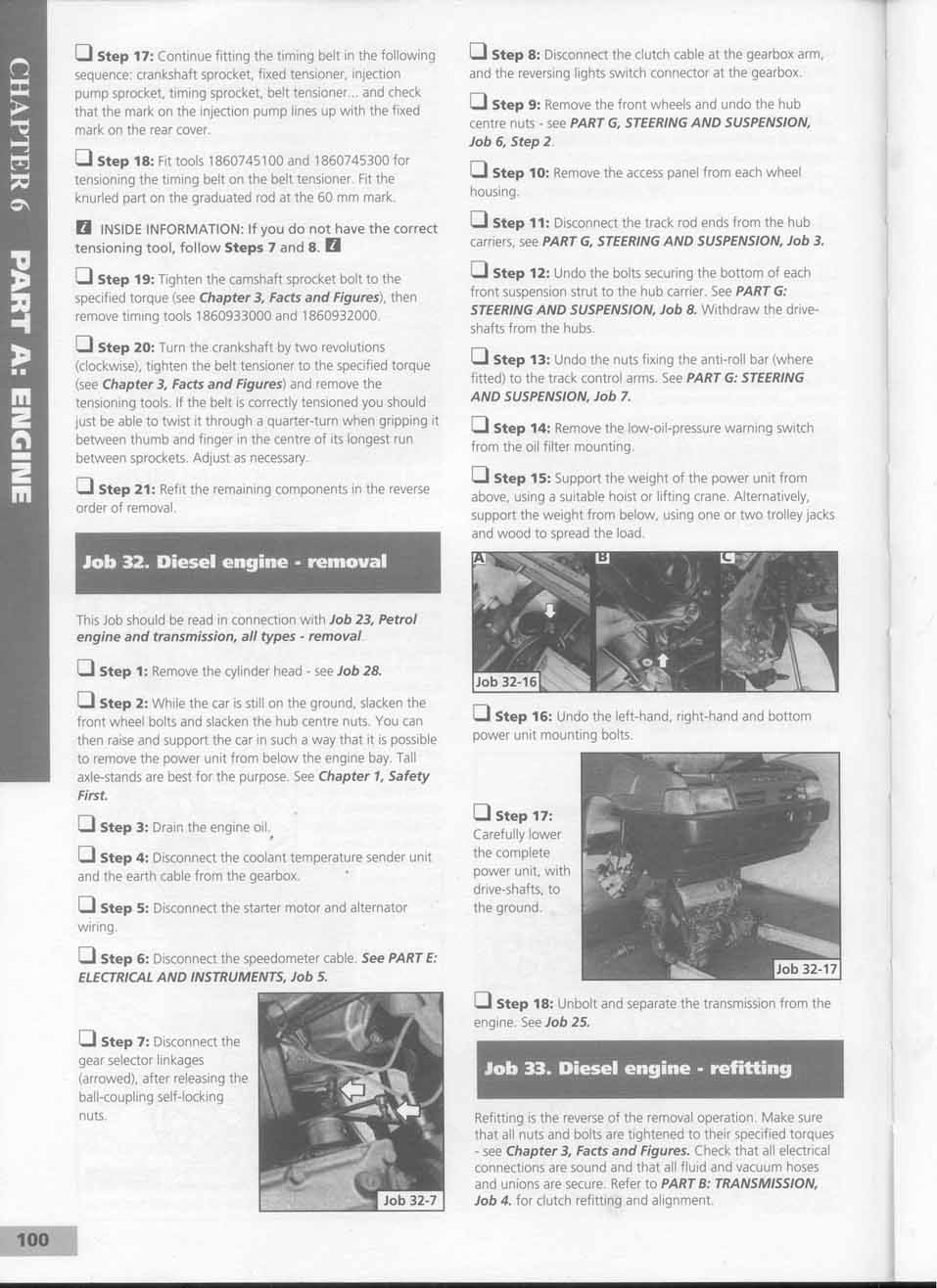

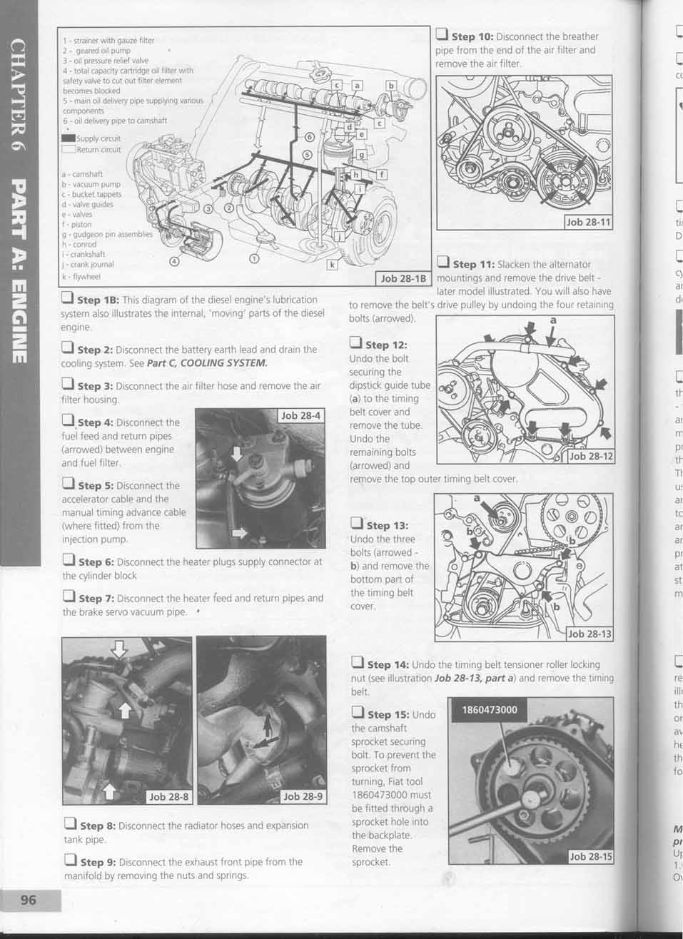

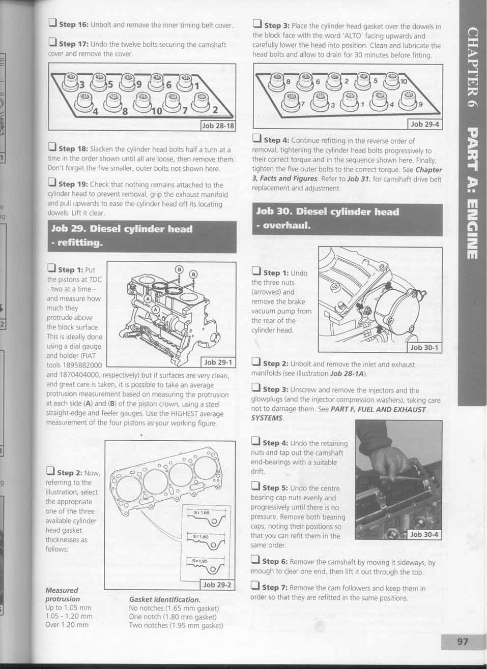

;) This may help.
:) Extract from ISBN 1-899238-23-9 FIAT Uno Porter repair Manual. They really should print some more!
:bang: Last page my next post – hit limit LOL.
