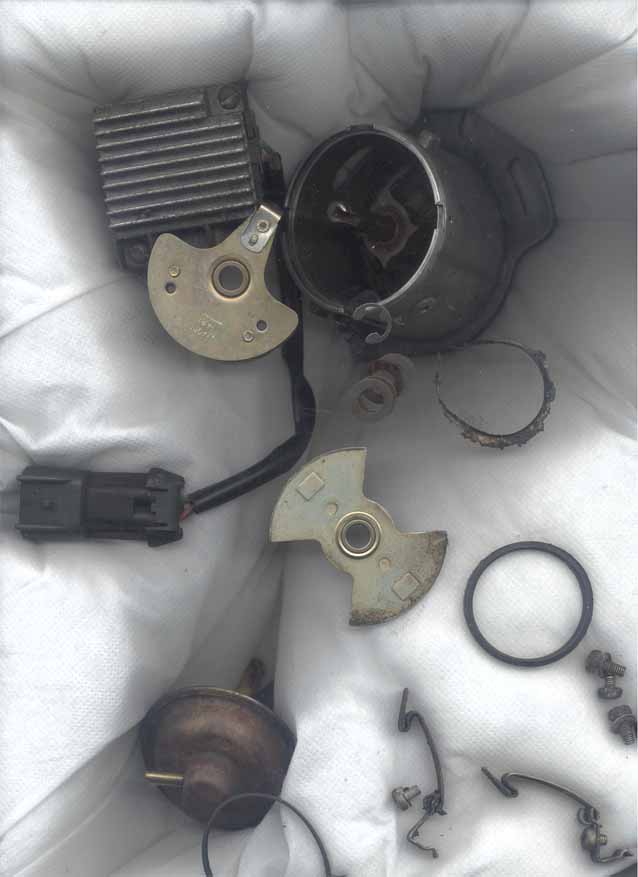

Back to the OHC 999 FIRE, from what I can make out only the Injection models have brakerless ignition (No mecanical points) – could be wrong. There should be a points’ gap inspection window on the Merilli. I presume there will be a condenser somewhere? I couldn't tell you if the symptoms would be the same if it were faulty.
Speaking of Distributors, I'm just working on the brakerless one I pulled from Spam0r's Uno . I’ve just replaced the O Ring gasket which AlexGS tells us kills the clutch if not fixed – (middle right on attached). I think Ill post my questions on that thread soon (to keep on the topic…)
