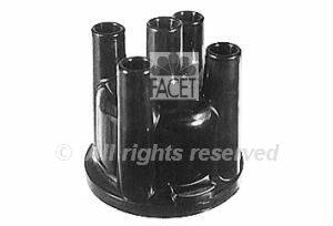

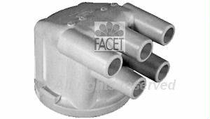

I would suggest changing the distributor cap as well, it is some 10 - 15 EUR and its timely renewal can saguard you from similar stealing gits in the future. I did this long before the cap was gone for good.
Your 1,4 will be using one of these two caps:
Guys you are right. Today I bought new rotor arm and the cost is 2,4 EUR. The guy in scrap yard yoused opurtunity to rip me off, since stores were closed that day. About distributor cap, I changed it last year, so the cap should be ok. Now I will place the new arm on the rotor, since it is new and the one from scrapyard is a bit different becouse it belongs to older model of tipo. My new rotor arm is from FACET as well.
