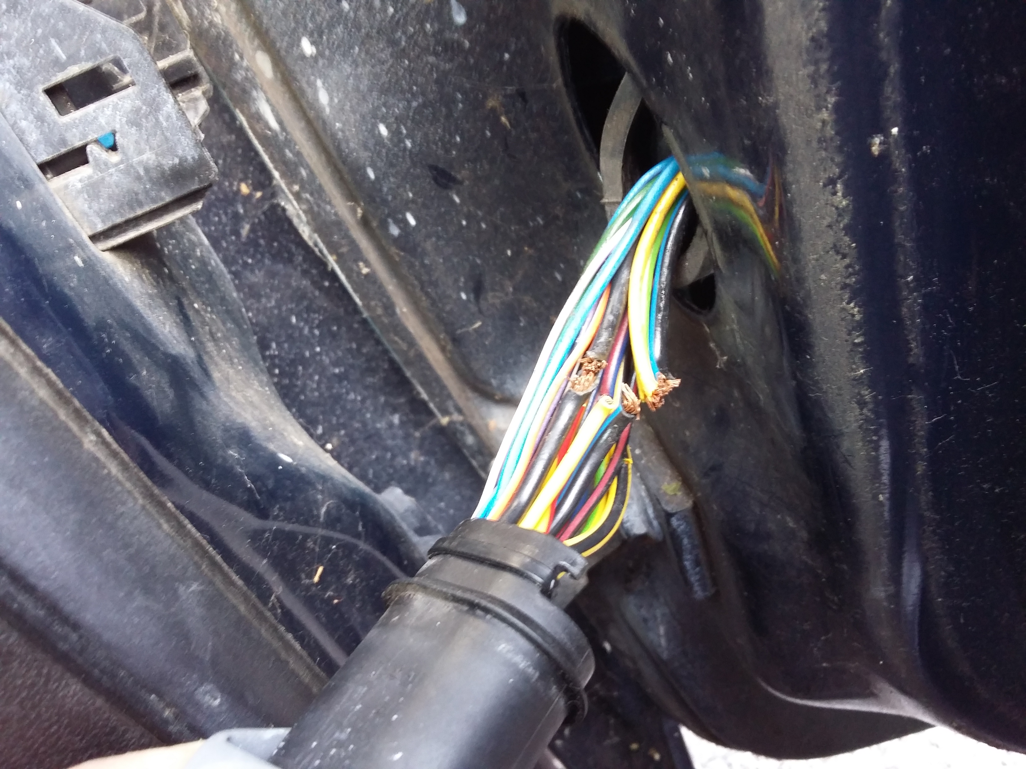

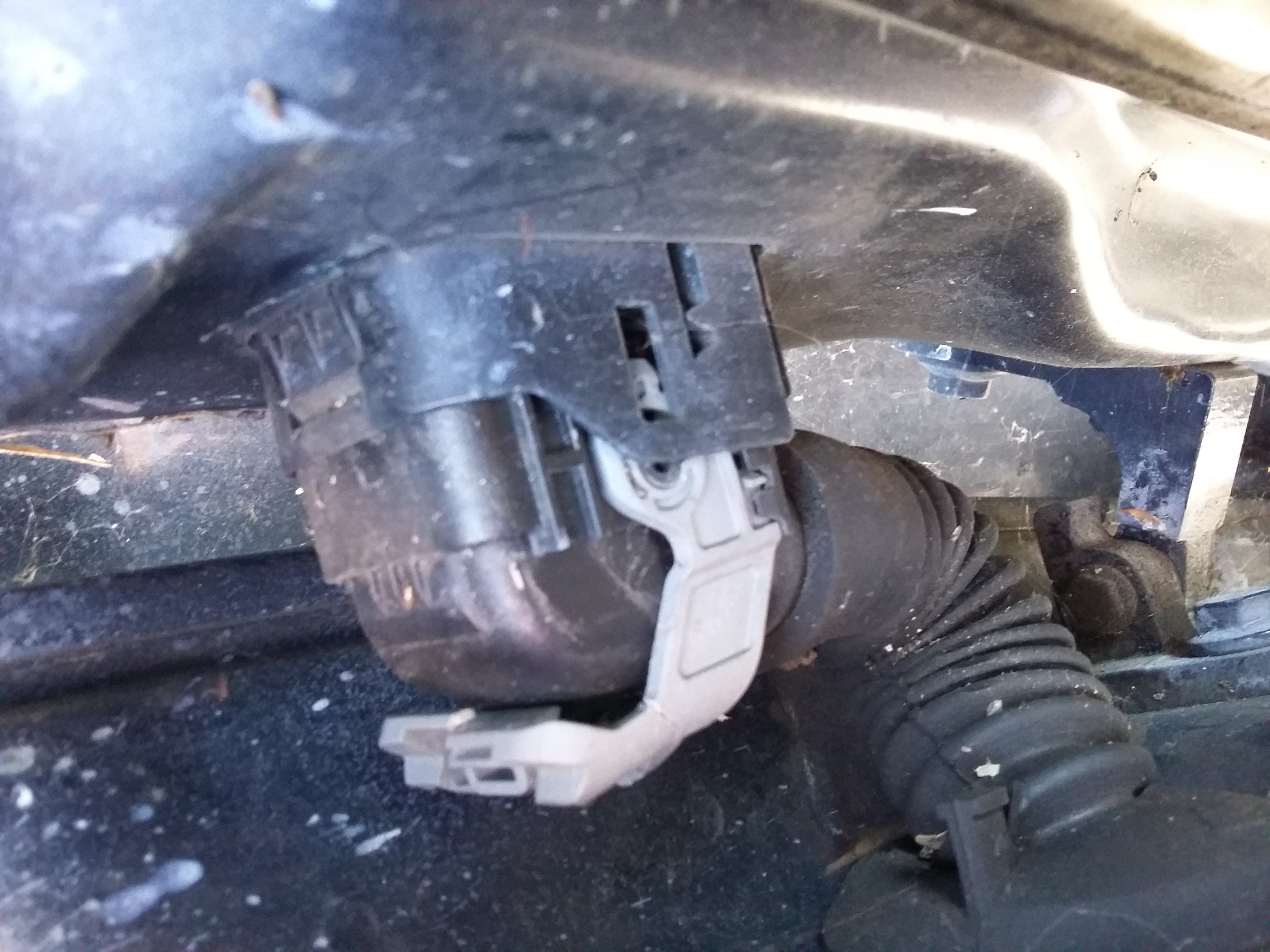

Hi
Its not uncommon for the wiring at the door hinge to fail :(
My windows failed through broken wires.. no fuses blew
Unplug the big chunky connector..
(The Grey plastic arm moves a gear..to undo the plug.)
Then peel back rubber sleeve
Pics here
