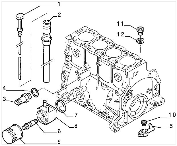

Gi day Fellas,
Got a problem with above, it's sprung a leak, just a tiny pin hole, to explain:
It's Part # gooo9611931980, it goes between the Oil Filter and the Engine Block
I've got the new part, my question is How does the thing fit to the block?:doh:
Is there something that attaches it to the block? (I notice that the Oil Filter is Female so is the hole in the heat exchanger (?) Is there something that screws into the thing, (Havn't disensembled yet still quacking in my shoes!!!)
Any help gratefully received:worship:
There's a hollow stud that holds the heat exchanger to the block and provides a male thread for the oil filter to screw on to.
Cheers Davron! Yuo are a Star!!
just the info I needed, Many thanks!
Just an update, the hollow shaft has a hexagonal a little way down , this, unscrewed allows you to remove the heat exchanger, hope this helps future fellas with the same problems.(y)
